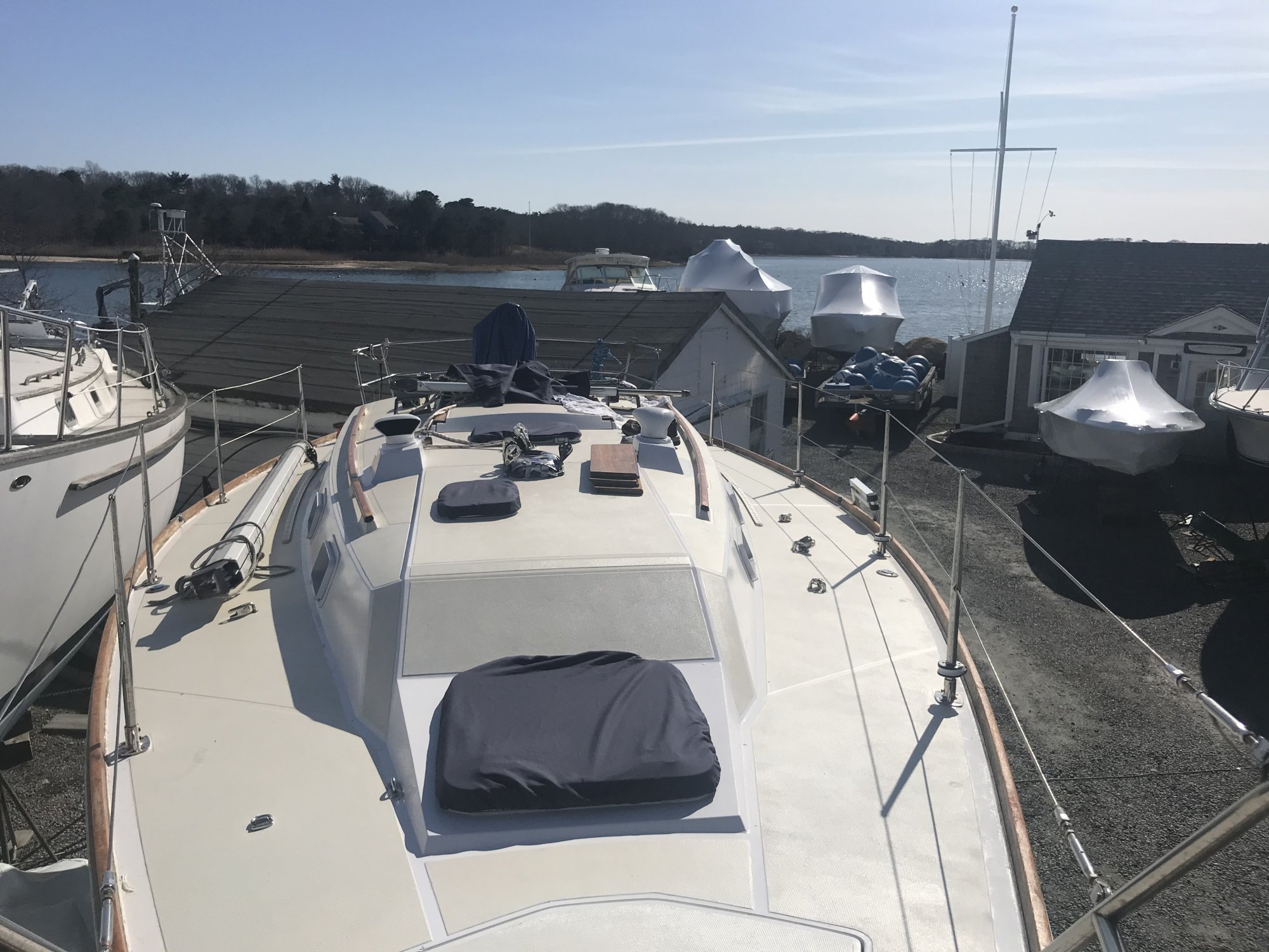

I am refurbishing a Cal-21 that has molded non-skid decking in diamond pattern. I’d like to paint over it with Total Boat Total Tread non-skid paint. Can I do that? And if so what prep-work should I do? I heard some people have sanded the molded non skid right down. Thanks

No need to sand out nonskid diamond pattern. I cleaned nonskid, wiped surface with acetone, then laid 2 coats of Total boat nonskid. Here is result. The diamond pattern won't be as pronounced when painted, however, will have more nonskid properties inherent to the paint. Good luck.

Thanks so much looks great. That’s what I was hoping for!

Easy job..although a bit time consuming. I mixed Total Boat nonskid 2 parts white, 1 part sand/beige. Post painting, Woody Wax worked great to prevent nonskid getting dirt ground in, actually good product for any nonskid. Have fun.

I was considering just using the white but I see plenty of people use the off white or beige and I’m just afraid I won’t like the 2-tone effect on the deck
