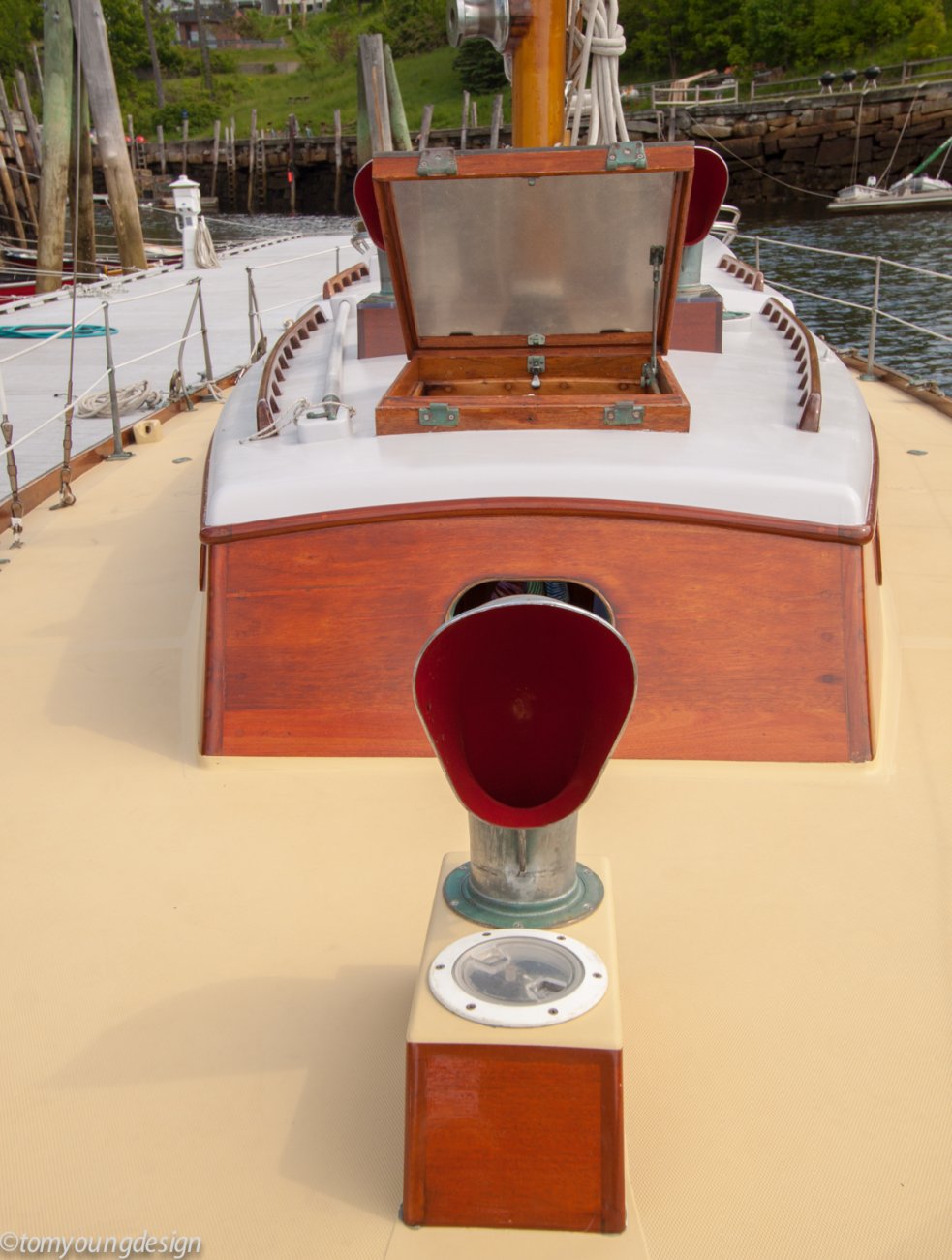

If the non skid pattern is good (still grips), you don't have to sand it down to paint it. Give the non-skid a good cleaning with bristle brushes and something like TSP that will remove everything. A light sanding of the margins might be needed. For two part, the directions will tell you what they require.
I've painted my non skid decks that are 50+ years old and the grip is still good. One part Acrylic enamel from Valspar.

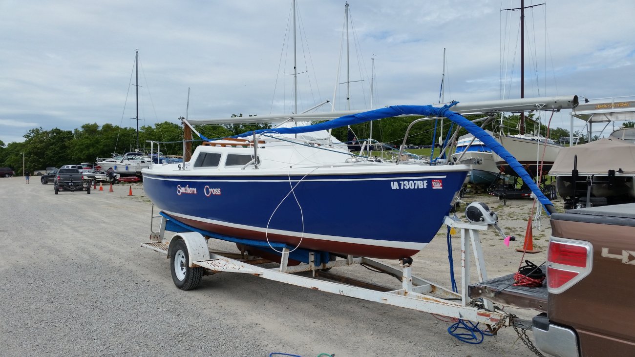

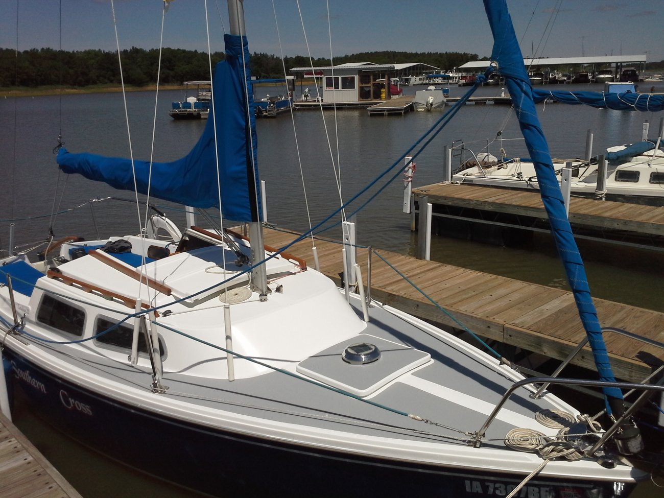

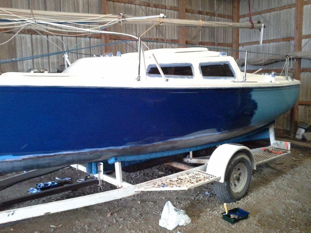

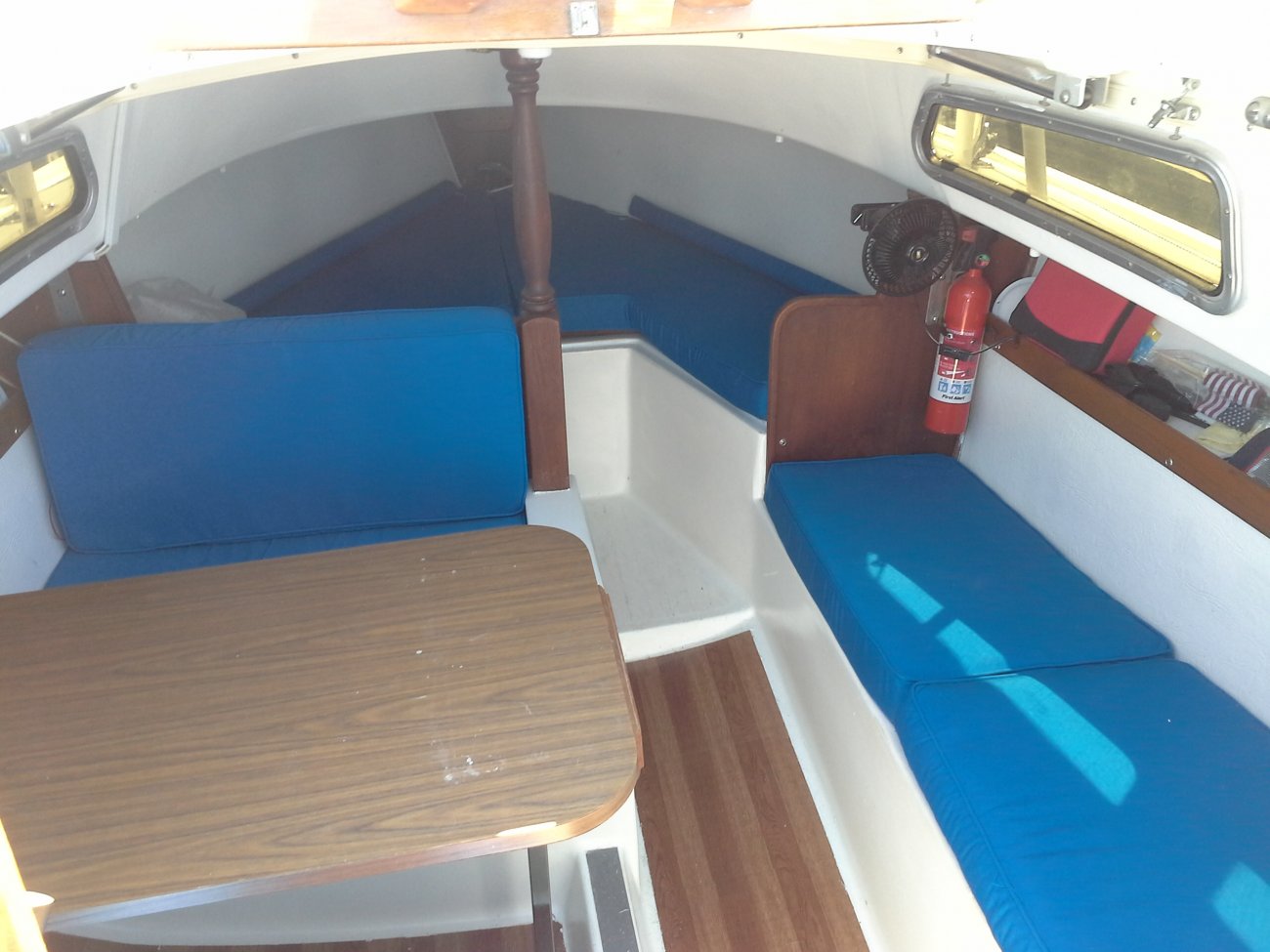

I used Interlux Brightside also. Original colour (beige) was tired and the PO's name (Annie B) had no connection to us so major upgrade inside and out (incl new cushion covers) to coincide with the renaming (Southern Cross). Much sanding to get the hull and topsides smoothed down. 3 coats of primer, with a tinting of the final coat to add depth (the previous colour was a beige and I wanted a nice depth to the royal blue so added just enough to tint the primer to a mid colour). I think this worked well. I used rollers then tipped with a fine brush (not cheap, worth the investment). I had considered spraying but did not rate my skills highly enough at that time. Might reconsider if i ever do that again. Go onto the Interlux website. they have some great resource materials to download on painting tips, paint selection (using Interlux products of course !)
For the topsides I again used Interlux product. It is nice to work with and their non-skid deck paint is much better (IMO) than adding sand or other additives. I like Kiwi Grip as well (since the name is of my homeland) but ended up this last time going with Interlux throughout (interior also). I like the contrast of the white Brightside margins with the non-slip in grey. It took a lot of masking and trimming to get the radius and so forth around fittings but end result is very rewarding. We love the brightened appearance while retaining some classical C-22 lines. Best of luck.
