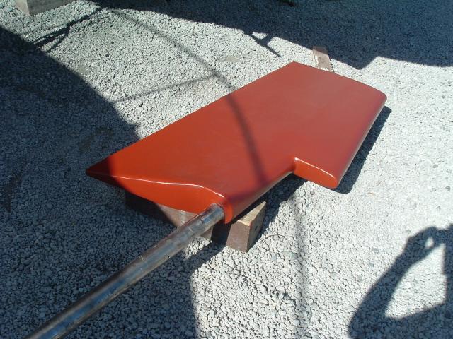

Jun 2, 2004
5,802
Would always want the rudder to match the bottom. Used to be black when I was using modified-epoxy then red when I switched to ablative. I guess if I worried about it I would just cover it through the winter. But I don't.
