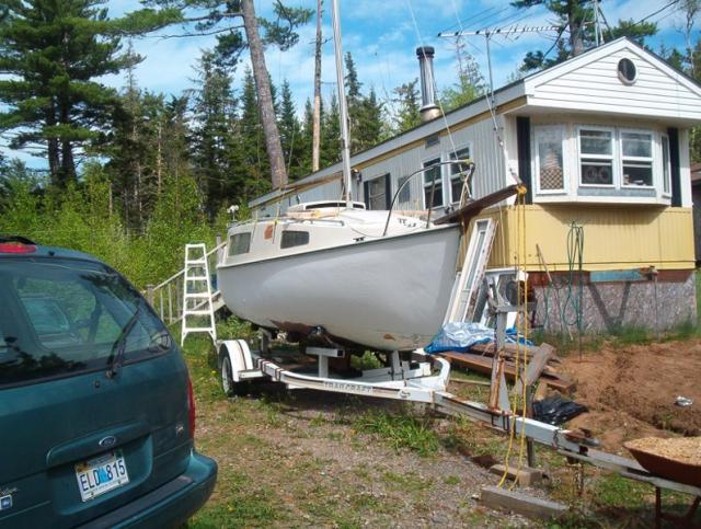

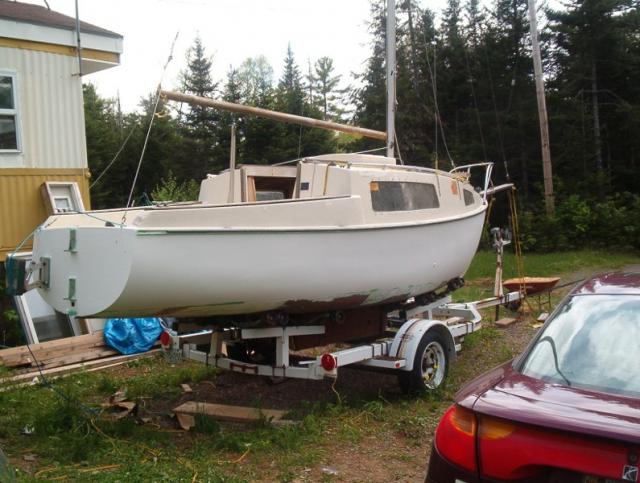

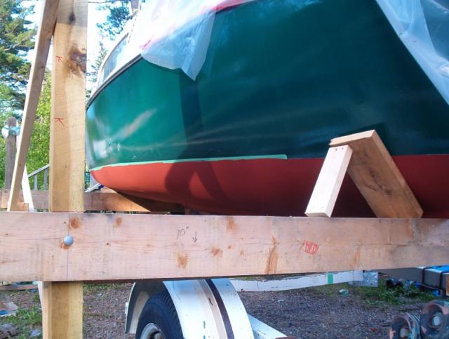

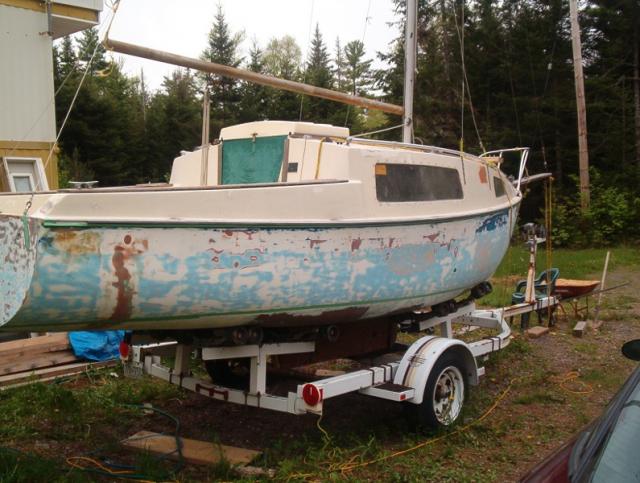

After much delay due to weather I've finally gotten the painting started. I'll be doing the waterline to gunwhales first then the fore and aft sections of the bottom complete then get her onto a cradle to finish the bottom off.
The weather was good today so got both primer coats on today and hope to have the Brightside finished by Wed night if the weather holds out. Then 3 days doing fore and aft epoxy primer and 2 days for the hard anti fouling fore and aft before getting her onto a cradle to finish off the bottom.

Me too! I've been waiting for the weather to break. I finally gulped and painted yesterday. It was overcast, chance of fog and slight chance of rain. It looks pretty good but I'm not completely satisfied. Next time I'll spray, for sure. Be sure to try the stuff on a piece of glass first and wait a few minutes. Thin a little at a time to get the finish that you are looking for. THEN, start at the stern, where the sun don't shine until you get the timing down. We found that with me putting a THIN coat on with a foam roller, and my lovely bride following two steps behind (as it SHOULD be ;>) ) we could get t pretty good finish. Good luck and keep the pics coming!

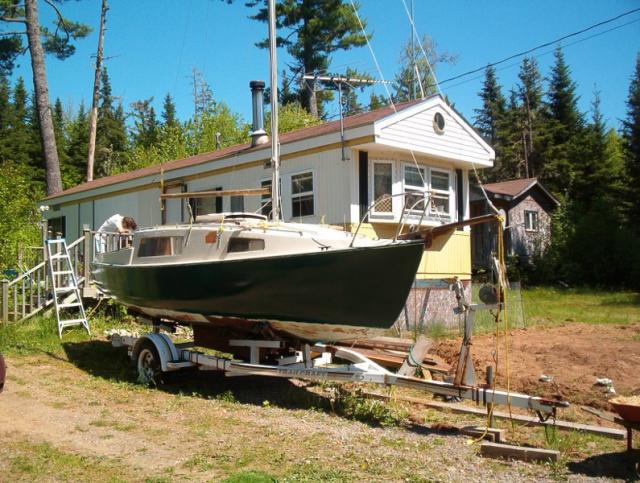

Hiee guys,
Thanx for the kind words. I'm not totally happy with the results and I may have to do a bit more filler work but its turning out much better then what I had anticipated. There is simply no way to roller this on and have it look sprayed though. We're cruiser and not racers so I think it shall be quite all right in the end. After all it is a 26 year old boat and was in pretty bad shape when we got her. If I don't get her in the water and enjoy some sailing this season I'll be most annoyed with myself.

Thanx,

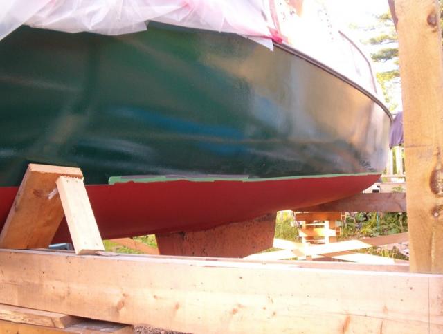

Actually I discovered that foam rollers were NOT the way for me to go. They left tiny bubbles in the finish after the first coat which this morning I spent a fair amount of time trying to remove most of. I then went and got myself some 1/4'' nap fuzzies which worked out very well. It has left a matte finish which I am happy with. 1 maybe 2 more coats to go :).

That is Sasha on the deck and she said the same thing lol. From all that I've read its all but impossible to roll with out getting orange peel. Even with tipping by brush. I tried it a bit yesterday,but it was quite warm and the paint skimmed so fast that I could only roll out a 2 foot width and then had to tip it off in order to make it work. With that there was to much of an issue of getting to heavy of a coat on. I find that if I roll out a 3 foot vertical width and then very gently start at the start edge and lightly bring the roller down to the waterline that and paint seams are removed as well as the majority of bubble, at least with the fuzzies. With the foamies nothing I did seemed to get rid of the bubbles. Like you say the only way to get a sprayed look is to actually spray it lol. BTW I'm finding that its taking me about 3/4 or a quart for each coat for this 22 footer. So 3 quarts will give me 4 coats total. I have a gallon of the white semi gloss I bought for the ext cabin and decks so it looks like I might have enough to do the inside as well :).
