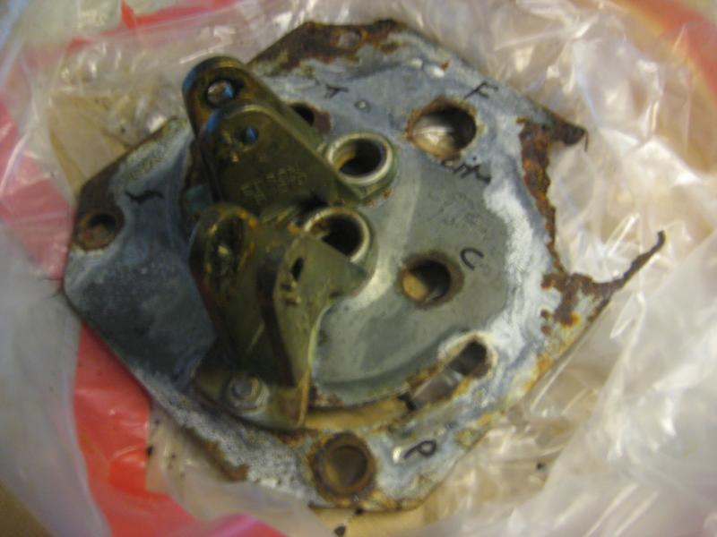

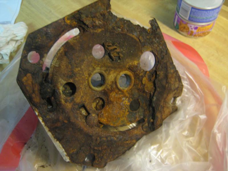

Thank you all for all the great info. Looks like the pedestal is already mostly ready to remove. It took 2 hrs to disconnect the cables and wires to get the under deck base support off. I can get the pedestal off but leave the rail on so I don't have to thread all the cables thru the rail again. If I can find the time to remove the shaft sprocket etc to release the top ends of the cables I can take it to be powder coated.
The pics are of the base support after removal. I knew one corner was corroded but had no idea how bad it really was.
