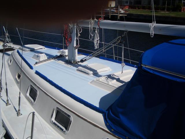

Added picture to album of cabin top after I finished painting it. After doing all the usual prep, painted 1 coat of Interlux Pre-Kote, then 1 coat of Interlux Brightside (3 part white to 1 part light blue) with Interlux No-Skid added. It looked horrible. Painted 3rd coat of Interlux (3 part white to 1 part light blue) without the no-skid. It looks great. What a job. Now have to finish the side decks.
