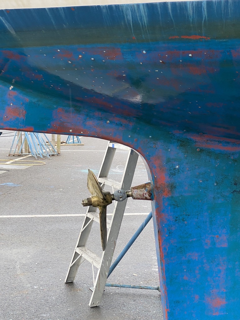

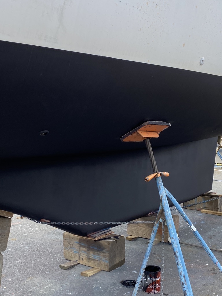

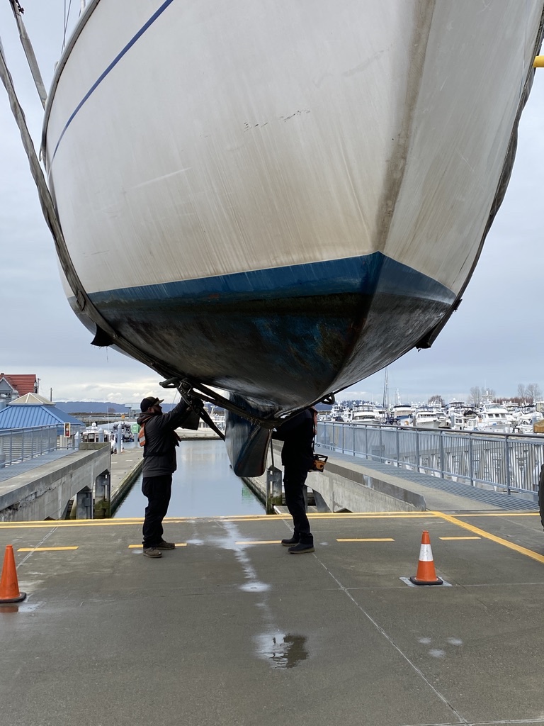

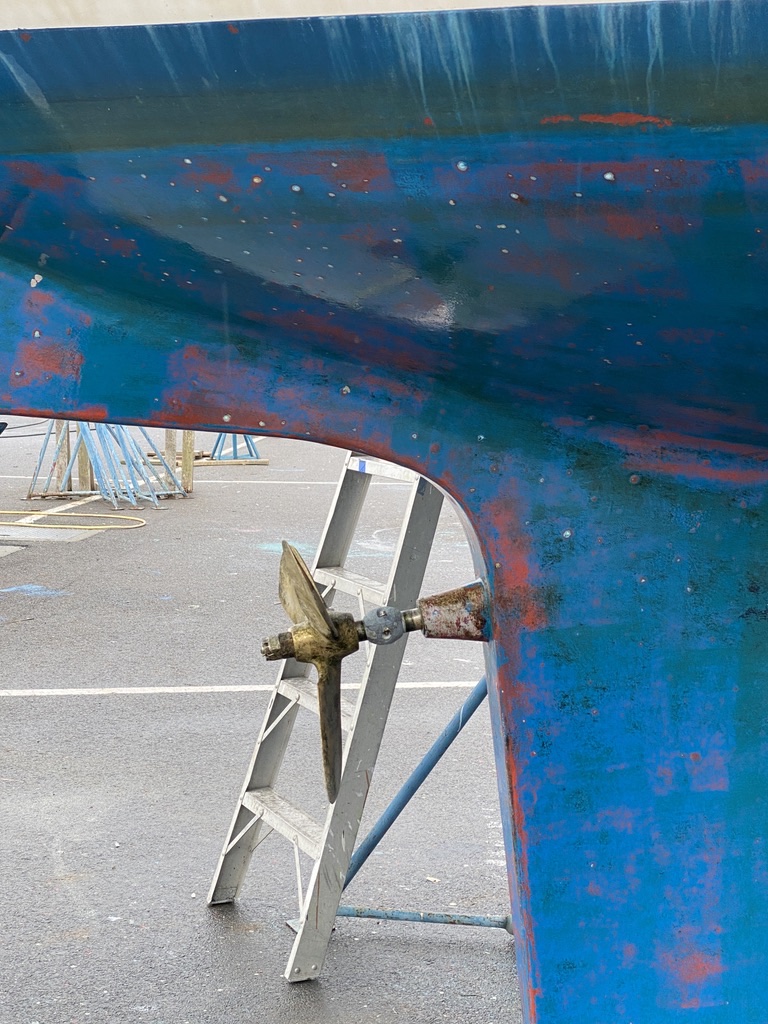

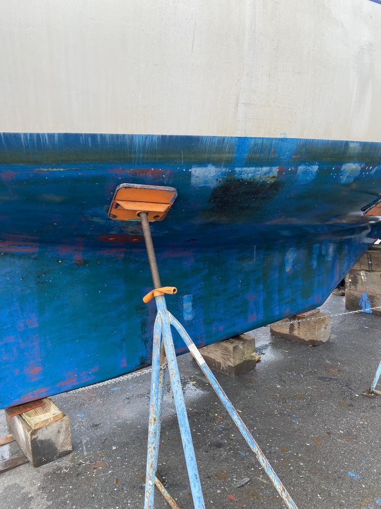

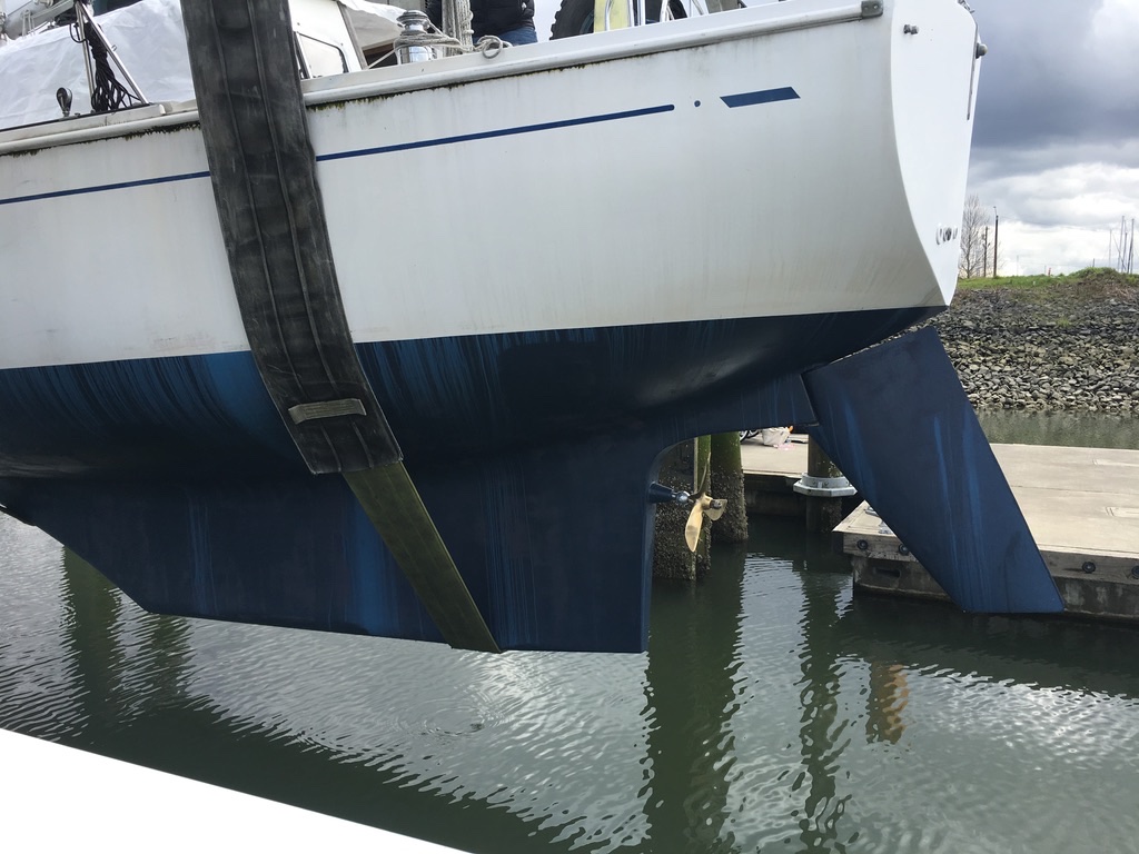

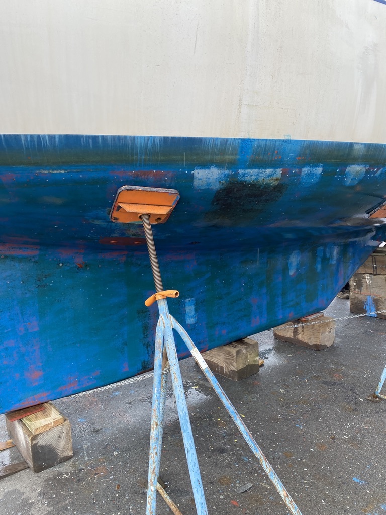

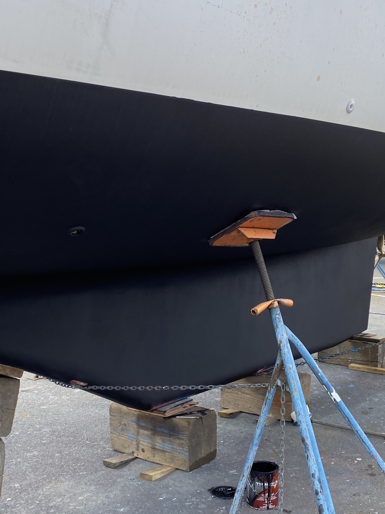

I applied two coats across the hull and a third coat on the leading edges of the Rudder, Bow, Keel, and bottom of the keel. When I hauled the boat, the paint still covered the hull, but the leading edges showed wear.
Launch March 2018
At haul-out Feb 2023.
After Pressure Washing. Current Hull paint is Blue. The previous layer was Red
New Paint Job. Black like the whales.

That looks great....I long to be at the point of a completed painted hull!! :)

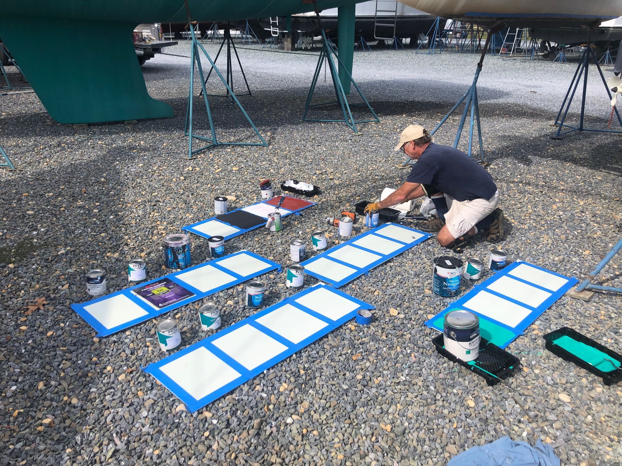

At least in this test, Krypton was better. (I tested 30 paints for Practical Sailor, 2 years plus, panels and on boat.)
I'm now using Krypton on my personal boat. Based on the last two years, I'll probably be using it again.
