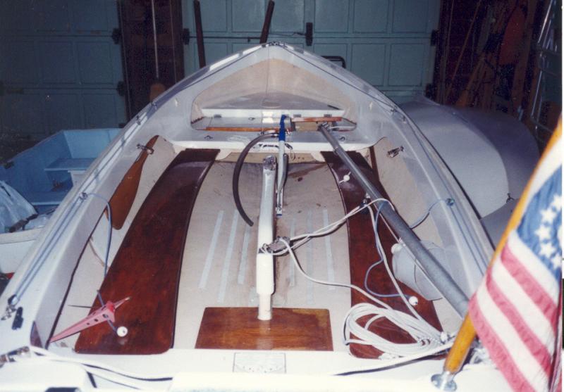

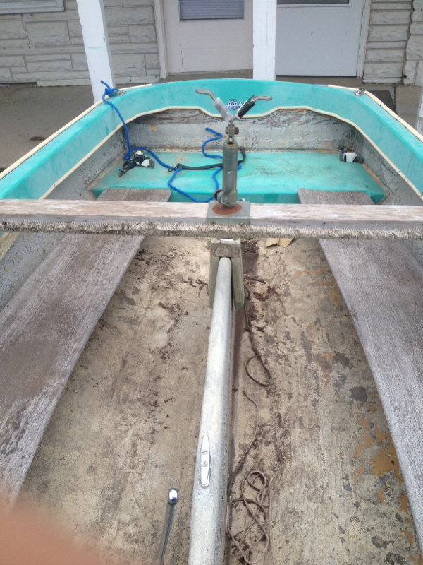

Well, I'm not sure about Widgeons, but I'm guessing that's mahogany under the paint. Although I learned everything from my Grandfather, and I do most boat things thinking of him, kinda in tribute, we did have a major disagreement. He always liked red stained mahogany, whereas I like natural mahogany - under sufficient marine varnish, of course. So, I don't believe in stain on boats.
