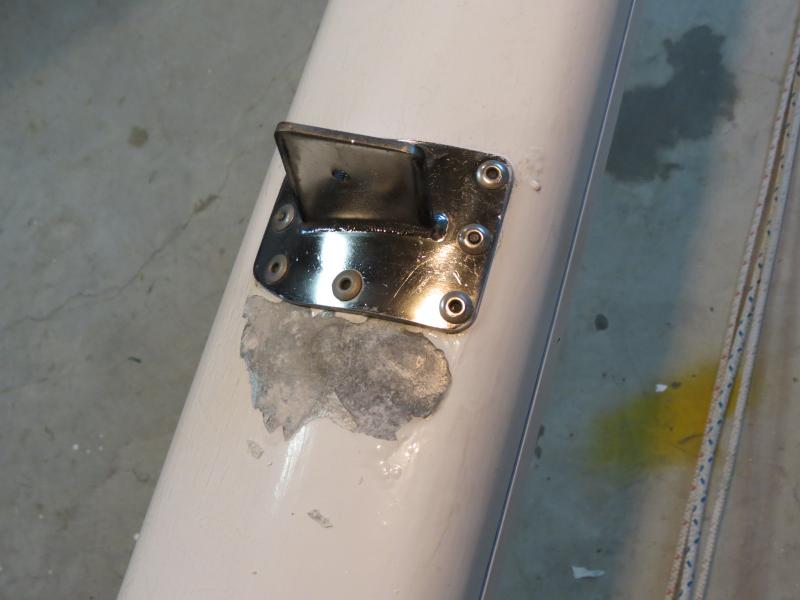

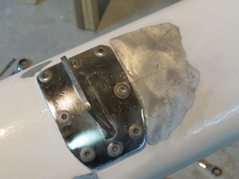

I was a little dismayed when I took my mast down this year and discovered some corrosion under the port spreader. With the difficulty of removing SS rivets, I didn't remove SS components that were on the mast such as this spreader ear. However, other than this area, I had no other locations that were troublesome. This is 6 years after painting the mast with 2-part primer and 2-part Interlux Perfection. My first step was the Interlux 353 Prime Wash Base (self-etching primer).

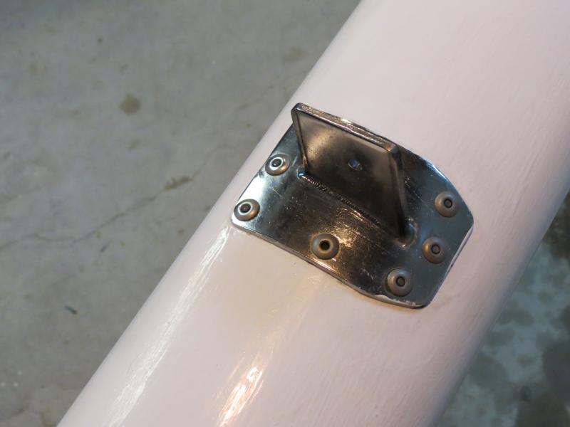

The Stbd side had no problems at the same location. I'm wondering if I missed that spot with the Prime Wash, or if it had more to do with SS contact to aluminum.
BTW, I've tried to drill out these rivets and I'm not getting anywhere.
I've decided to do a small temporary repair this year and a longer term solution if I see it come back too readily.
