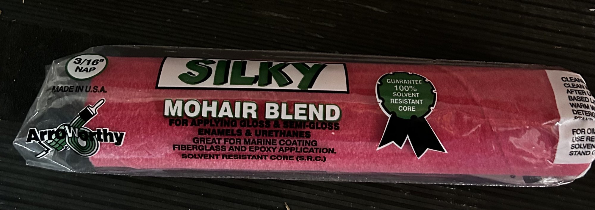

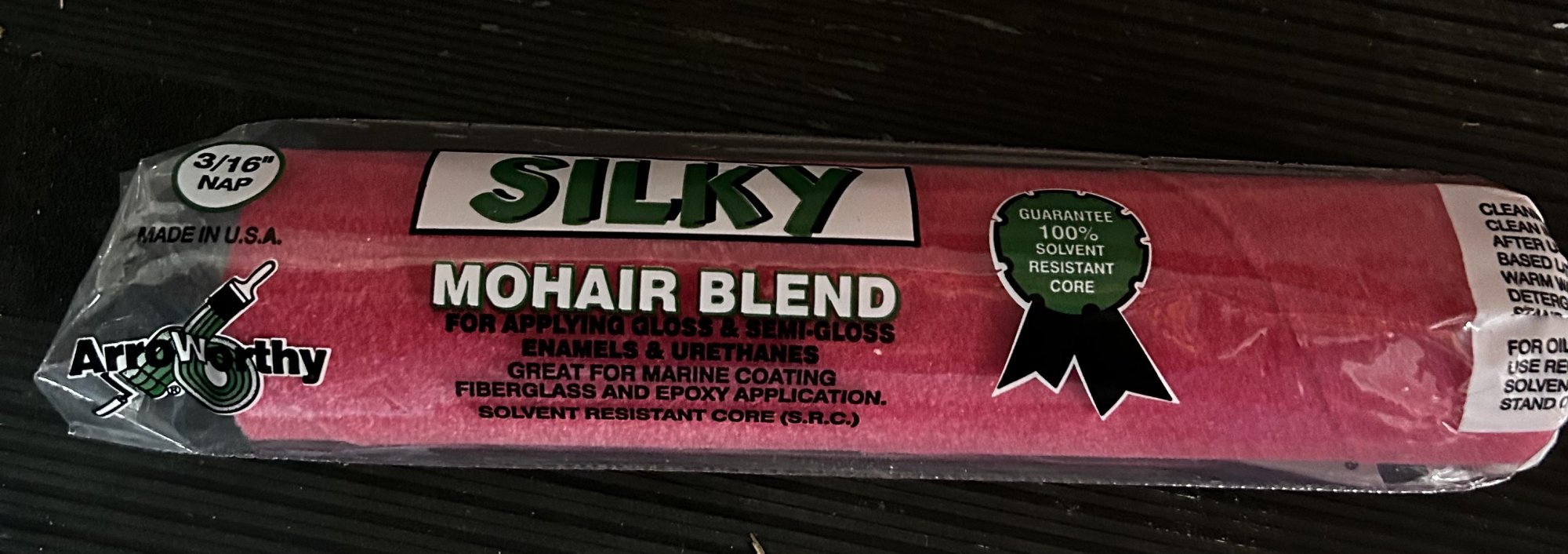

I get mine from Defender most years, as long as the shipping is bundled with the paint shipment. They now have free shipping on orders over $99, so that’s reasonable. Before then they wanted to charge to ship the roller separately ($15 shipping for a $7 roller), so that was prohibitively silly.
This is what I used - ArroWorthy Mohair Blend Roller Cover - 9PBM . Though like I said it was noticeably linty. A wrap with tape beforehand may have helped.

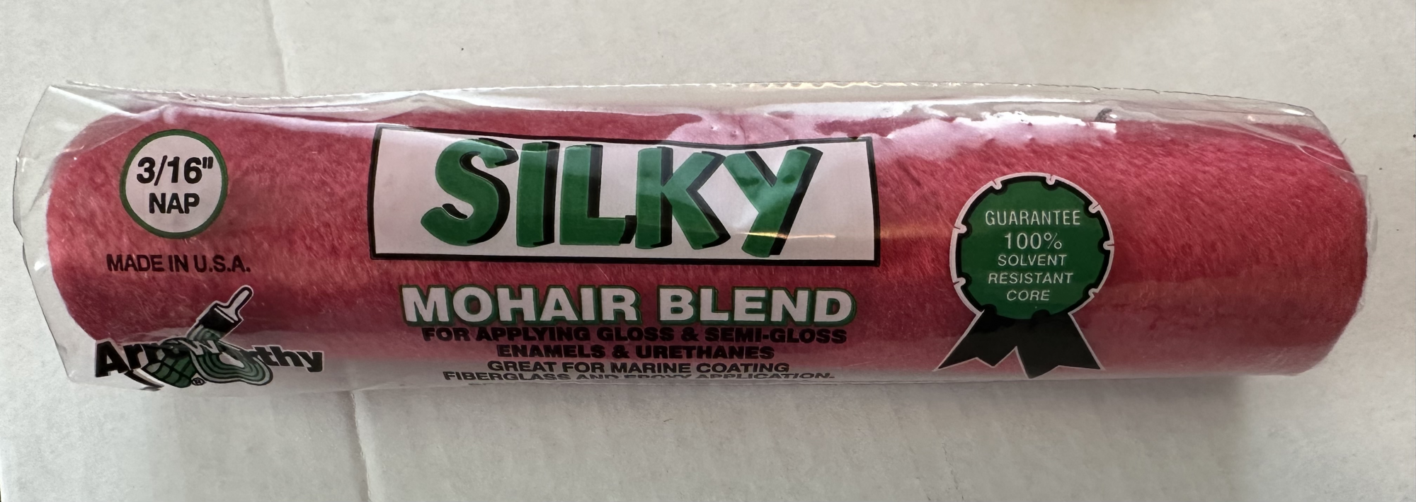

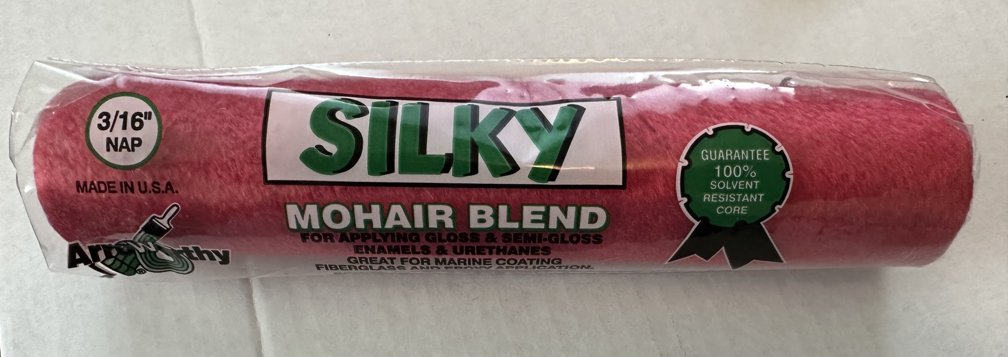

Finally was able to get the recommended paint roller cover you all have suggested. I just gave up trying to locate the 3/16 inch nap cover. I really was willing to pay the $7 - $11 + a piece, just to be able to stop trying apply bottom paint by not rolling a stick along the bottom, as other rollers act like.
Then, out of the blue, Defender Marine has them for $4.99! Free shipping over $100 and $5 under that.
I got a 4 year supply.
Can’t wait for next season painting! If you need them, check them out.IMG_1610.jpeg
