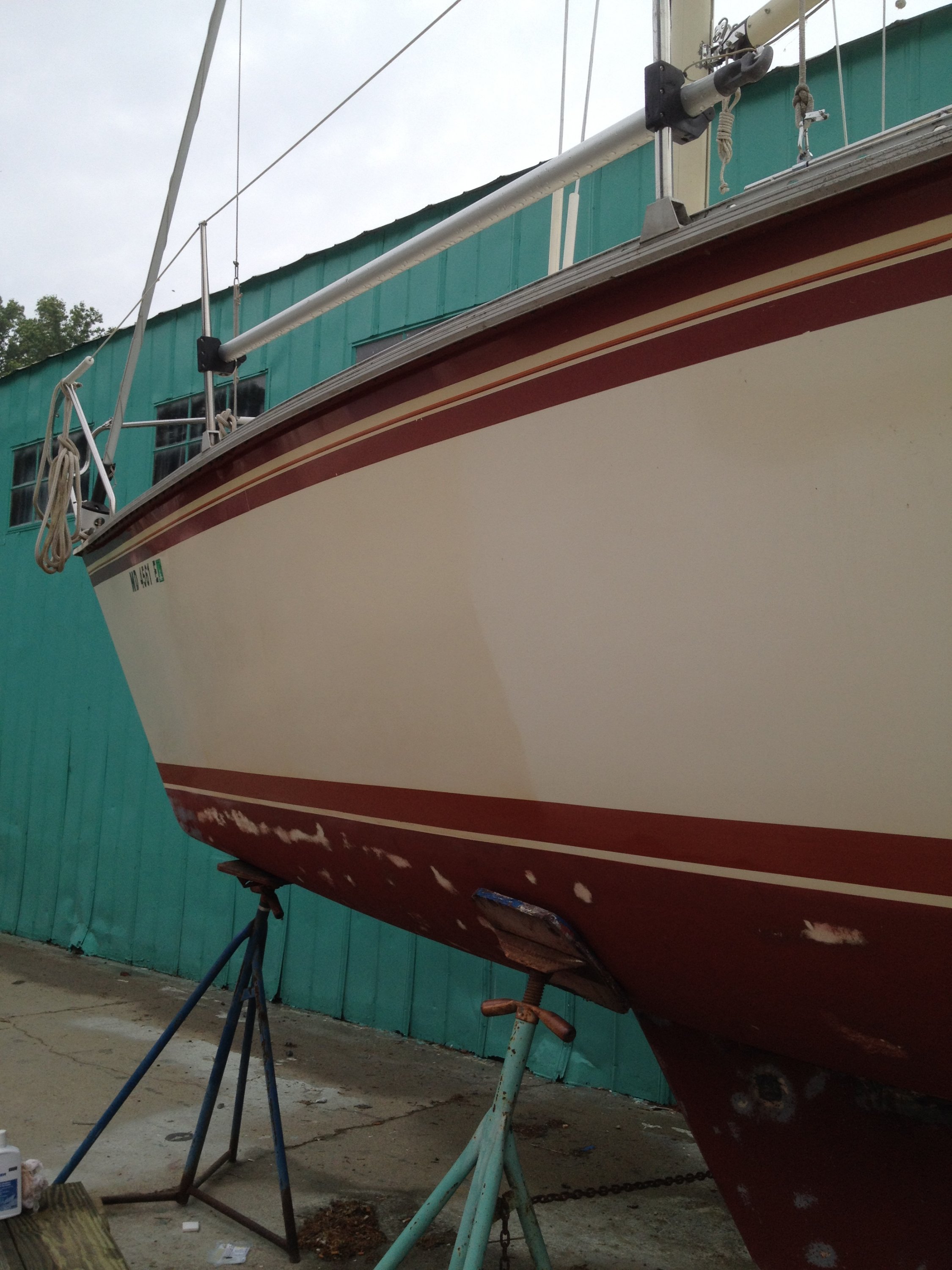

I recommend you not paint the Freeboard unless you use Awlgrip products and do all the prep work according to their instructions. Expensive way to go, but incredibly beautiful when finished. My boat is an 84 and this year while it was out of the water to bottom paint, I took the time to wash down the sides, clean of all wax and any buildup. I then used 3M products and a buffer tool. First I compounded the boat to remove all marks and created an evenly clean surface. I then used 3M cleaner wax, a 2'x2' section at a time, keeping it moist with a spray bottle with distilled water while I worked it. Then towel dried and polished buffed with a lambswool mop on the buffer. Finally when I was happy with the outcome, I used 3M paste wax, applied with a terry cloth pad and then buffed that out with a clean lambswool buffer mop. Came out so nice. Look at the picture and see the difference on the Freeboard. The darker area is where the cleaner wax product was used, bringing out the deep cream color. I tried the same application method using Collinite products. Was not so impressed.

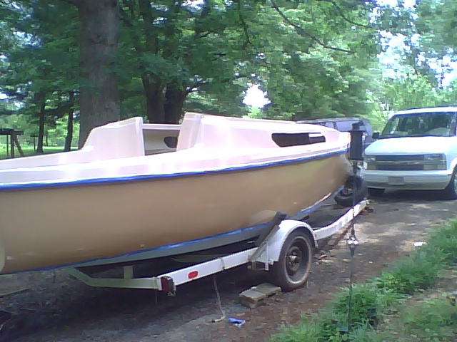

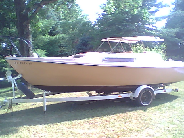

This was done roll and tip with a very expensive marine urethane. I sold it two seasons after these shots were taken and she was still looking great. I have also had okay results using oil based rustoleum (roll & tip). The brown bottom in these pics is rustoleum. I like to rustoleum on the bottom because I beach a lot and scratch up my bottom. I can always find a good color match, even years later, with rustoleum. The biggest part of the process is not what paint you use but the prep work. You will need to strip off all of the wax BEFORE YOU SAND... and then fill in gouges and scratches... and then SAND... and then clean again. Then make sure you paint on a day that has the recommended temperature and humidity.
