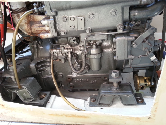

The last set I did, I had the little Yanmar out anyway, so of COURSE all the liners, pans, beds, whatever were cleaned and painted. (If someone wanted me to drop an engine back in a 'greasy hole', they've hired the wrong guy to begin with). And while I generally leave these tasks to the owner, there haven't been but a couple that were actually willing to pay my rate to clean an engine sump, the mounts in my opinion ARE my problem. Anyway, they looked fine structurally, so I throw 'em in the glass cabinet and take it all off. You could stand there and hold the nozzle on the rubber all day long and it won't hurt them, it's rubber, and merely bounces the glass/sand back off. Primed them and painted them with the same Yanmar paint that originally goes on the block. The paint obviously is not a give-away, it is after all MARINE paint, so it must be outrageous in price. (I just gagged a little there, sorry). But it looks like the day it was repowered. Beautiful. And if anybody else looks in there, they instantly know this is a tight ship, and not some neglected rust bucket. Which is exactly the opinion I form about the boat, AND its owner at a glance.

Rustoleum would work fine, as would most finer quality spray bombs. It may not prolong the life of the mount, but the reality is, it probably will. The factory mounts on most engines are painted. It would take eons for surface paint to corrupt rubber internally to failure. If that's a bother, tape the rubber. I just used the Yanmar paint because I had it anyway doing the rebuild, and it was the same color. It really doesn't matter as long as it's clean, and has a little decent paint on them. And I'll betcha five bucks that is exactly what your mechanic was advising you to do anyway. Besides, if the motor is out, or moved, new coupler/shaft whatever, you are going to need those threads clean anyway to align the motor back up. After it has settled, tape the area and shoot some of the same paint on the threads for the rust protection. Do you know why they are rusted? It is because they are CARBON STEEL in a marine environment, and it ALL rusts.
Which is why they are painted..

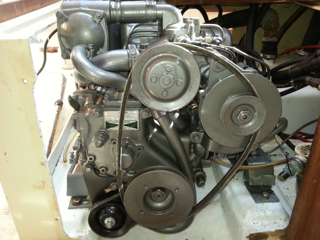

I took both starboard mounts out, clean up the rust then spray paint them black.
Rust was result of CW pump leaking sea water causing rust to some metal parts.
Rust on engine body, I brush it clean and spray with Metal Ash Grey (very similar to Yanmar colour). Good practise to keep engine & compartment dry and clean.

Clean
It's nice to have a clean motor so to see anything is wrong like anything leaking
but yes it's hard to keep moisture from creating some rust on the metal parts of the motor.
I had a salt water leak some time ago so taking the motor mounts off and cleaning them was just from them getting really bad and once rust comes it doesn't get any better.
If you have time to sail and keep your boat looking really nice than more power to you if not well hoping you are enjoying lots of sailing.
