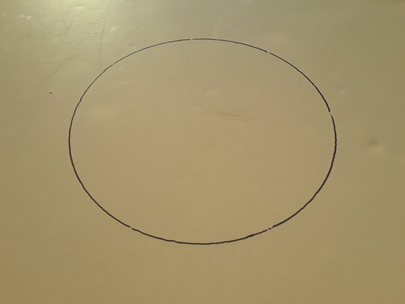

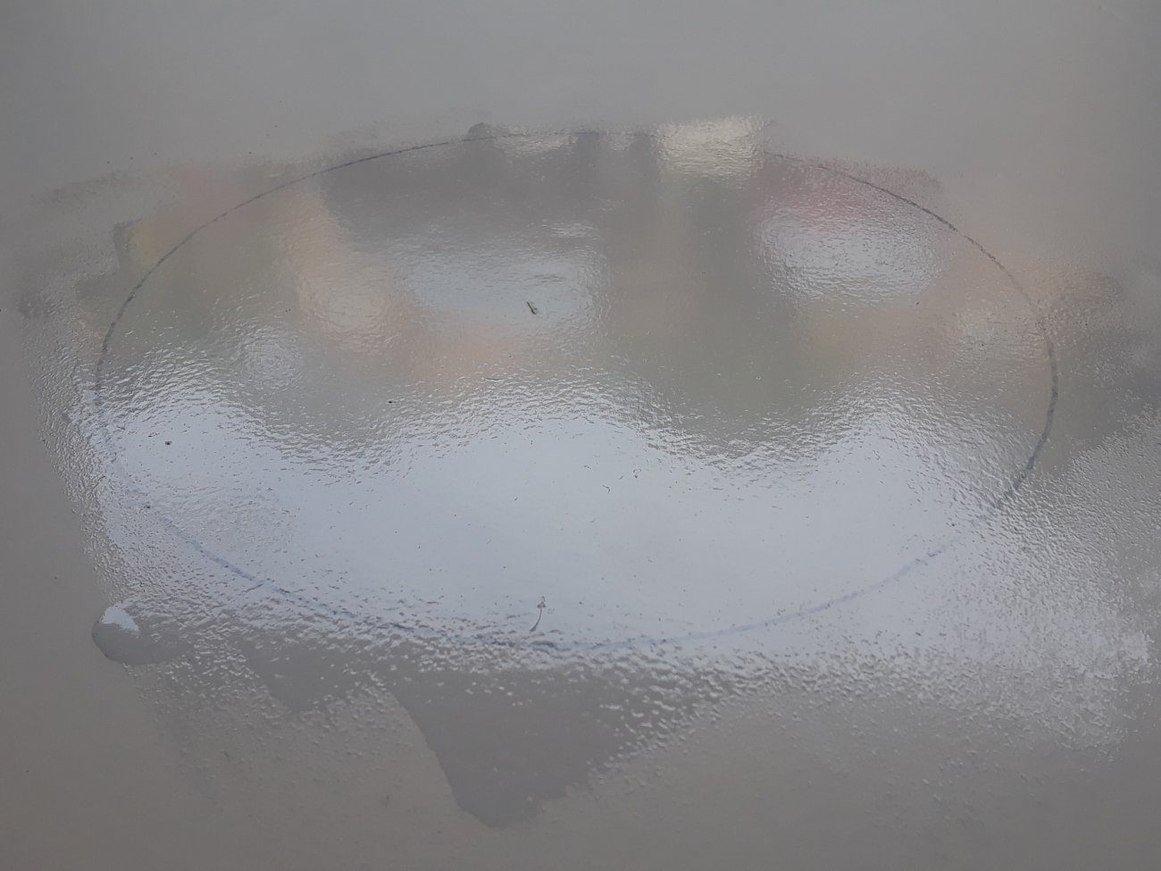

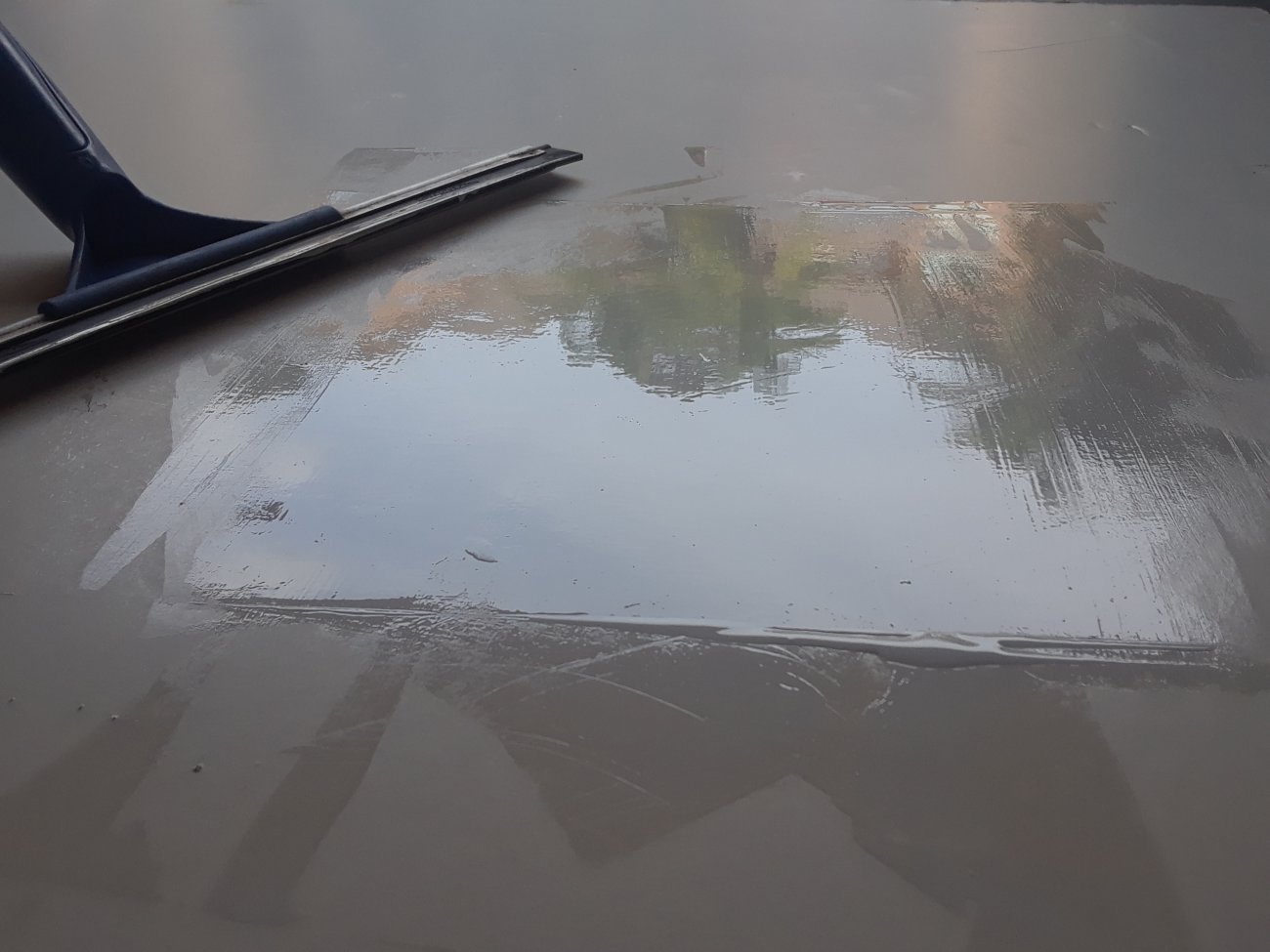

Heres a garage test. I rolled a surface with Rustoleum topside and let it sit overnight. The next day I roughed up the surface with 220 then drizzled more RT. Finally, spread the RT with a bathroom squeegee.
Its the same technique as some surfboard layup and hot coating. They use cheap chip brushes so they need to apply layers for sanding those out.
You would still need to sand afterwards, just nowhere near as much and as deep.
