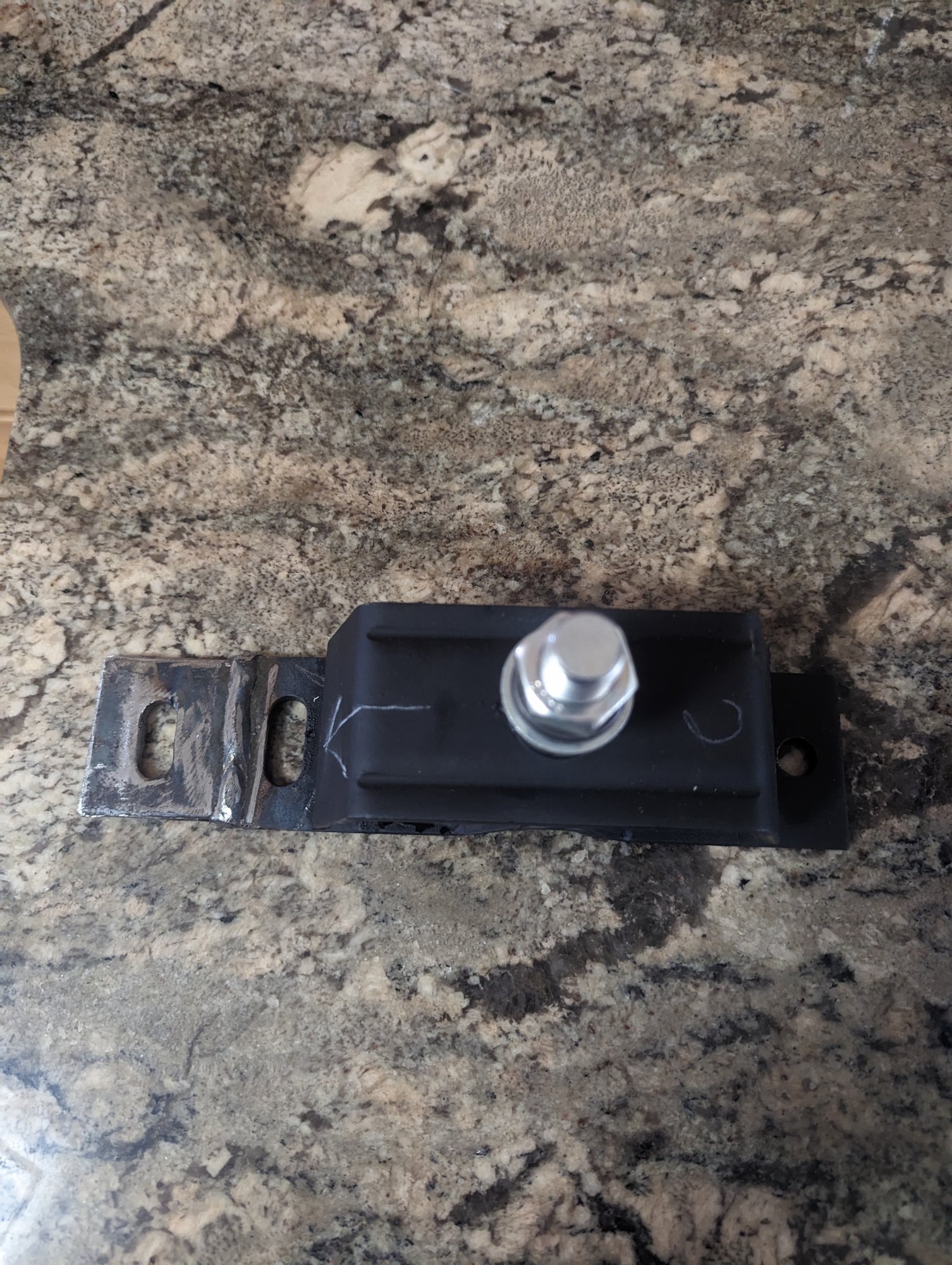

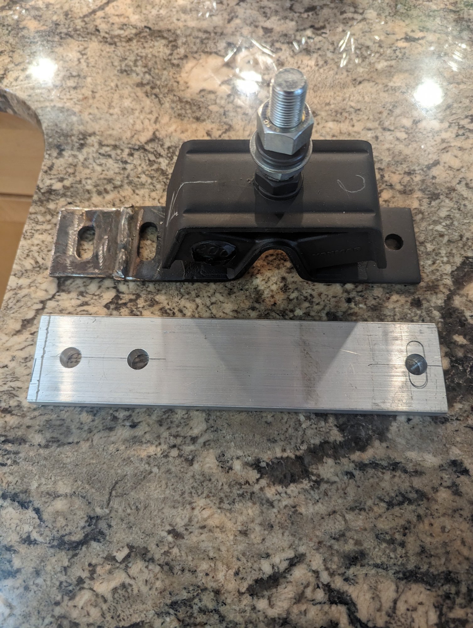

I had a lag screw shear off where the shoulder meets the thread in my motor mount. I have not been able to extract it out of the stringer. So this is my plan B. I welded an additional piece of metal onto my new motor mount and plan on driving a new lag screw into the stringer and abandoning what's left of the old one, sealing it in an epoxy tomb. I am replacing all 4 mounts and using new lag screws. Yanmar 4jh4e, 2005 in a 41 Hunter DS.
What paint would be best to protect this bare steel as well as the rest of the metal part of the new motor mount?

Excellent solution.
The only thing I might add at this point is that the stringer at this point is solid wood to accept he lag bolt. The new lag bolt is very close to the original lag bolt hole and I would be concerned about splitting the wood seeing as they will likely occupy he same section of wood grain between summer and winter growth. The only solution that comes to mind right now is to make the extension much longer. This shouldn't affect the ability to do an alignment as you do not want to twist the mount, just move it from side to side.
As far as paint goes, rough up the metal with ≈240 grit emery paper and primer and paint with epoxy paint if you want to go bat-:poop: crazy for corrosion prevention. If it were me, I'd use Rustoleum spray can products. But far more important than the paint, is to ensure there are no sea water leaks above the engine supports. I got caught with this problem about 10 years after I bought the boat new where I had a corrosion problem which was not in plain view. I replaced the one mount just out an abundance of caution and it seemed like an interesting project over the winter.

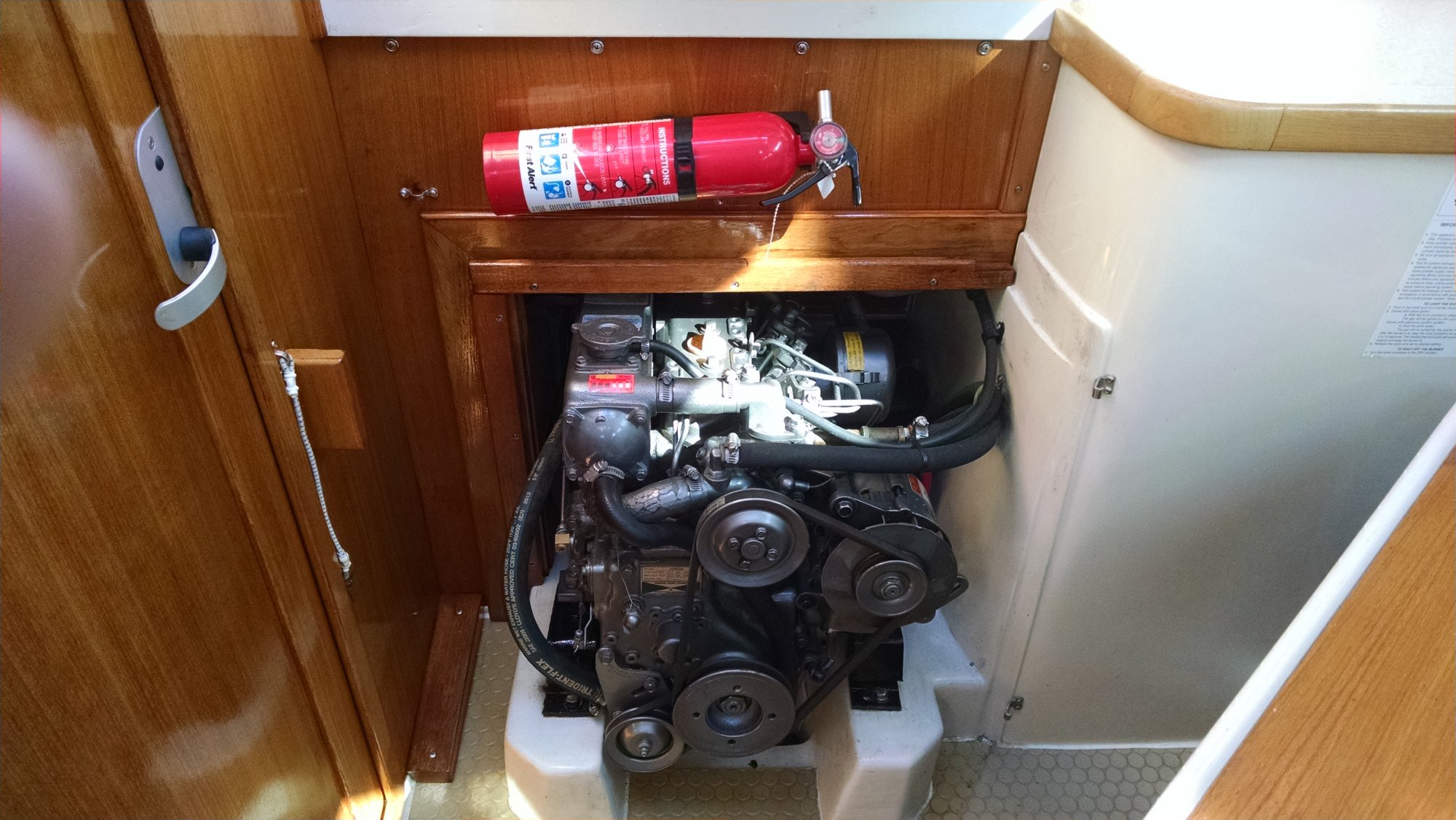

This is one of my three Yanmar 24 year old motor mounts in a picture taken recently:
Zero corrosion on all mounts.
Keeping it dry = 0 corrosion
