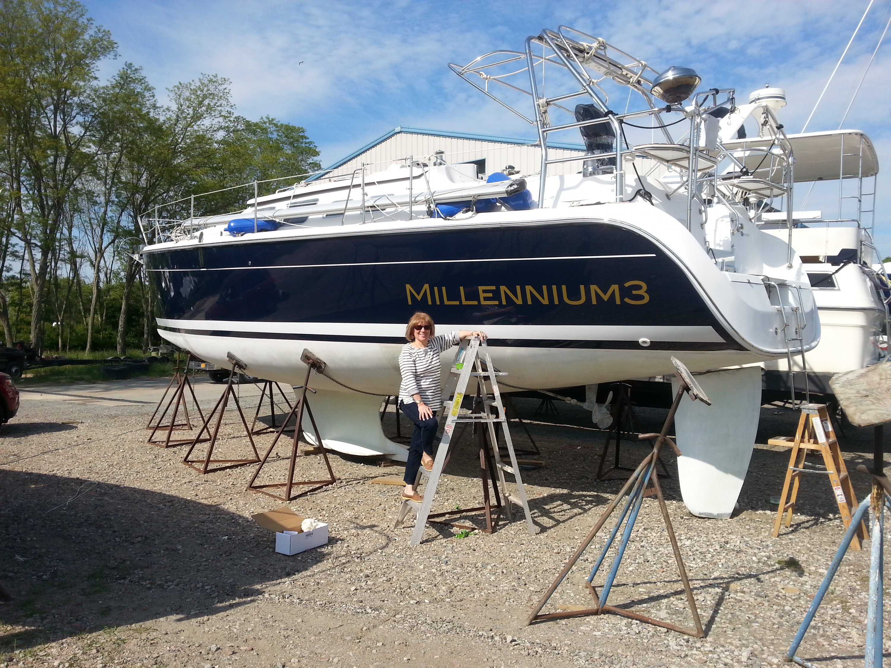

My 2007 41 DS was painted by Hunter but NOT at the factory. The work was subbed out to St. Augustine Marine Center. A few years ago I contacted them and they still had the original work papers. Turns out my boat was painted with Awlcraft 2000 in flag blue. My boat also had gotten some scrapes on both sides. I looked into having the boat "touched up", but ended up have the entire boat repainted as no one thought they could do this properly. ( I still have an unopened can of paint & other products needed) The boat was redone in Alexseal, and came out fantastic. Please see picture taken just after we installed name on boat.
