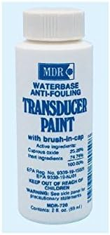

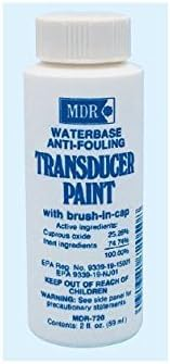

I paint my paddlewheel (the sensor is an Airmar DST800) with antifouling paint. Even so I need to pull the paddlewheel and clean it, or dive under the boat and spin it by hand a few times before it starts to work.

No magic. There are some really expensive anti-fouling paints that might work. Otherwise, it is pull and clean or pull and plug after each sail.

Thanks for all the suggestions! I'm going to try the transductor paint and see how that goes for the first effort.
