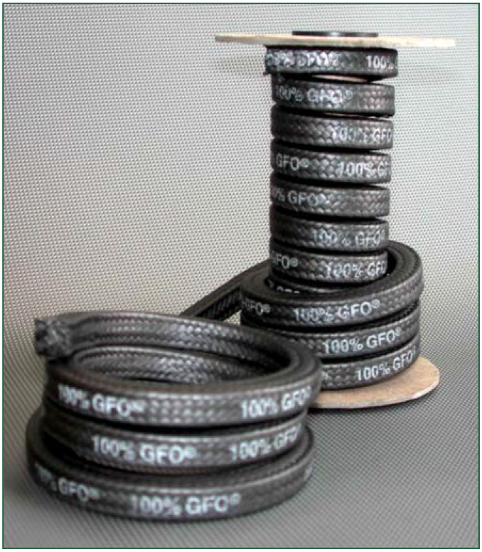

Here is the text from an email inquiry I made to Hunter customer service back in 2010 when I was looking for information on my 38. Ive since changed to a PSS dripless. Lots of opinions on that. But the packing was easy to do. I used the goretex material when I did it. Superior lubricity without requiring much water flow.

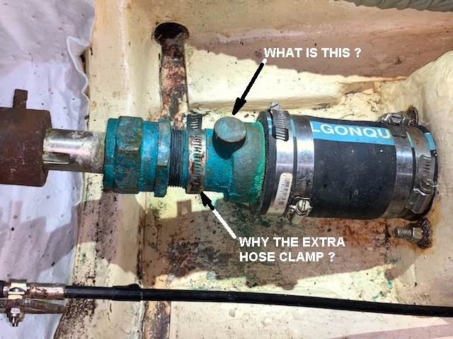

I always get uneasy when I see graphite used around other metals in the presence of salt water. ABYC is not fussy about it either.
Your shaft is most likely the same material as mine and of high quality. The shaft doesn't move all winter and yet has no problem with crevice corrosion. It's the bronze stuffing box I'd keep an eye on for corrosion.
Enquiring minds just have to ask the following:
1. What is the knob on the gland clamped to the log ?
2. Why the extra SS hose clamp on the gland ? It only seems to be promoting corrosion of the brass.

That isn’t an actual knob.
I see what you mean about the knob. Can't see any use for it so most likely a requirement in the original casting process.
The hose clamp you are referring to actually (securely) holds a splash guard in place
Yes, no, maybe. If you never do a stitch of maintenance on your boat and water from the gland flies everywhere, I suppose it's a good idea. IMO if you never do a stitch of maintenance, you shouldn't own a boat in the first place.
I think it far better to do the maintenance and avoid such contraptions.

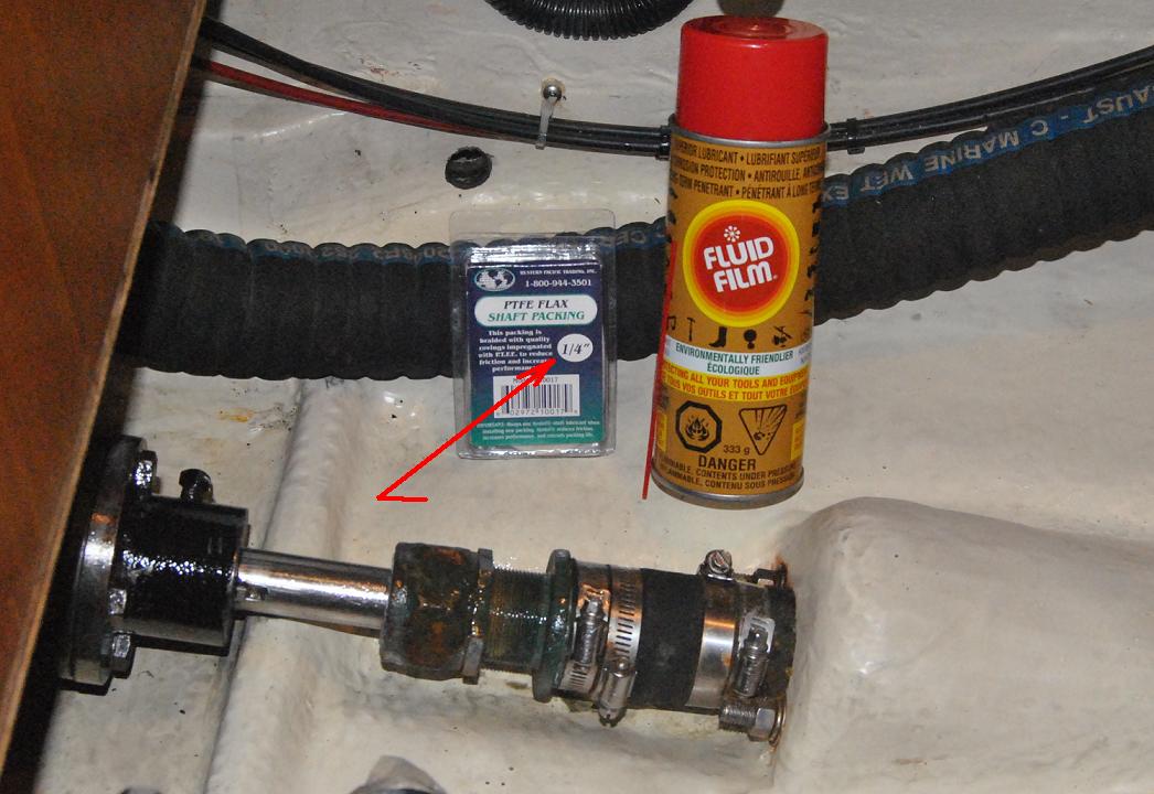

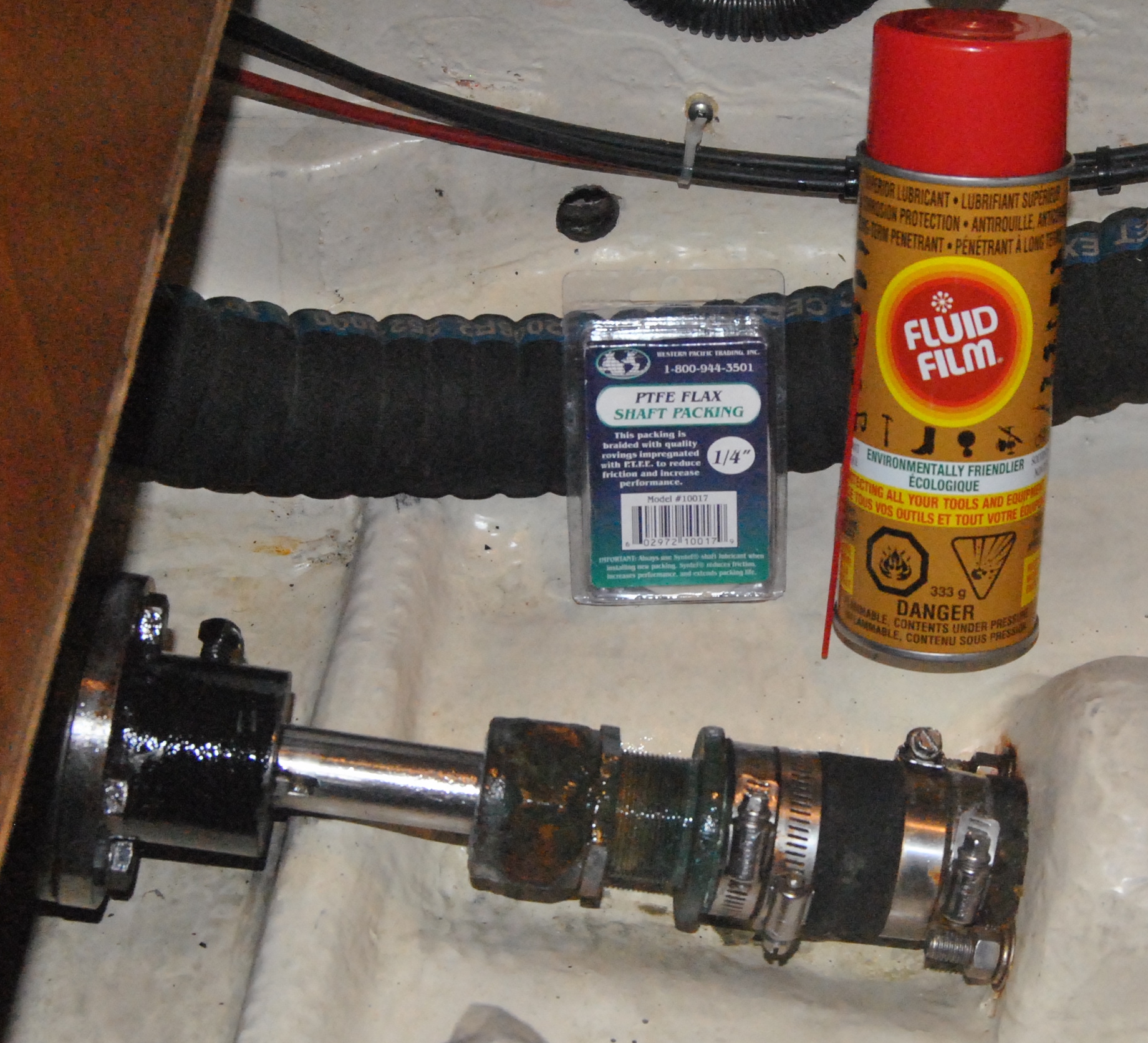

Start by snugging the gland until it JUST stops leaking and no more. After it's brushed as clean as it's going to get, wash it off and then dry it with a hair dryer or heat gun. Now the most important part, apply something that's going to prevent water and air from getting to the brass FOR MAYBE THE NEXT YEAR AT BEST. I use something called Fluid Film.
If you can't find that , coat the gland with SYNTHETIC (ONLY) grease. Avoid getting anything on the rubber tube. Also make sure you get synthetic grease inside the packing nut and on the threaded portion of the tube and retaining nut to avoid a hernia next time you adjust the gland nut :eek:. Keeping it clean is such a hopeless task that even I don't bother doing it except maybe every 5 years at most (and that's doubtful). Condensation on the cold bronze always seems to mess it up.

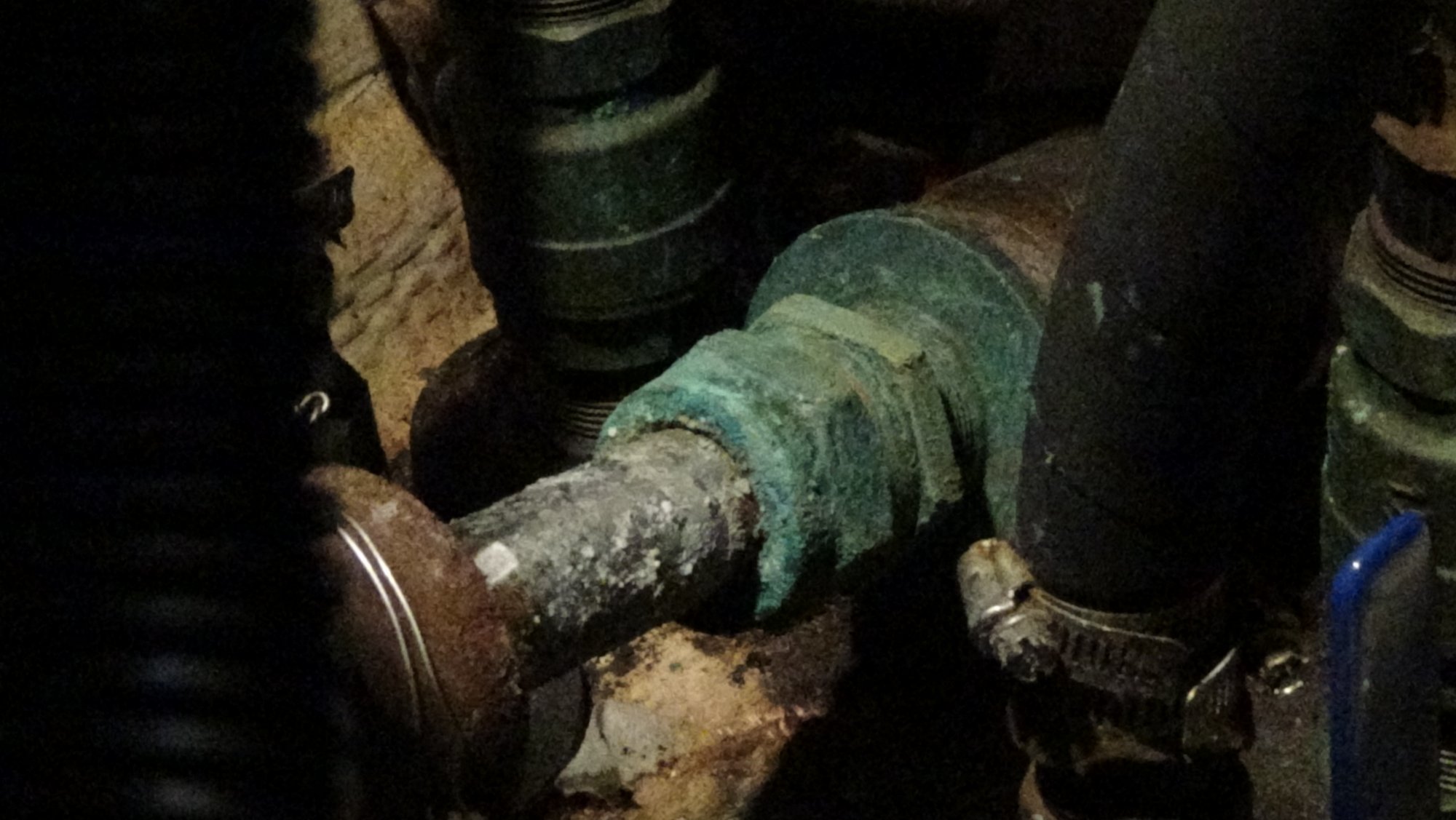

Here is a picture of our box. Right next to it, on the left is the Genset sea water intake hose and on the right is the main engine sea water intake hose. To get to it, I have to enter the engine room with my arms and hands in front of me as I slide over the top of the main engine. I have to hang over the engine far enough to reach the box. Once there I have limited room to maneuver tools to loosen the box. Most of the time it takes about two to three hours in this position to extract the old packing with an assortment of picking tools, and I've tried them all. Dental picks seem to work the best. It is a job that I dread and thankfully only every seven years.

That looks bad. Sounds worse. Yet your description reads like that of a professional at the task. Perhaps you might come down and demonstrate your technique. I’m always up for a training session.

Ours is a nightmare.
I remember you previously describing it. I believe I first saw a picture of your stuffing box used in an old Boris Karloff horror movie:
So this is a case of absolute necessity rather than choice.
Dec 25, 2000
6,056
Yes, Ralph. Very fitting description. Wondering if it would be easier to disconnect the shaft from the coupler and slide the shaft far enough to remove the box from the shaft in order to replace the stuffing. Just a thought.
