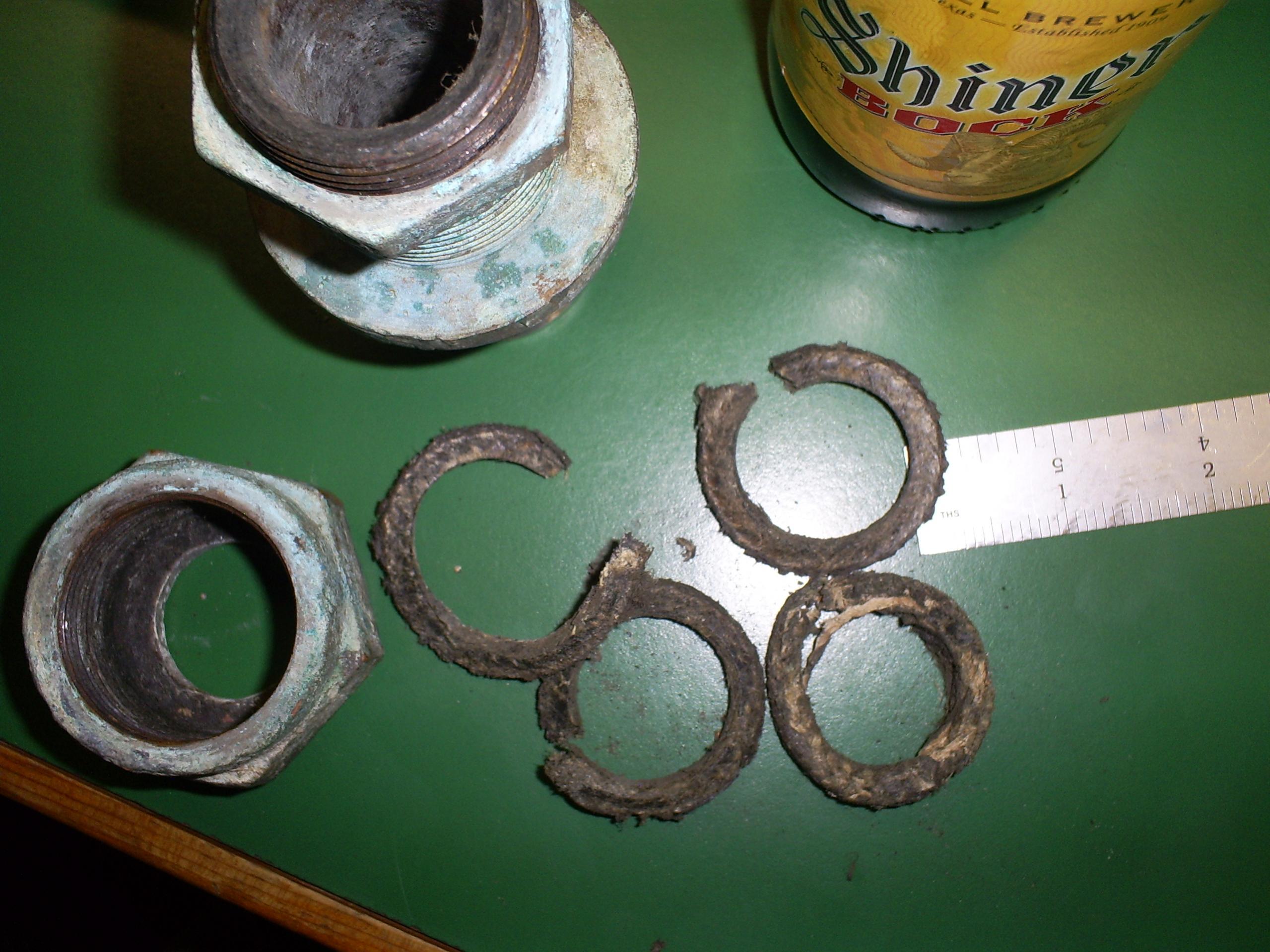

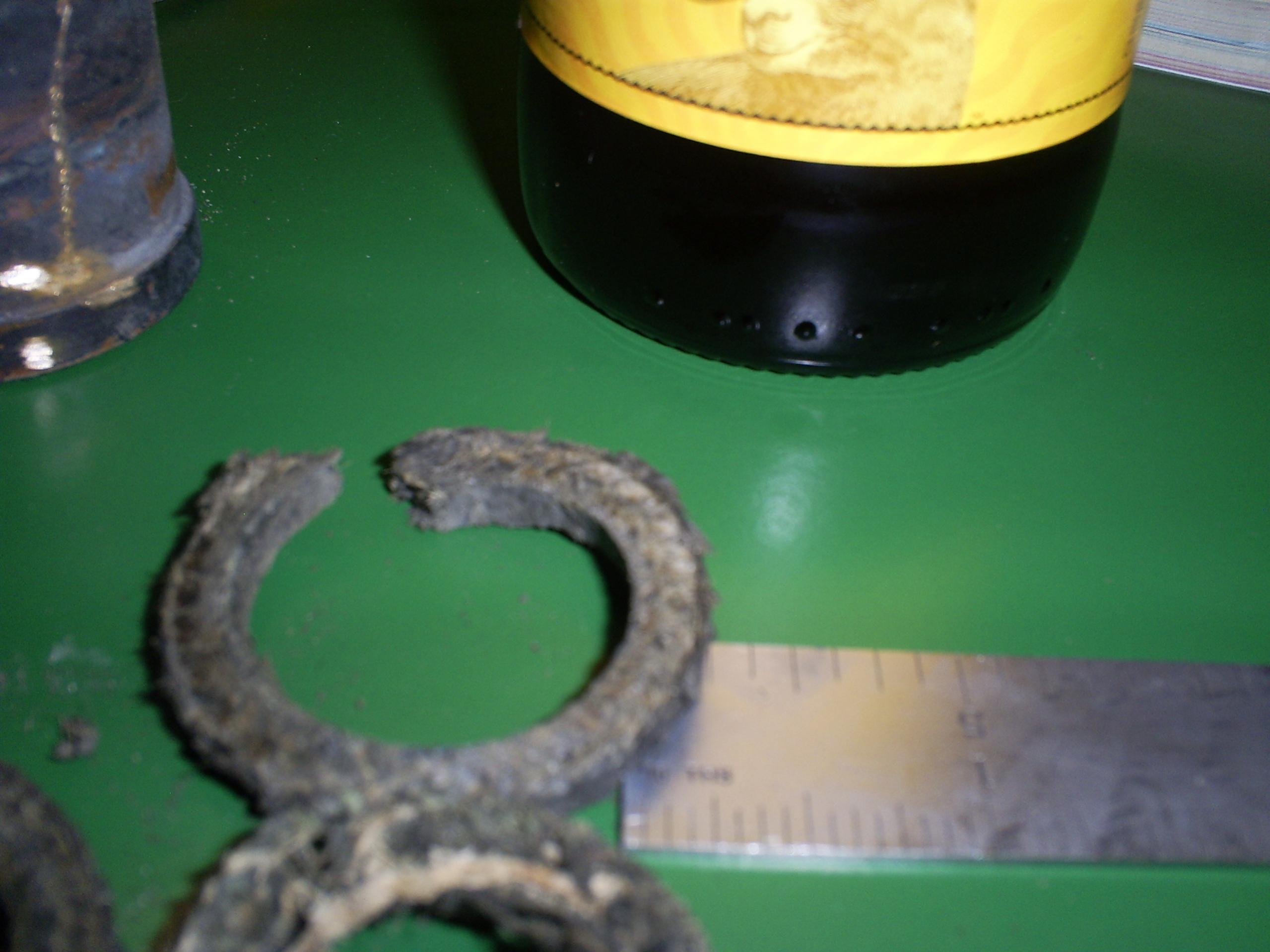

The threads are 1-7/16" outside diameter on the threaded part that accepts the packing nut. And a 1" shaft. In the picture the width of that packing is either a smashed out 3/16" or a smashed in 1/4". Very nearly in between the two measurements.

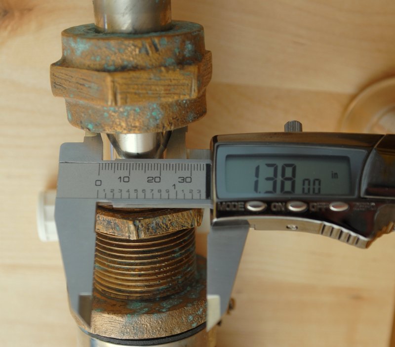

Measure the od of the male threads of the shaft log or the id of the stuffing nut as shown below. As you can see I have roughly 1 3/8 inches. Then subtract the shaft diameter from the total id or od.
1.38" - 1" = .38" now divide that number by two and you get .19" or as close as you'll get to 3/16" or .1875"
(.38", or .19" after dividing, is about as close as you get to .375 or 3/8" or .1875 or 3/16") .
Do me a favor and use the knife blade ends of your calipers and measure across the bottom valleys of the male threads instead of the peaks. This should more closely match the ID of the nut.
1 1/2" diameter minus 1 7/16" equals a 1/16" difference. So your thread depth should measure 1/32". Either way it's still a 1/4" packing not a 3/16". 3/16" would be too sloppy.
