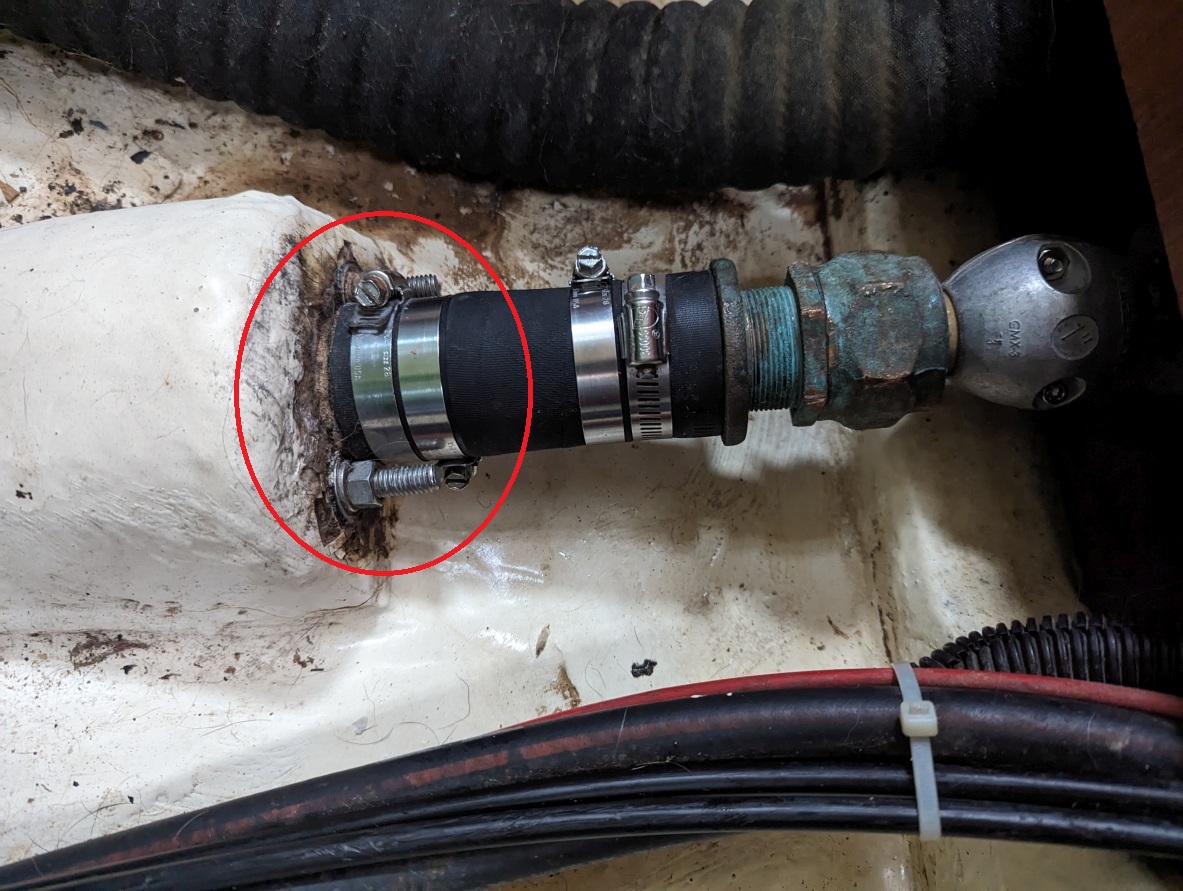

Hi all,
It's been project week on the boat, and included on that list was tightening up the packing nut. It was staying dry at rest, but was a constant flow when the prop was turning. The nut came loose fairly easily, and I was able to adjust it down to ~1 drip a minute (when at relatively low RPM, tested while tied to the dock).
However, I forgot about Ahab's 3rd law...for every problem you fix on a boat you'll create another.
After getting the packing nut tightened down I went to dinner and came back and saw a some water in the prop bilge (my term). However, the drips weren't under the packing nut, they were on the other end, where the tube is connected to the log. When loosening the packing nut it did torque the tube a little. I held it with my hand, to offset the pressure (and used two packing nut tools to offset), but I'm guessing that little bit of torsion was enough to perhaps "un-seal" whatever crud is/was around the tube space. The tube appears to be relatively new and in decent condition, so I don't think that it's a tear/defect in the material.
I tightened down the hose clamps (they were already quite tight), but it has continued to drip. I should be clear...its more of a slow weep than a drip. I let it sit over night and had maybe 3oz of water in the prop bilge (a minimum enough that it was easily wiped up with a washcloth). I'm not worried about this sinking the boat or anything. However...this used to be dry, and I would prefer not to have any lake water entering the boat.
I've tried repositioning the hose clamps a little, but no avail. I'm starting to think that the hose clamps/tube are not the issue. I'm wondering if folks have addressed something similar. Where do I look next? Is the stern bearing/shaft log typically "sealed" when installed? Is there a chance that it needs to re-bedded? Did that bit of torsion on the tube somehow damage the shaft log/barb where its attached (is that possible)?
I've included a couple of pictures for reference.
Thanks!

OK, FWIW. I think the studs sticking out next to the hose goes to a bedded fitting in the stern tube. Maybe. It might need to be rebedded but that will be a haulout job. Maybe somebody who KNOWS about Hunters will chime in.
Why do you have a zinc attached to the shaft INSIDE the boat? Curious minds want to know.

I'm guessing you've already checked for this, but I'll go ahead and ask anyway, just in case: Have eliminated the possibility that the leak is originating farther up and gravity is pulling the water downhill to the point where it drips?

Indeed, as I've stated at things for a while I do think that the shaft log has come unbedded. We're up North, so a haul out in the fall is inevitable... I may just need to watch it and decide if this is something that needs to be addressed sooner.
@Alan Gomes is correct, the zinc is just there in case the prop ever comes loose. I have a true sacrificial zinc on the shaft in the water as well, of course.

Indeed, I've been staring with a flashlight, it's definitely weeping in from just below the tube, not somewhere up shaft.

Thanks, Ralph. I strive to create unique problems in whatever project I undertake.

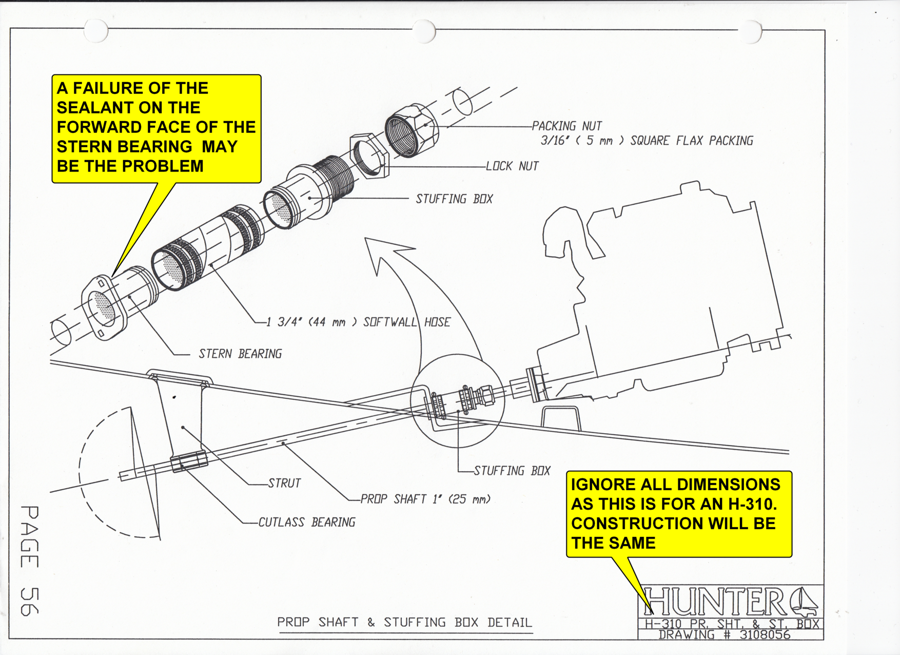

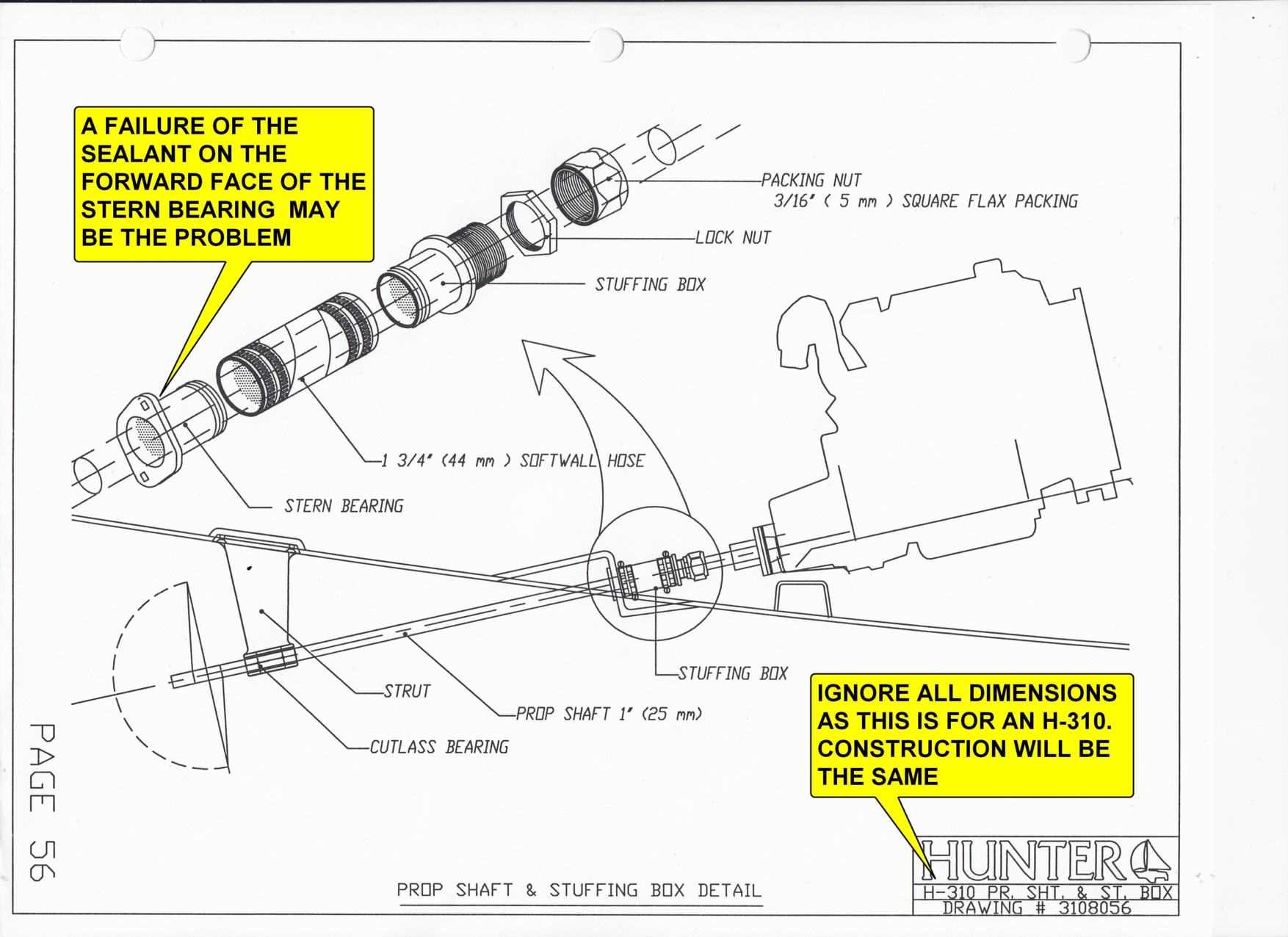

I had a feeling that the bonded surface is where the problem may lie (I did break out my 376 manual and saw the same drawing but, of course, there is no actual mention of sealant in the manual). I searched a lot of forums but haven't seen anyone mention this before, so this thread will need to be marked as the
It's a pretty slow leak, but it is definitely there. I was able to slow it even more by tightening down the two nuts holding the stern bearing in place. I'm thinking I might buy some flex-seal tape and try to patch it until I haul out in September, then do a whole prop-system refresh (new cutlass bearing, new stern bearing w/sealant, re-align the prop).
Given some of the crud that I see I'm almost wondering if the previous owner had this issue and put some form-a-gasket around the lip (which was then broken loose by my adjusting the packing nut). I didn't pry it THAT hard that I would think I would have de-bonded 5200 but and the bolts weren't that loose. On the other hand, it is a 28ish year old boat so I'm sure everything has worn to some degree.
If it's any consolation, you may be the only owner to ever experience this problem. Bragging rights maybe ?

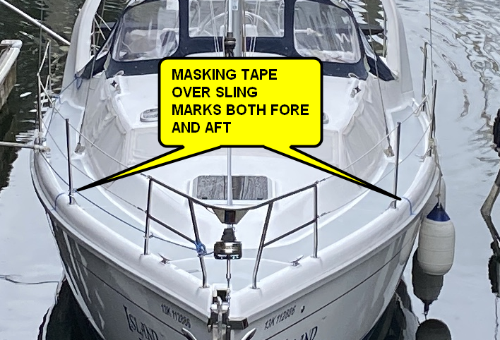

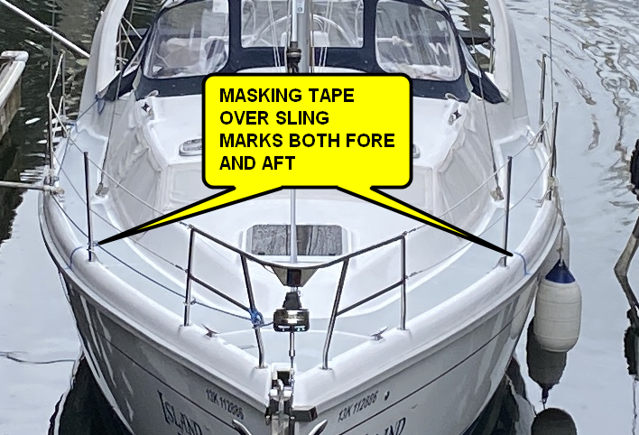

Maybe not attack the cutlass bearing until you've had a chance to test it by heaving on it, searching it for radial play. My boat is a 1999 delivered new to me in 1998. There is still 0.000" play in the cutlass bearing (2400 running hours) which I feel is due to the fact that I have:
- maintained the prop shaft alignment over the years (was originally 0.010" angular error from the factory).
- haven't hit anything with the prop.
- have always marked the sling points with masking tape before lifting to avoid having the yard place the sling under the prop shaft.
- attended church regularly.
- and dropped a few pennies in the poor box on my way out.
Legit idea but I'm thinking there are more durable products than flex-seal. A very similar product is goop. It is thicker and hardens to a very tough rubber. I have used it to make gaskets on several occasions .. You can usually find it at any big-box store
Build a damn around the area with masking tape... then fill in the "reservoir" and let it set up for 48+ hours. It hardens to tack in about a day but after a few days will turn into a very hard rubber compound.
