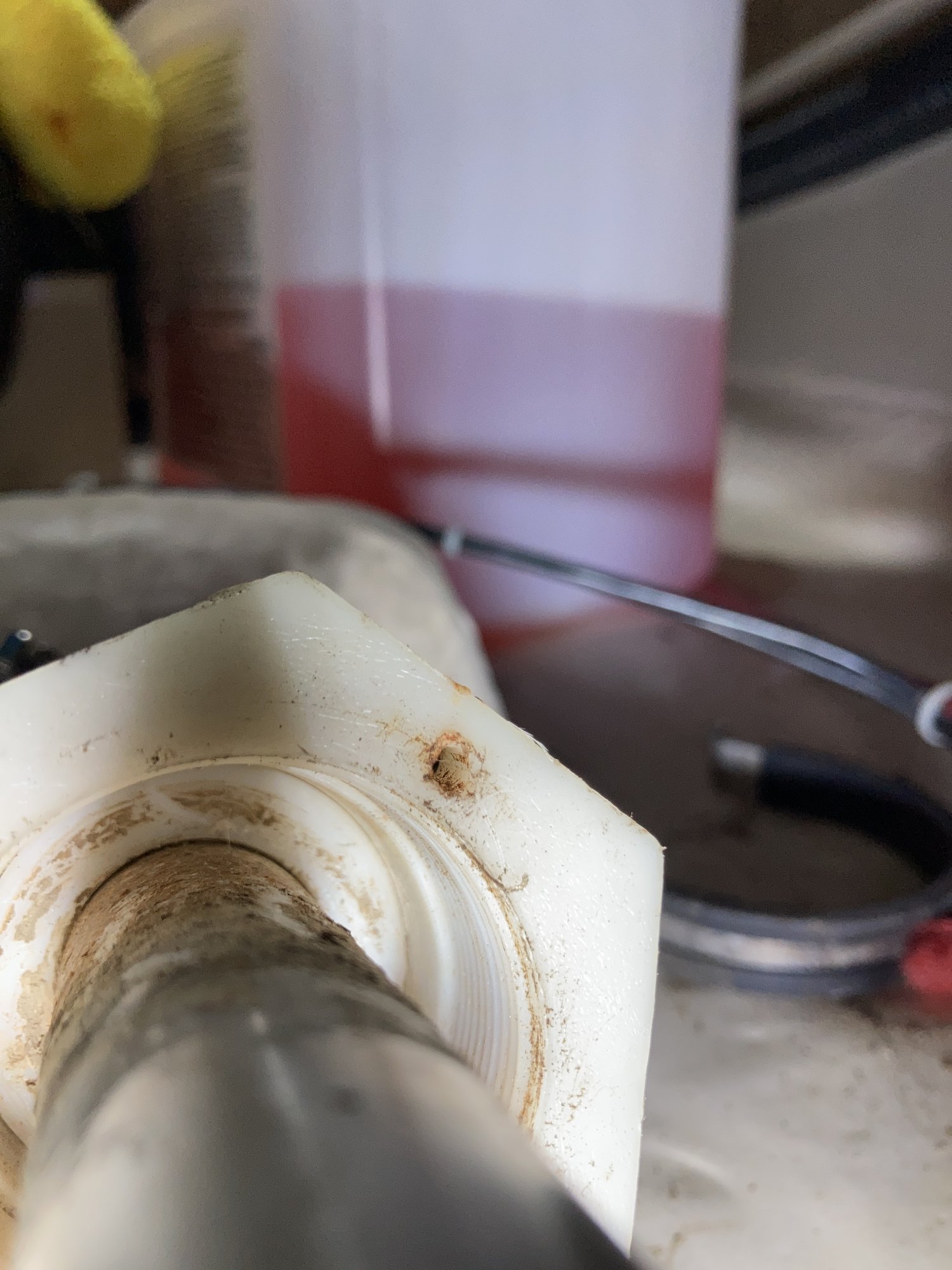

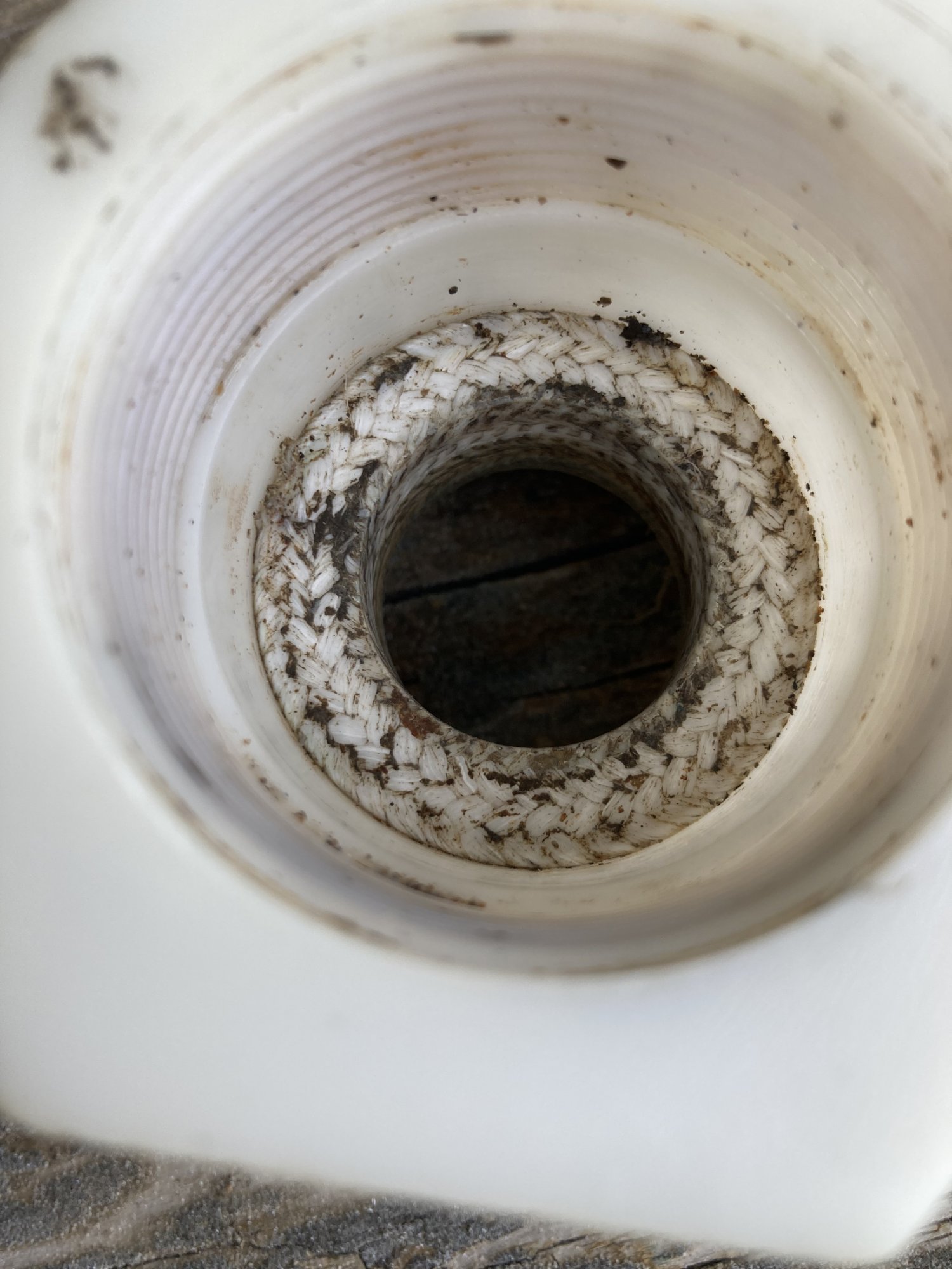

I opened up my packing gland thinking i would change the packing. I took a picture of the inside of the gland. It looks like either there is either some new type of packing that I haven't seen before or mine has disappeared.:yikes:
If this is in fact the packing any idea's how to remove it? I will polish the shaft before installing the new packing.

It appears that your packing is missing. I have no explanation. Is is possible that the packing is stuck to the other half of the packing gland? If so, I would expect it to be very visible.
No packing would mean that the gland would leak very badly. Was that the case?
Whatever, I would pack it with new material and adjust as needed. If it disappears again, I would suspect that your boat is possessed.

It was a slow leak last fall when I pulled.

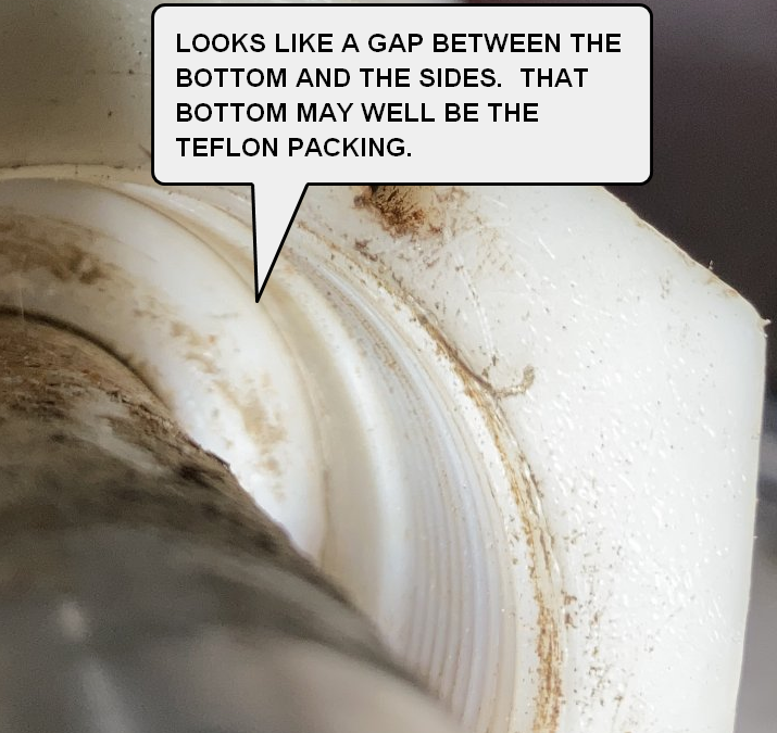

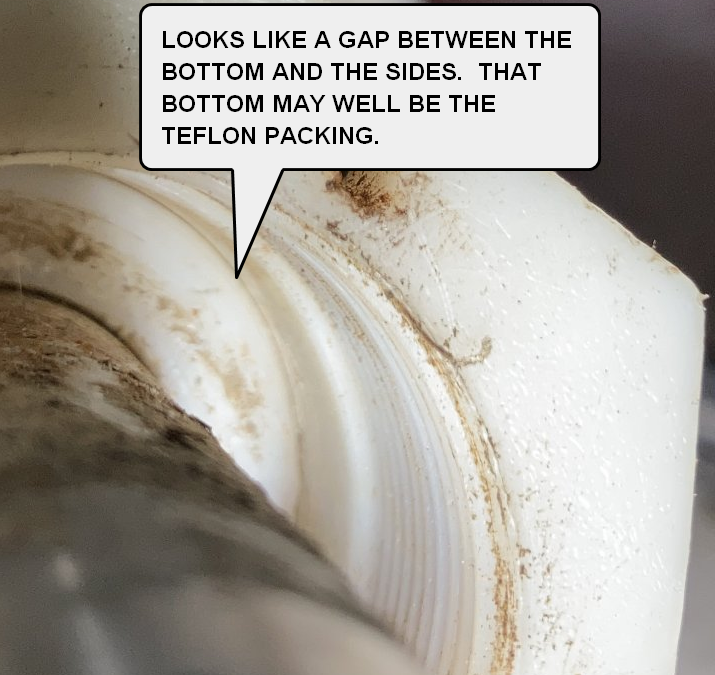

And there was no packing on the other half. Maybe some king of Teflon packing? I've taken pictures all around and can't find a split to pull it out.

It looks empty. Did some previous owner put some of that new-fangled stuffing gland putty in there, and the prop shaft ejected it? It is a wonder you had a dry bilge.
Good thing you discovered this.
I would inspect the shaft. If it is just dirt, that is one thing. If it is pitting, then you may be looking at a shaft replacement.
When I pulled my engine, I thought the shaft was in good shape. Then I slid the stuffing gland away and found the damage.

It could be teflon packing that is squeezed so tightly that the ends can't be seen. Have you tried digging into it with a sharp dental pick?

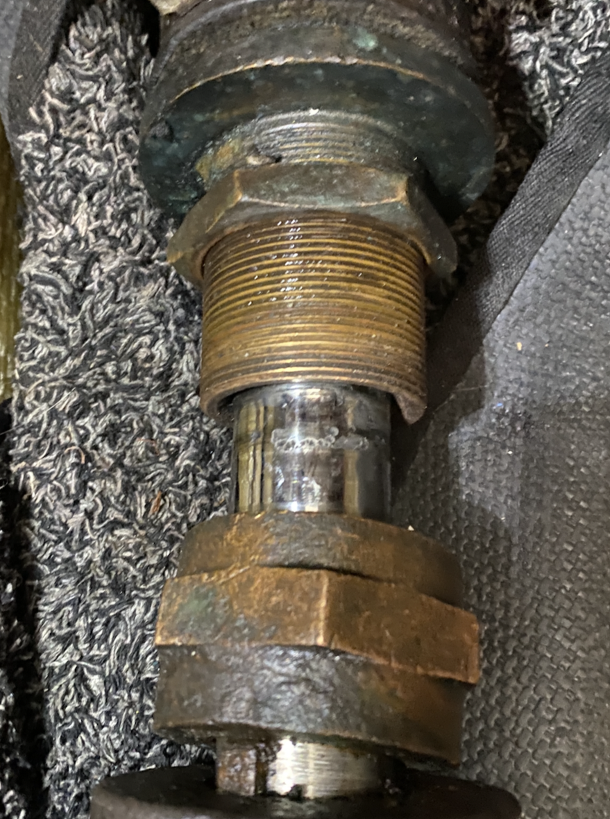

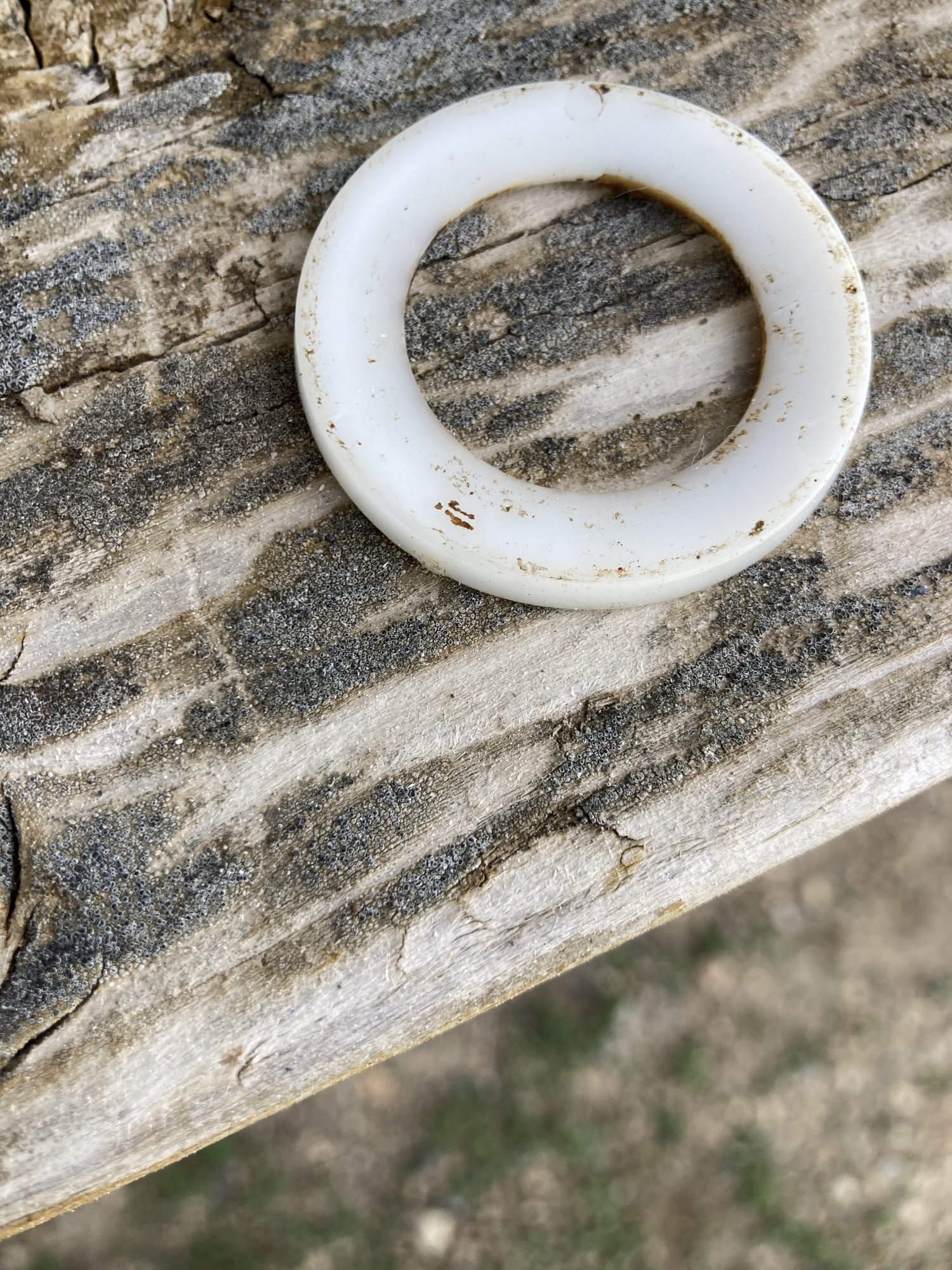

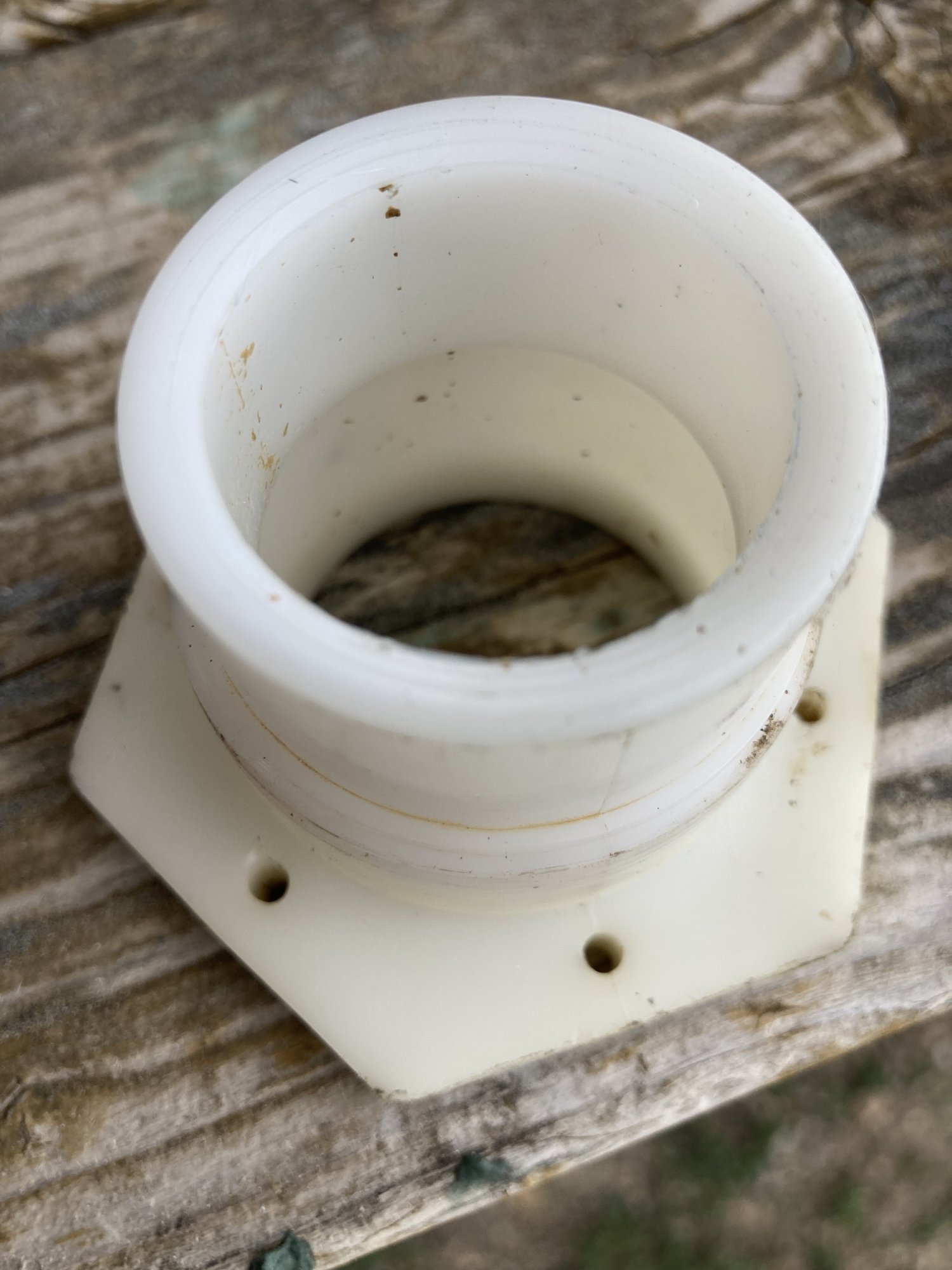

I pulled the prop shaft back and removed the key and pulled off the stuffing gland. As you can see there is some packing that was behind the Teflon washer. I didn't try to pull that out. It looks like I'll just tighten it up and maybe when i pull in the fall i'll deal with it.
