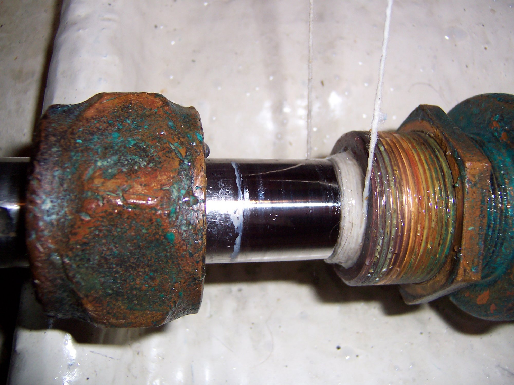

So far only got six years out of my teflon impregnated flax (100 hr/year motoring) but if I remember rightly, I only changed it because it was open and I had nothing better to do. I'm sure I can get eight years on this present packing. Stuff gives a beautiful polish :
Nice pics. 8 years is a good start. We cycled many pumps through maintenance periods and simply reinstalled the SLADE packing that came out. Worked fine.

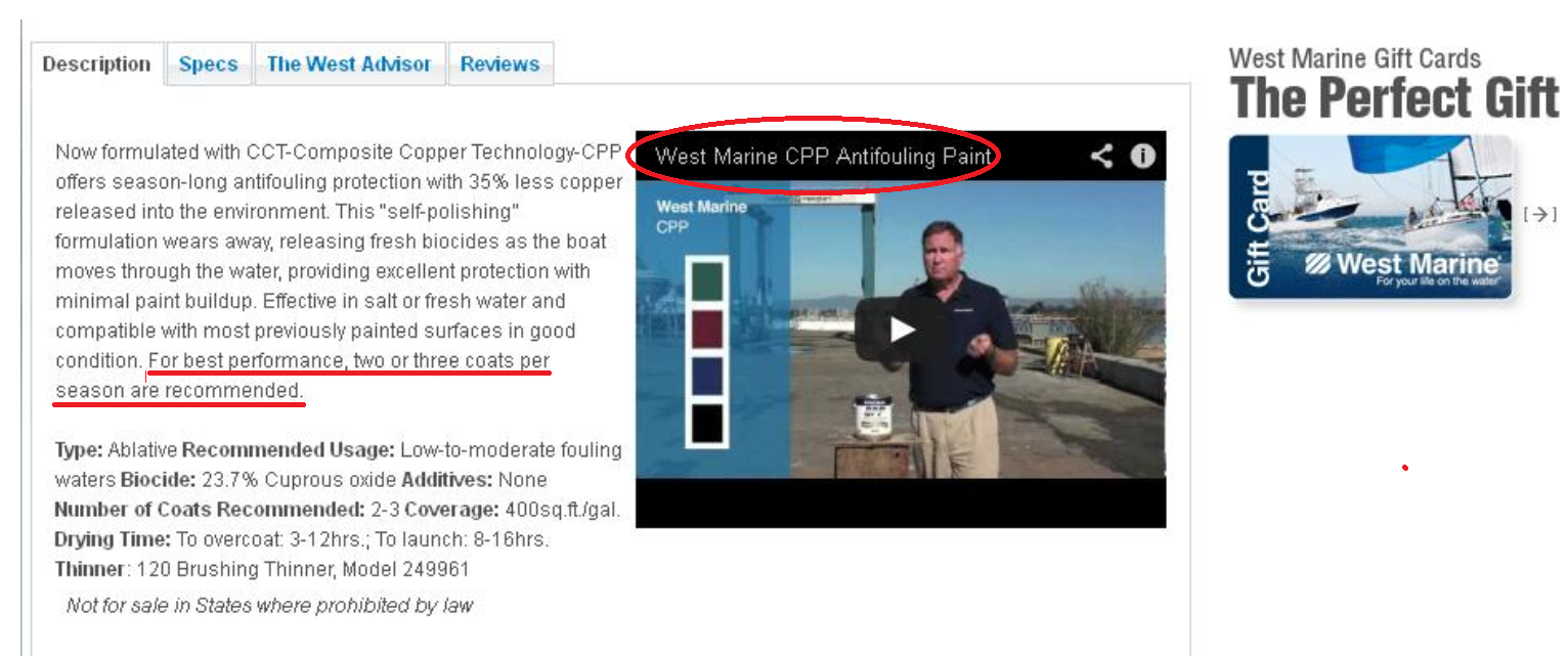

Interesting. We had a discussion here recently about the life expectancy of bottom paint and I came near to being keel-hauled because I said I was able to get 6-7 years out of Waste Marine CPP IN MY WATERS. Have a read :
Regardless of the nattering on there, it got me to thinking "Why are you bottom painting this haul out ?"
I came to the conclusion that most people do it because "That's what the literature says for my bottom paint". Pretty poor reason for bottom painting. After I applied the first double layer of Waste Marine CPP Marine Ablative Antifouling Paint in 2013, I faithfully half hauled each year for a quick inspection, new zincs, and a pressure wash. Year after year, no barnacles (slime only), and no sign of the black warning coat. 2019, I figured the warning coat HAD to be showing so came fully loaded to bottom paint. NOTHING. Figured I may as well paint seeing as how I was all dressed for the occasion.
This time around, I'm shooting for at least 8 years plus anything extra I can get out of it. The current bottom coat is smooth and tight with nothing waiting to shed.
Can't wait until I spring this on the people here who obediently follow the instructions in the literature. Not exactly an unbiased observation when you're pushing your own product. Little bit like the fox guarding the hen house.
