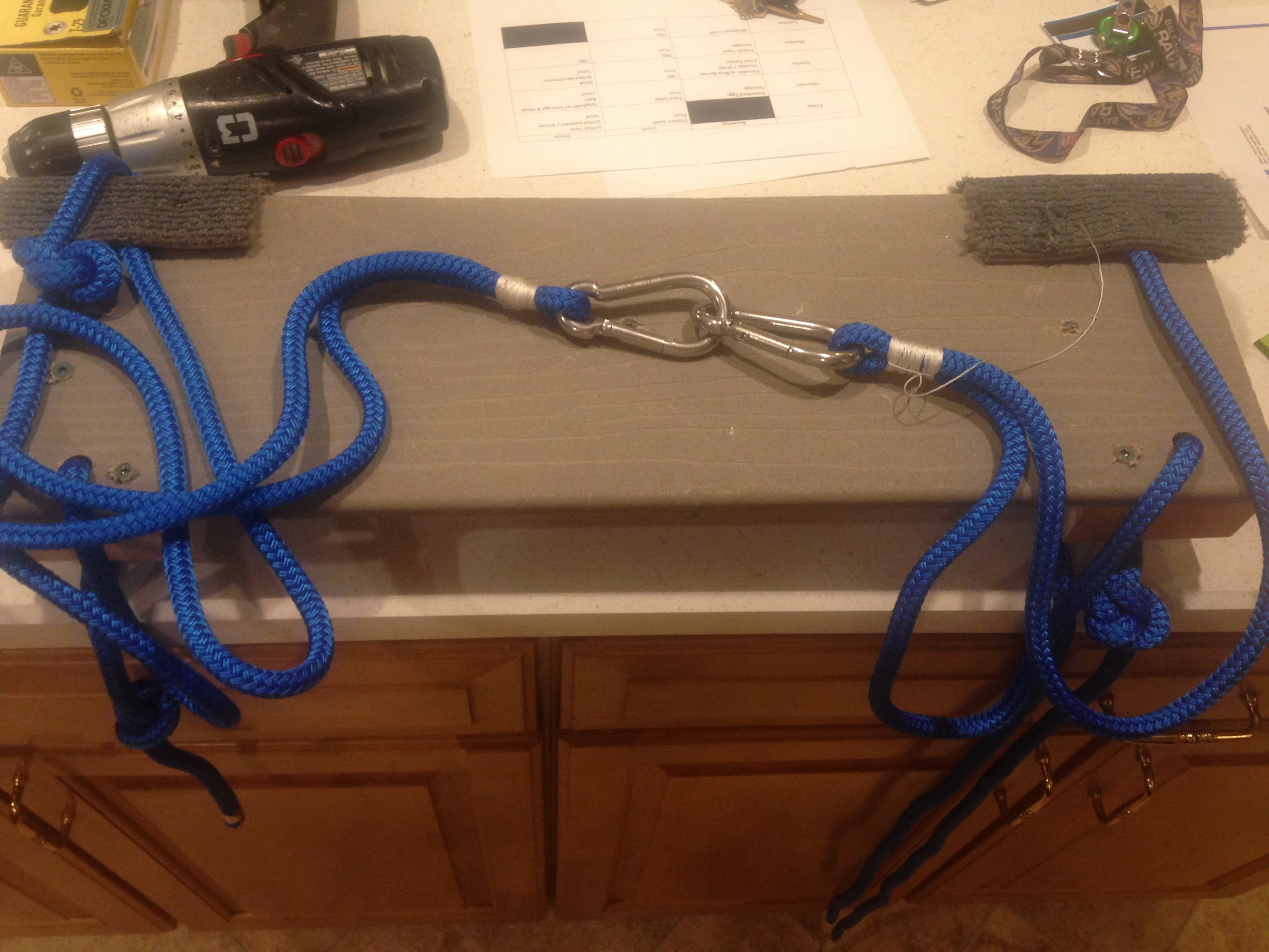

That looks great. Need to see if one step will do what I need.
What type of wood did you use?
Red Oak with polyurethane applied. Nothing special, just what I had on hand. The most expensive parts were the clips. Total cost was about $15. Would be a little more if you have to buy a short piece of wood.
