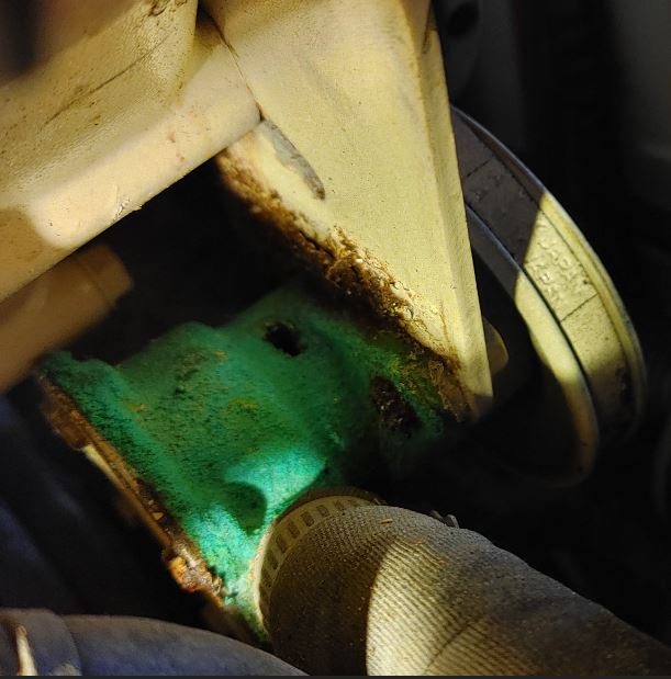

Terri - thank you! Your write-up is exactly the situation I'm experiencing - seawater is not pumping thru the engine.

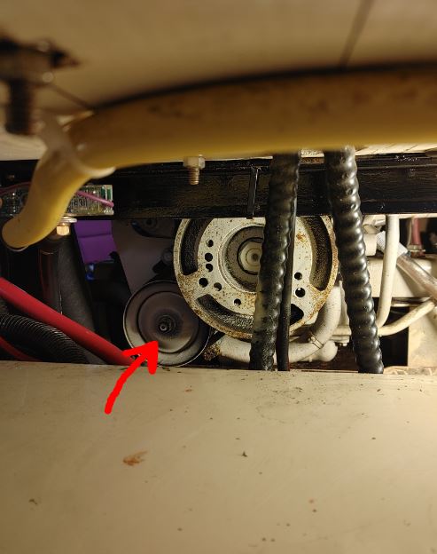

Given the location of the generator, batteries and inverter it is very difficult to trace things out (I'll be pulling things out once I start working on the unit). Can you confirm my suspicions from the pictures below?
I believe the seawater is driven thru the pump that is in the lower left hand corner of the picture (it has a separate small dedicated belt - driven from the main crank). Is that the only seawater pump on the unit and likely the Oberdorfer? I've included a picture from the back side of the pump and it's quite corroded as if the shaft seal has failed and may be where the air is incoming.
And can you tell me where you were able to source the impellor? (I also want to replace all the belts)
I suspect your write-up saved me a lot of detective work. Thank you!
Dec 25, 2000
5,932
Hi Jim, that looks more like the engine circulation cooling pump, not the sea water pump. The sea water pump is an Oberdorfer brand on our engine with access through the main engine door, port side. The pump is right next to the generator housing and a PITA to work on. Please call me at 425/513-9673 and I can help you with some of the details. The pump cover is held in place with four small hex bolts. The best tool to loosen is a box wrench; forget the size.

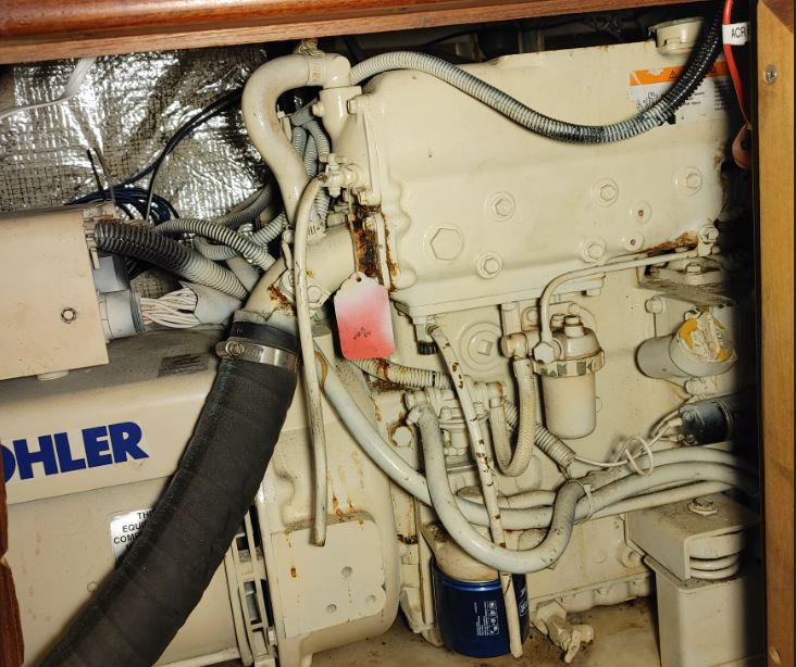

Terry - thanks for the phone consultation - it's appears we have different generators. For the record here's the side of my gen. If I figure out what engine it is I'll post it on this thread.
I'll use your troubleshooting steps to figure out the problem. Thanks again for the pointers.
JamesG161
Feb 14, 2014
7,770
Hunter 430 Waveland, MS
My 9KW Kolher uses a Yanmar 3 cylinder 16 hp engine.
I can help if yours is a Yanmar.
Jim...
PS: I am dang sure that is a Yanmar engine. The exhaust Riser looks like my Yanmar.
10,093
That sure looks like a Yanmar 3HMF engine.. The HM shop manual says that the difference between the propulsion engine and the genset engine is, on the genset, the oil filter is on the governor side and the speed control is fixed at 1800 RPM. The sea water impeller for that engine is Yanmar part # 124223-42092. It is 50.8mm in od, and 22.1mm wide ..

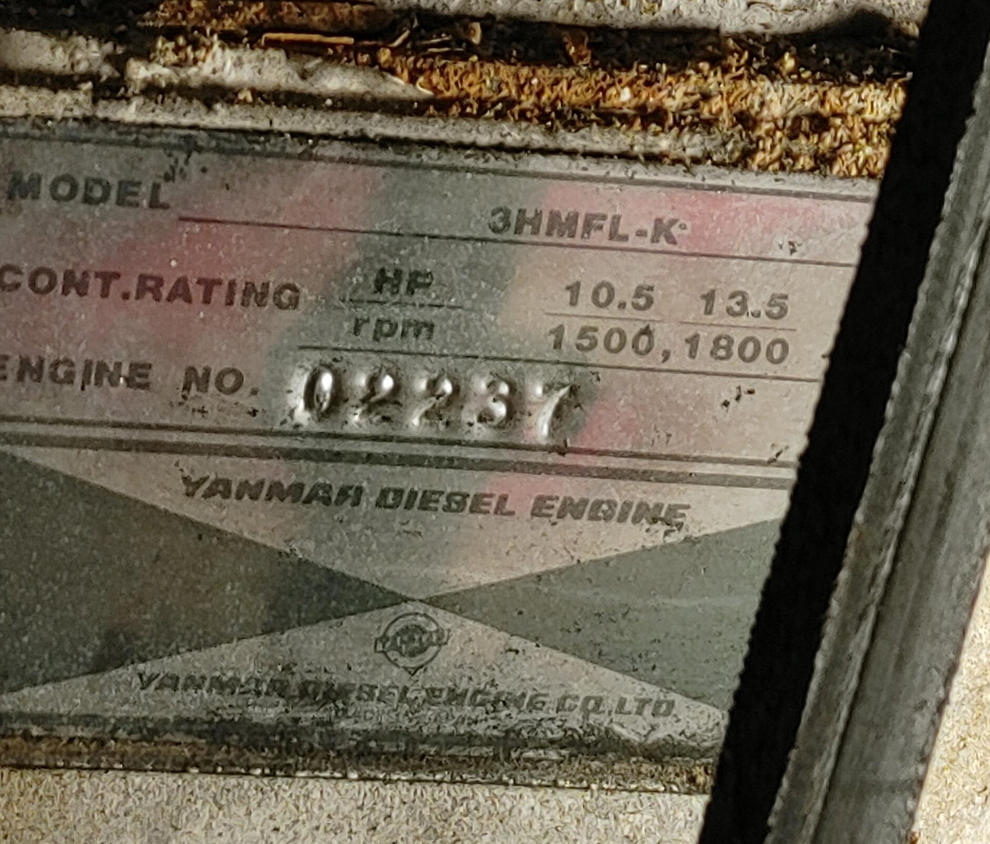

Thank you JamesG and Kloudie - you were correct this is a Yanmar 3HMF - after removing the starting battery I was able to see the identification plate. Also thanks for the seawater impellor dimensions - that helped me find the correct one.
Terri - nice video - it is a lot of work/time putting one together. I've seen several H42 vids on youtube - most recently I've been following JibSea. A young couple from Canada going to Bahamas - they claim they don't have sailing experience - if so they're fast learners.
Thanks again - my generator is on the mend.
