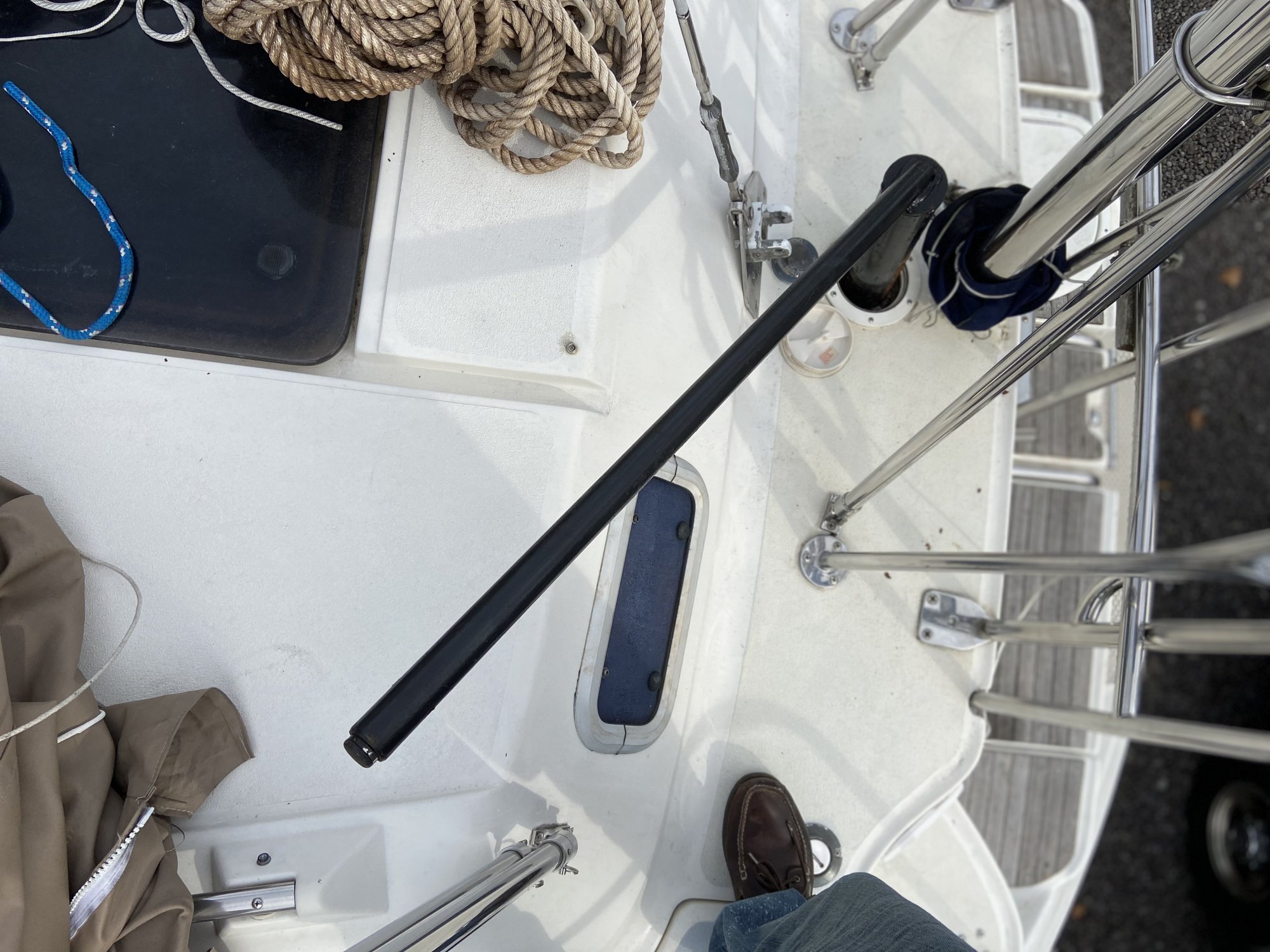

Looking at my emergency tiller and just not figuring how I could possibly use it. The backstay prevents the tiller from moving side-to-side.
What am I missing?

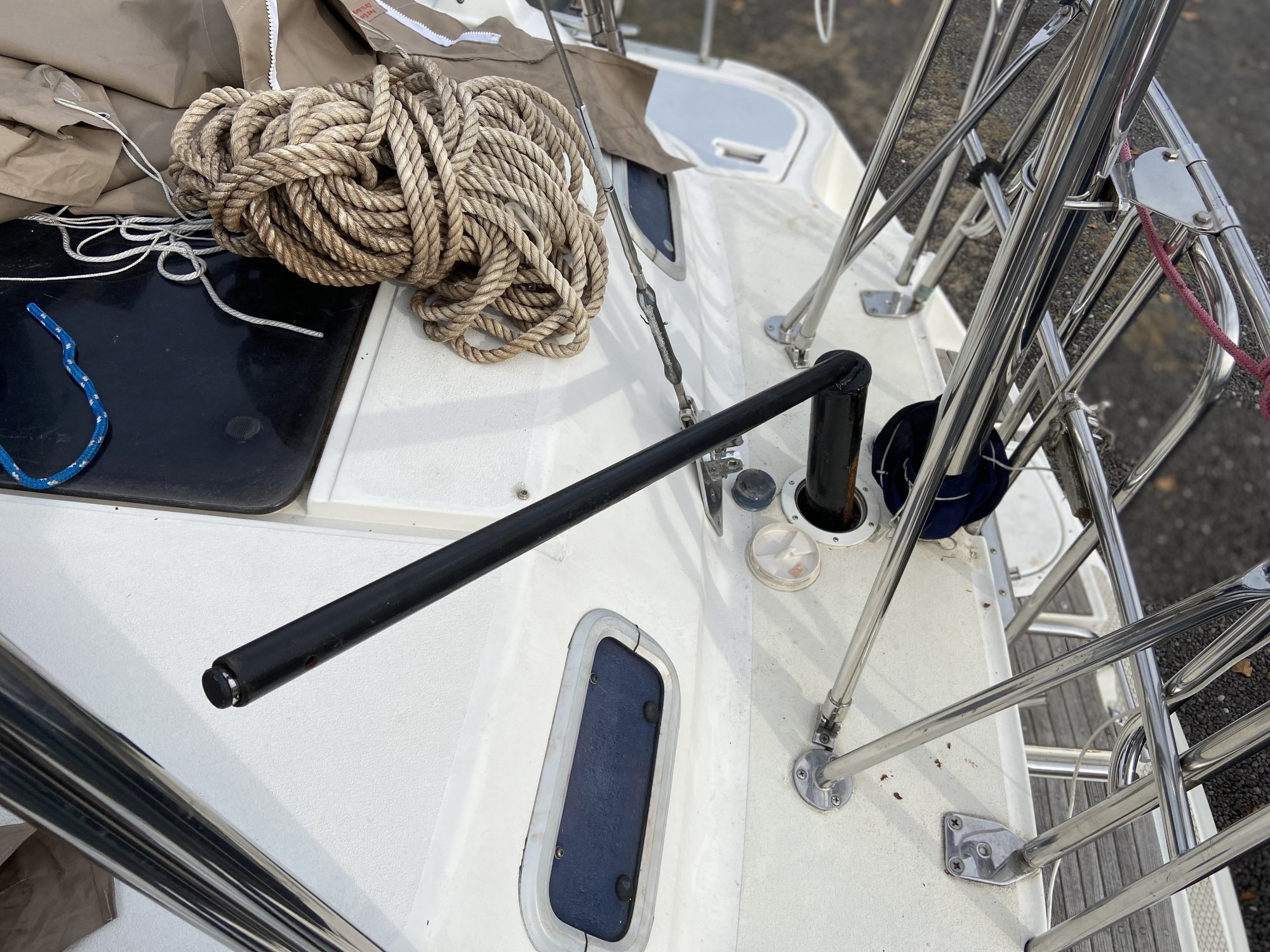

Doesn't look like a good setup. Looks like very little leverage if you're moving at hull speed under sail (or motor).
Jan 1, 2014
180
Hunter 42 Upper Chesapeake
Yep. There is a pole that extends out of the one you see. Maybe 2 feet. Would not want to use in bad weather for sure… of course the likelihood of needing it in good weather…………

Still not a lot of leverage. And it looks like you have other items on your transom that will restrict movement of the emergency tiller.
