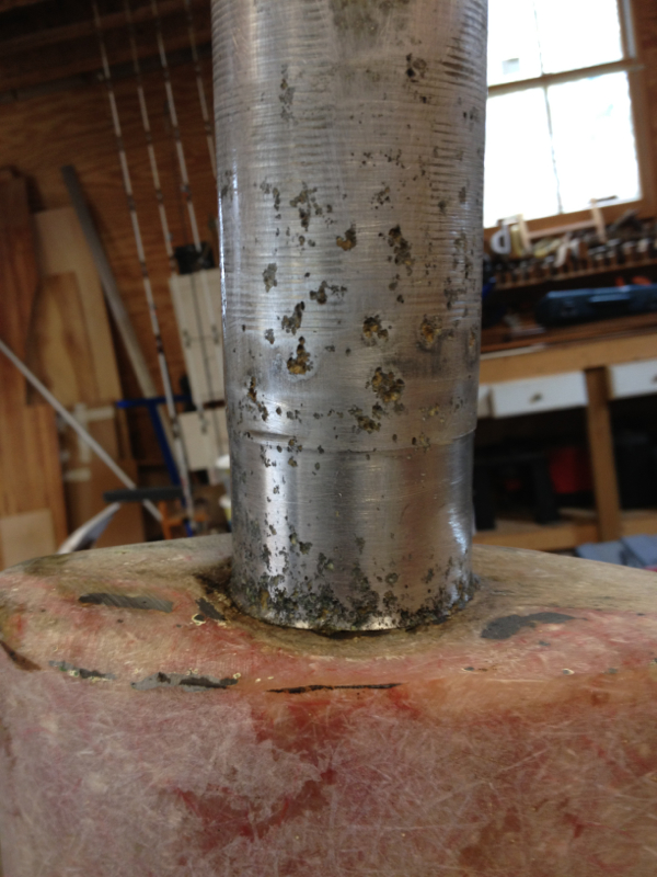

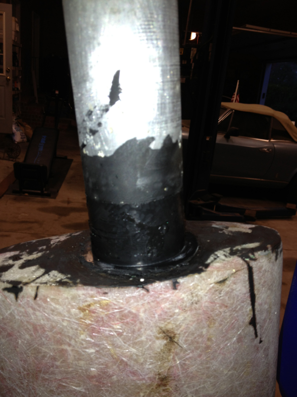

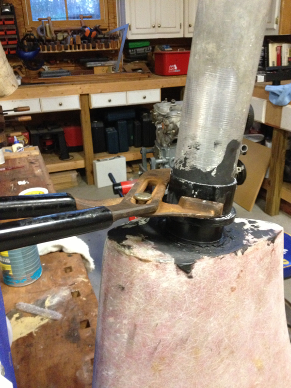

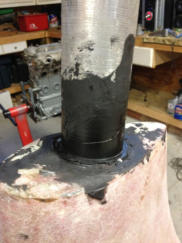

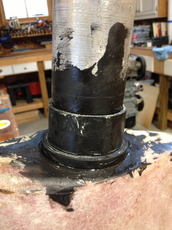

As detailed on Dan Pfieffer's website, were doing our rudder shaft today. Used the same materials and I sure hope the bushing comes loose after the epoxy cures.
Mr. Pfieffer's pictures were taken a while ago and kind of small resolution, so hopefully these may offer some more detail for others. Thanks to him for his great detailing of this repair for owners of these boats that are still out here.
