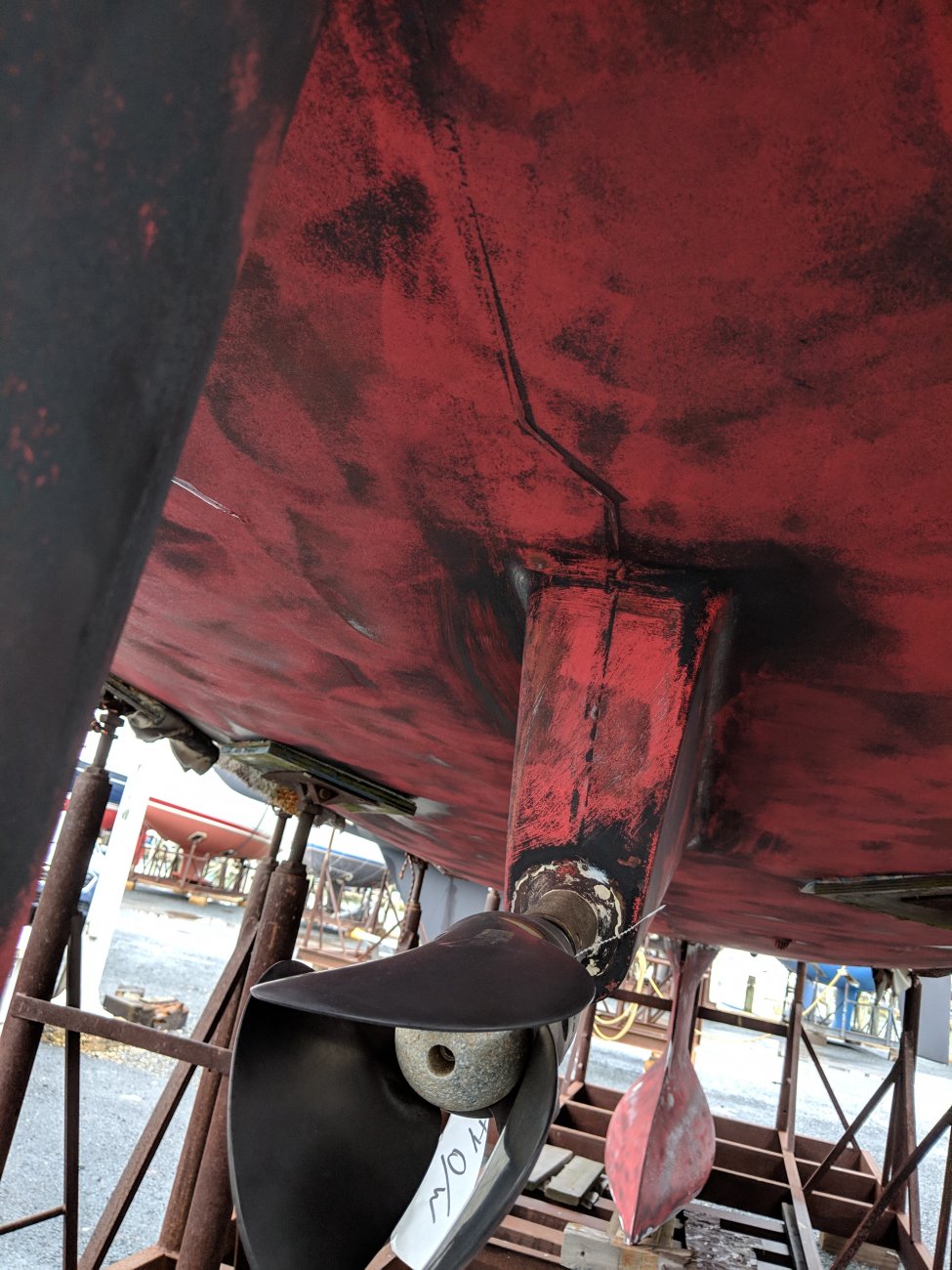

I have a Beneteau 37 with a Yanmar 3YM30 which also tries to pull the wheel when motoring at cruising speed. I wouldn't call it "a bear', but you definitely need to keep a hand on the wheel or put the brake on. No pull at all when motoring more slowly or sailing. It's done this with both the OEM fixed 3 blade and Flex-o-fold 3 blade. I've just always attributed it to prop walk types of effects.

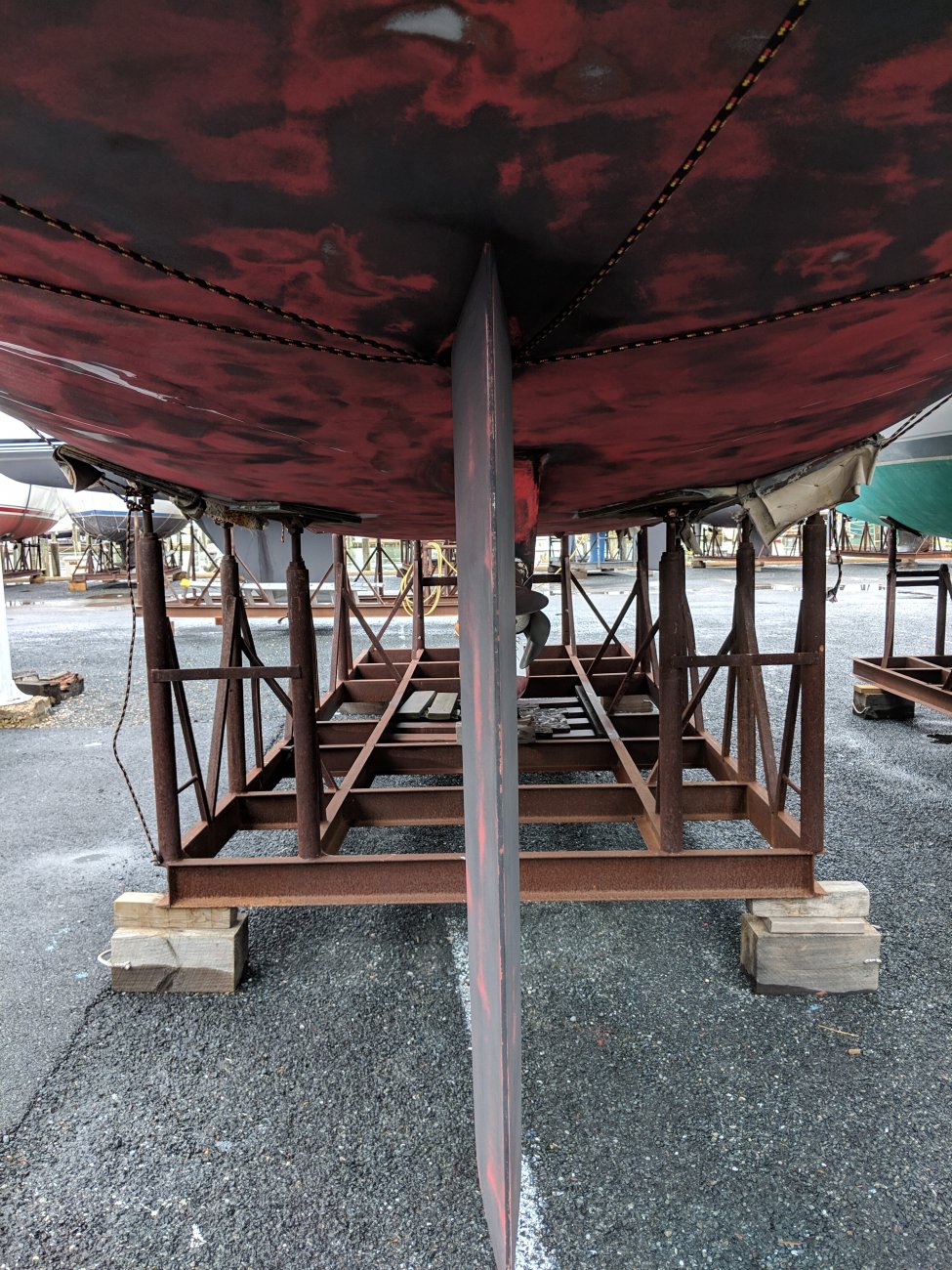

Stand in front or behind boat while it is on stands and with your eyes only check to see if keel, prop, and rudder are aligned. My friend had a new Beneteau that was clearly not in alignment. May have been designed that way for all I know.
May 17, 2004
6,262
Indeed. I was at the boat today and looked at the alignment, and the prop definitely is set off center.
It does seem to be deliberate - there is a joint along the bottom right down the middle of the hull, but it is sharply bent right just in front of the engine, and back to center just behind.

The prop is definitely off center, but I can't see the being an issue once the boat is moving, and water is flowing around the rudder. I have seen some sailboats (Sabre?) where the prop shaft is set at an angle to clear the rudder. I motored my O'Day 23 with the outboard mounted to one side of the transom, and there wasn't any noticeable pull at speed.
