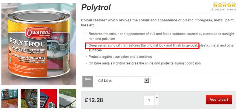

This product supposedly restores the faded gelcoat over all colors does not work on white. Anyone used it?

IMO, not worth trying.
Anytime I see the words "deep penetrating oil" in the description, I know it's just going to leave an oily slick on the surface so it looks as if it's accomplished something. Gone in a week or so.
The application directions require that you just wipe it on and wipe it off. It may remove oxidation (somehow) but it won't smooth out all those microscopic little pits like a compound does.
Wish it were true, but I'm afraid it's still the old fashioned way if you want a good finish on weathered gel coat :cry: .
