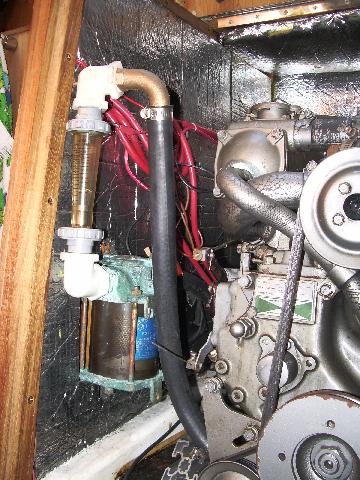

Hello all. I think I have a brain teaser that is currently frustrating me.
I have a Yanmar 3GM30F in a 1992 hunter Legend 35.5. Were currently cruising the south coast of Puerto Rico and a few days ago while on an overnight passage along the south coast of Puerto Rico I noticed that the engine water temperature gauge indicated that she was at 180 F and rising. This was at low RPM's of 2400. At this RPM level in the past she would normally run at 160-170 F. When I throttled her up to 2700 the temp indicator climbed to 190 F. which I had not seen before. When I throttle down to idle the temp would only drop down to 170 F. In the past at idle the temp gauge would normally be at ~ 130-140 F. There was an ample amount of water being discharged from the exhaust however I undertook the following with no luck so far.
1. Replaced the raw water impeller. The old one looked fine. after inspection.
2. Replaced the thermostat
3. removed checked and replaced heat exchanger cooling tube assembly.
4. Removed and cleaned exhaust elbow with muriatic acid. It did have build up on it but not a huge amount.
5. I have removed the belts and hand spun the fresh water cooling pump. It turns smoothly and makes no unusual noises (like ground down bearng ).
I will try to get an infrared heat sensor to see if the sender on the gauge is bad when we get to port however If anyone has any guidance I would appreciate it.
