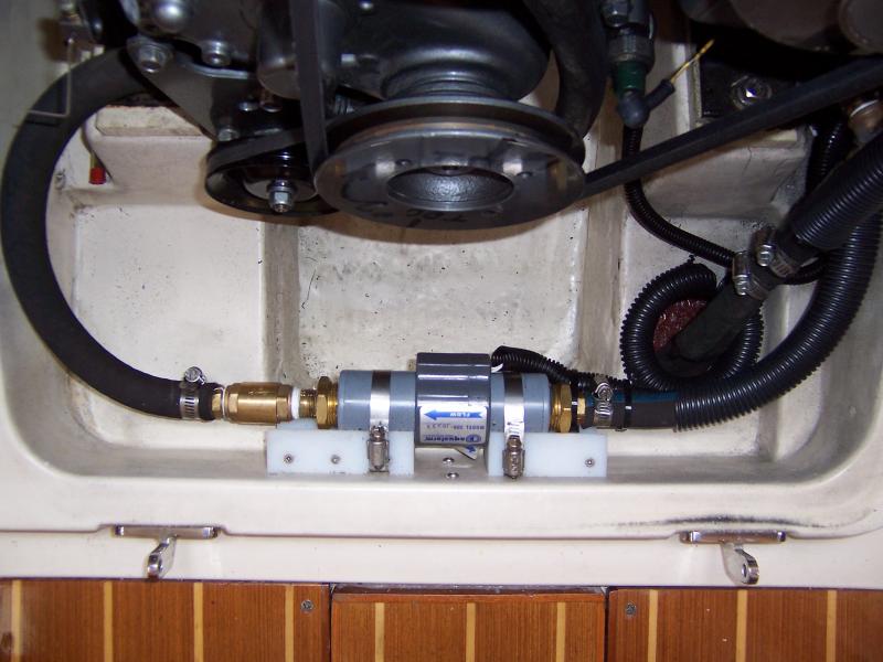

............................. was a bit of a bummer until I installed a flow alarm in the line leading to the raw water pump. Problem solved.

I have simply installed reinforced transparent hose so I can see the water flowing.
