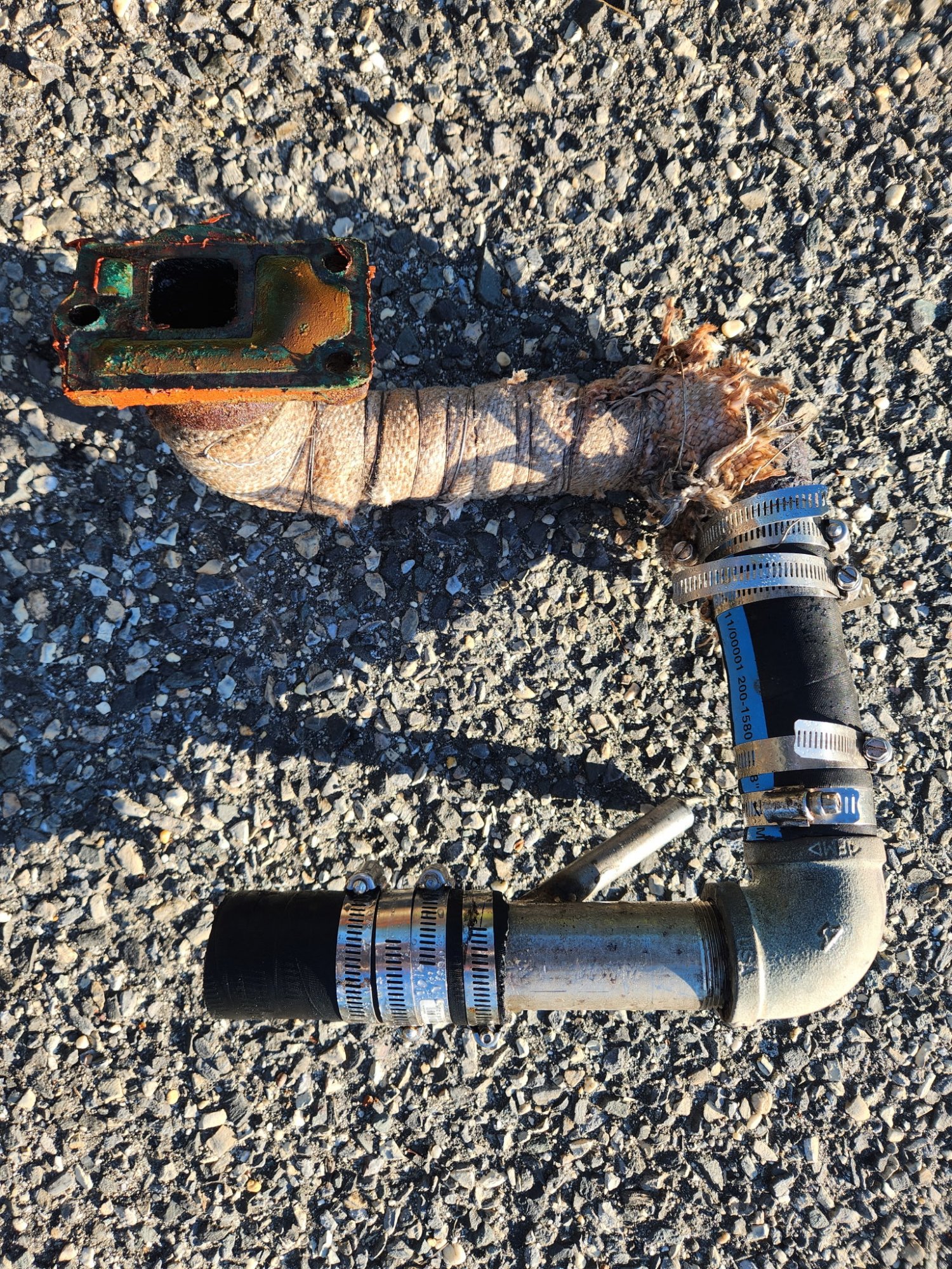

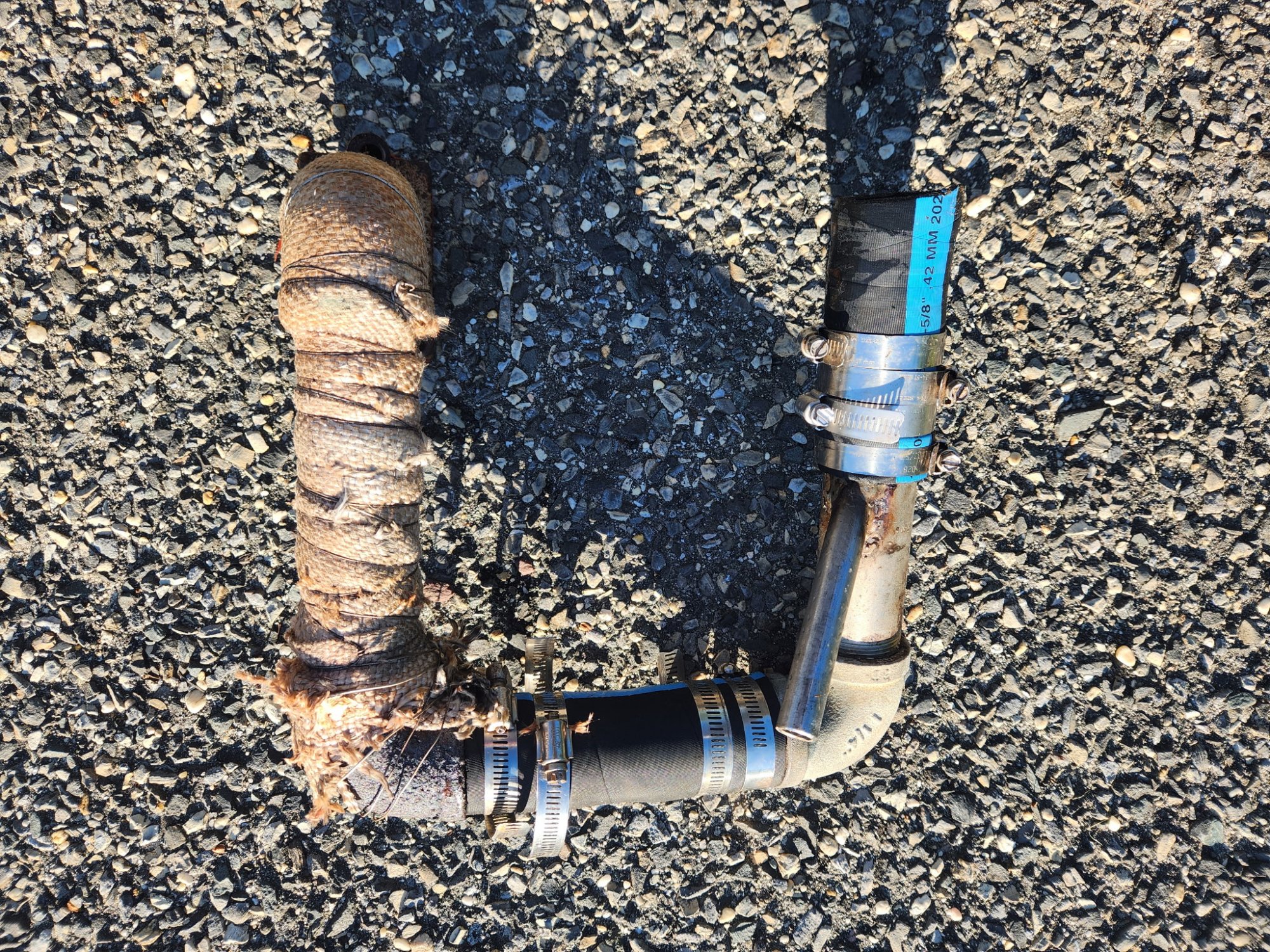

Well, I think you gentlemen steered me in the right direction and to take a close look at the mixing- elbow. I removed the whole home-made assembly and, with everything still together, it looks like the passages are clear. I don't want to disassemble it until I record all the dimensions in case I decide to make new parts. As of right now I haven't found a replacement for sale online.
What I did find, now that I understand the system a little better, is that on the present, partially homemade, mixing elbow is that the 5/8 inch pipe that injects the saltwater into the exhaust stream is flow-wise beyond the 1-5/8 inch exhaust-hose that always fails on our boat. So, no matter how much water is flowing, it never cools the horizontal exhaust hose and it burns up. I wonder if someone had it apart and assembled the parts in the wrong order?
I feel kind of stupid for not figuring this all out by myself but I just assumed it was supposed to be like it was. I need to place the water injection before the exhaust reaches all the rubber exhaust hoses. I really think I've found the solution. Thank you for all your very helpful advice! I'll let you know how I make out.

Oh yeah, that's wrong. And it is probably not original.
Water needs to be injected before the rubber hose and it should be positioned such that water can not back flood into the exhaust manifold. That's why I have the 180° elbow and what the PO was trying emulate with the hose in the middle of the system.

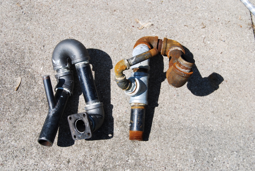

For comparison, the riser on the left is a copy of the factory's original and the one the right is a homemade one after the original failed at the beginning of a cruise and I had to get home. This was on a 1981 Sabre 30 with a Volvo MD7A motor. All of the parts in both are black iron and available at any big box HW store except the 180° elbow, McMaster-Carr has them.

1. As of right now I haven't found a replacement for sale online.
2. is flow-wise beyond the 1-5/8 inch exhaust-hose that always fails on our boat. So, no matter how much water is flowing, it never cools the horizontal exhaust hose and it burns up. I wonder if someone had it apart and assembled the parts in the wrong order?
3. I feel kind of stupid for not figuring this all out by myself but I just assumed it was supposed to be like it was. I need to place the water injection before the exhaust reaches all the rubber exhaust hoses.
1. I found this years ago, don't know if it is still available. Many folks cobble together their own exhaust risers.
Westerbeke Nipple Source NIPPLE - Westerbeke
2. Yes, it should be ALL insulated metal up to the injection nipple.
3. Don't blame yourself. Unless you made it! :) Many of us bought boats that had dubious stuff done by a PO. Catalina Direct offers pre-made exhaust risers, usually dimensioned for Catalinas. Try them, they might have one for you.

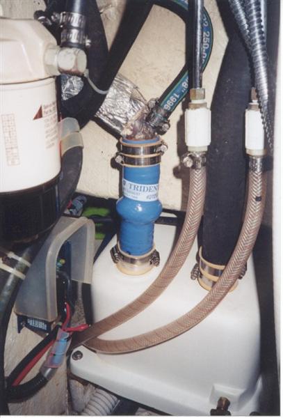

Good luck, glad we could help. BTW, that BLUE HOSE is called hump hose, and should be used. Noodle around in the link I gave you earlier; saves the inlet port of your muffler by absorbing shock.

Good find. That section between the elbows should be iron pipe, not rubber. If the rest of the metal is in good shape you might be able to just replace that piece. But the elbow on the manifold side looks a little iffy in the picture.
If you rebuild I would use black iron pipe, not galvanized.

Great! Thank you for the advise and support. By "blue hose" do you mean black exhaust hose with the blue stripe?
