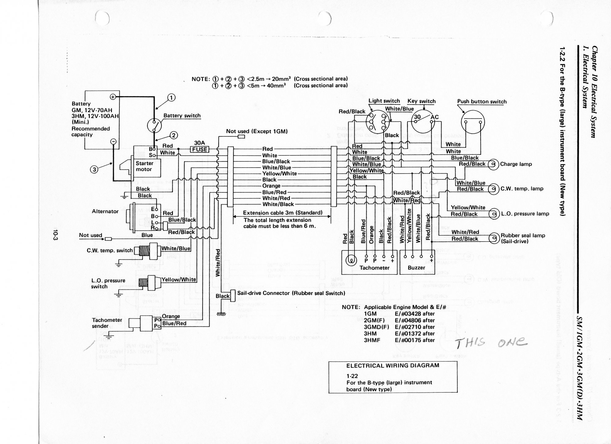

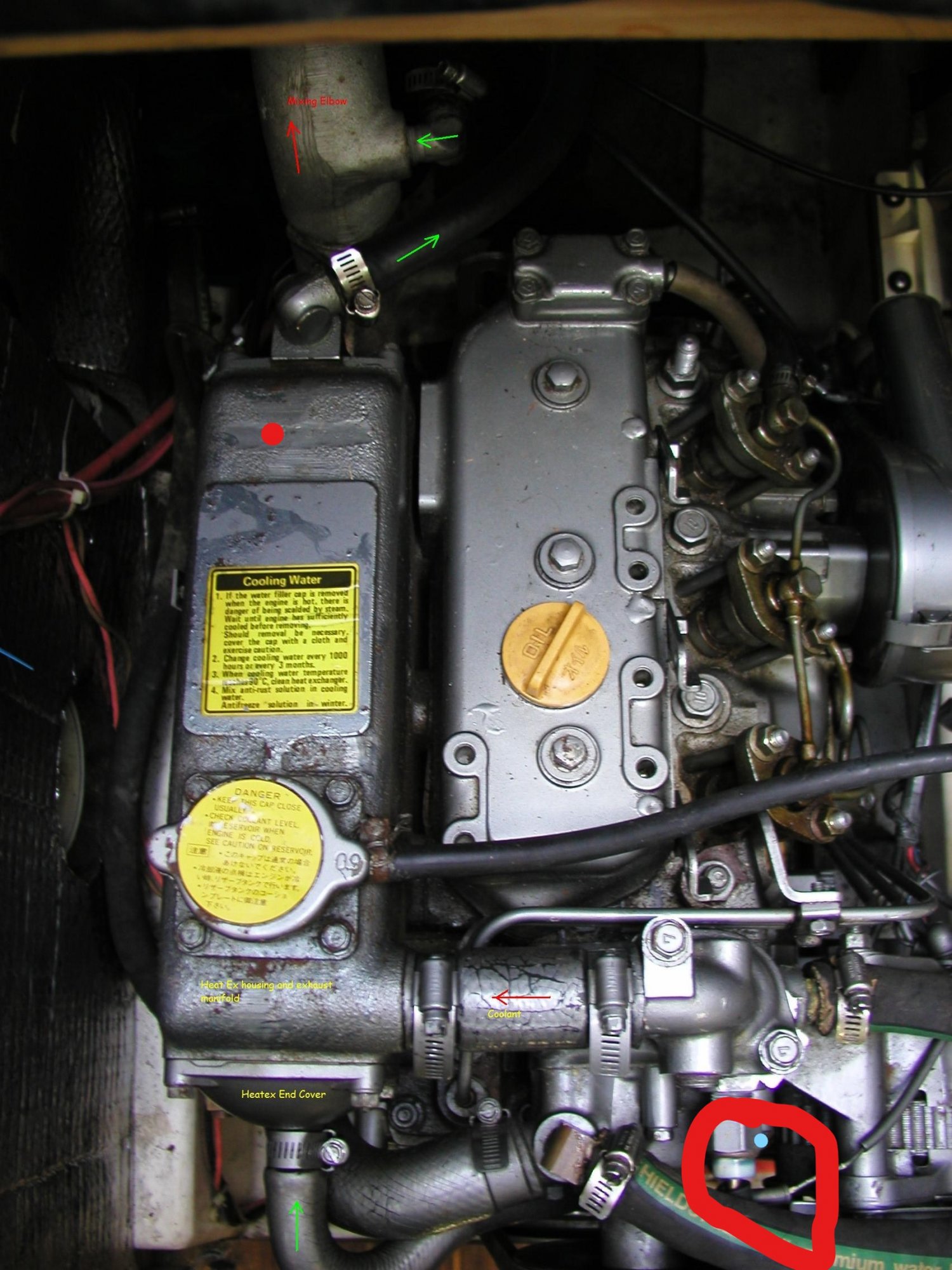

Attached is of a 3GMF, which is very similar to the 3HM . The red circle is around the temperature switch , on the thermostat housing. That wire should be a white with blue stripe.. You may have some kind of interconnect with the oil pressure wiring that is causing the annoyance. That wire is yellow with white and will be in the vicinity of the oil filter .. If you do not have an oil pressure buzzer, someone may have disconnected it and it may have come adrift and shorted with the temperature circuit. I have attached a wiring diagram showing the buzzer and what drives it.
