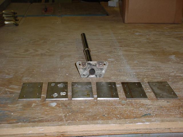

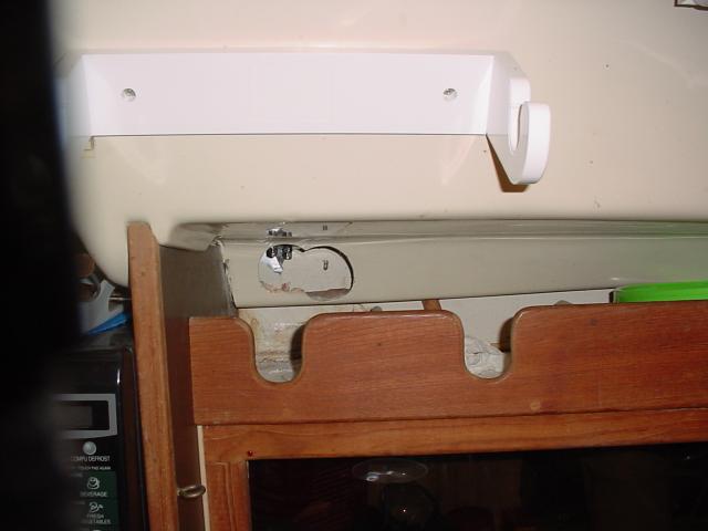

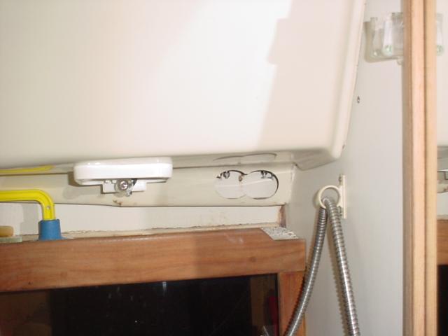

I had to cut holes after measuring very carefully and then getting a flex head ratchet.
The holes were made with a 2" hole saw and were perfect size to fit my new backing plates to replace the weenie washers Oday installed for the stanchion base's
