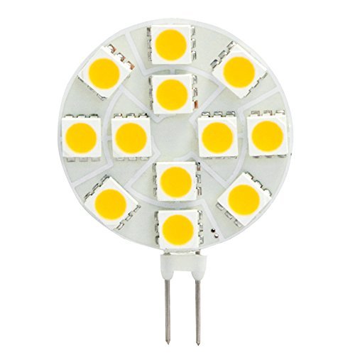

I like these disc-type, side pin LED equivalents.
If the original was xenon or halogen, presumably at higher wattage than the equivalent brightness LED, could LEDs possibly have a heat problem in a sealed lamp? Maybe not a fire hazard, but perhaps a life problem for the LED module itself?

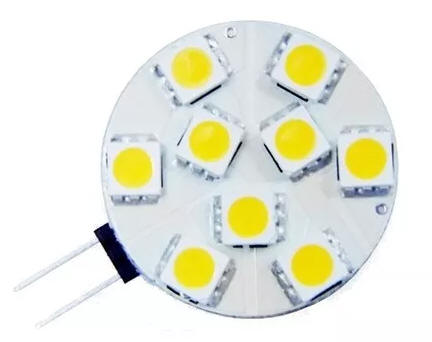

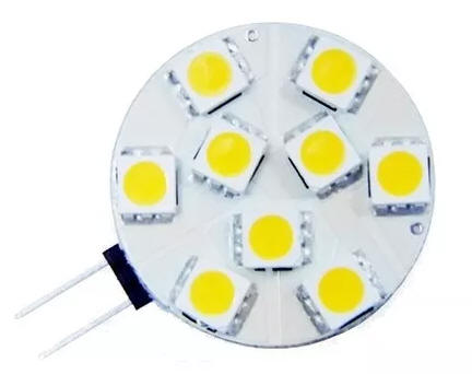

I replaced all halogen bulbs from my Beneteau M510 with 9 warm white 5050 LEDs like below, and I'm very happy:
10,244
Converted everything in the cabin to disk/side pin and festoon types, 8/9 years ago and have been happy with them. much less heat than the old incandescents and halogens.. They are warm to the touch but not hot like the old ones.. No failures to date. Still have a very bright fluorescent over the sink .. haven't found a suitable LED yet.
24,753
I converted to a red/warm white flood in the over the table and a warm white over the sink. Thinking of changing both to red/warm white.
Would not go back. They are not generating heat. And the light is excellent. Less glare than before with the incandescent bulbs.
