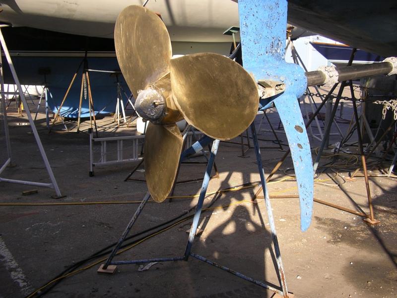

This is the explanation:
Very good. If it had come before the boat went in. I probably would have switched the nuts.
Reading between the lines, it doesn't make much difference unless the exact torque sequence is followed. My yard, like many, puts the small nut on top and just tightens everything up. They have never had a failure.
Next time, I'll do it this way.

Thanks Alexco...good article. Now how many people tighten the thin nut to the full torque? According to this you don't fully torque the thin nut and the elastic deformation of the threaded shaft clamps the two nuts together as well as the nuts to the flange of the prop. So MaineSail was right again, ah shucks, I thought we had him this time.

the why of using two nuts
Thanks Alexco...good article. Now how many people tighten the thin nut to the full torque? According to this you don't fully torque the thin nut and the elastic deformation of the threaded shaft clamps the two nuts together as well as the nuts to the flange of the prop. So Mainsail was right again, ah shucks, I thought we had him this time.
This has been a great discussion.
Hopefully a moderator class
participant (aka heavy weight
participant) will write up a summary
and post it where others who have
not been following discussion can
study it.
then it can be referred to by URL.
And maybe Roger can print out
copy or give his yard the web site
to enlighten and educate, simply
explaining the grief he took from
a picture of his strut...
Amazing what a picture can show.
