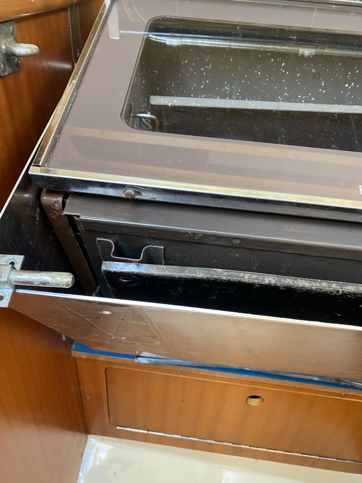

You can probably do all the work with the oven in place. They are a PITA to take out.
Ended up pretty easy to take out the oven.
There were 4 screws attaching it to the rig that swings it.
Can't replace much without taking it out.
Thanks for the advice.

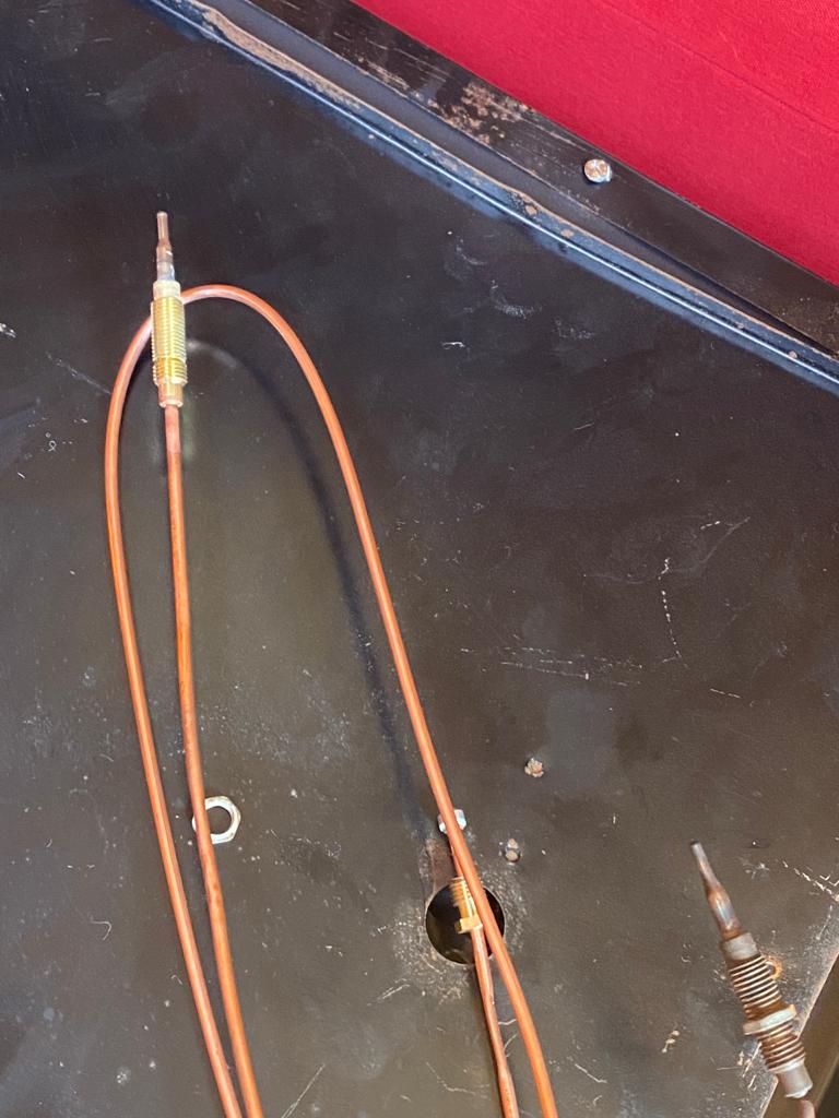

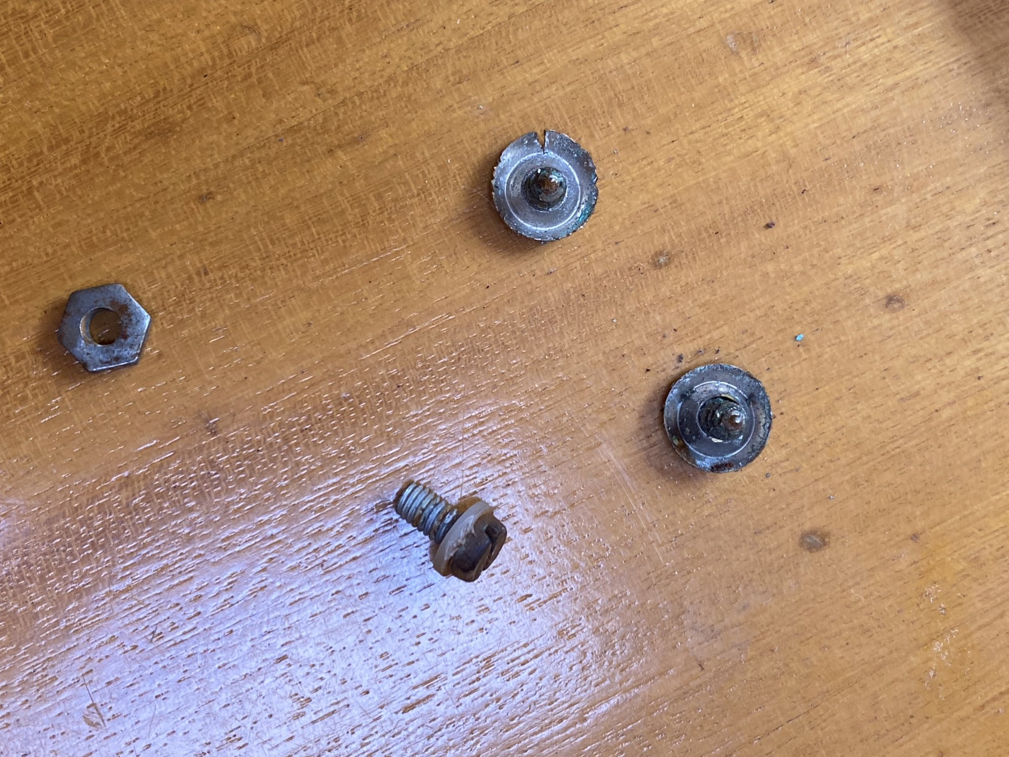

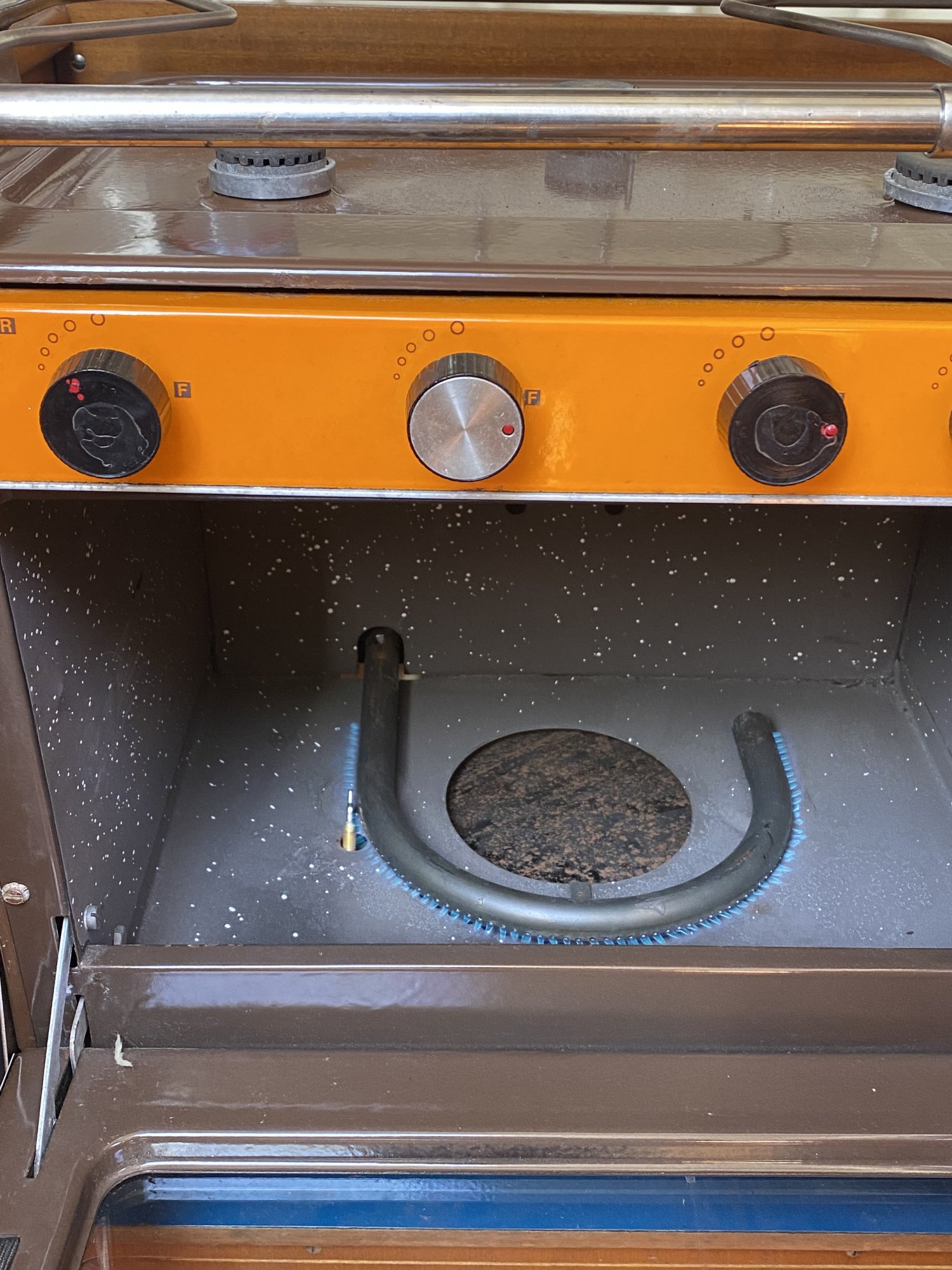

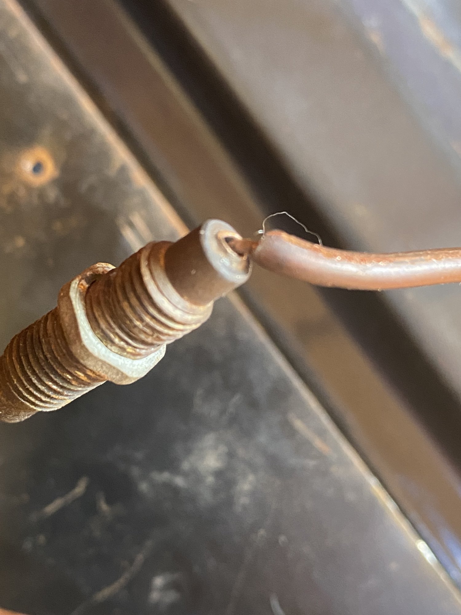

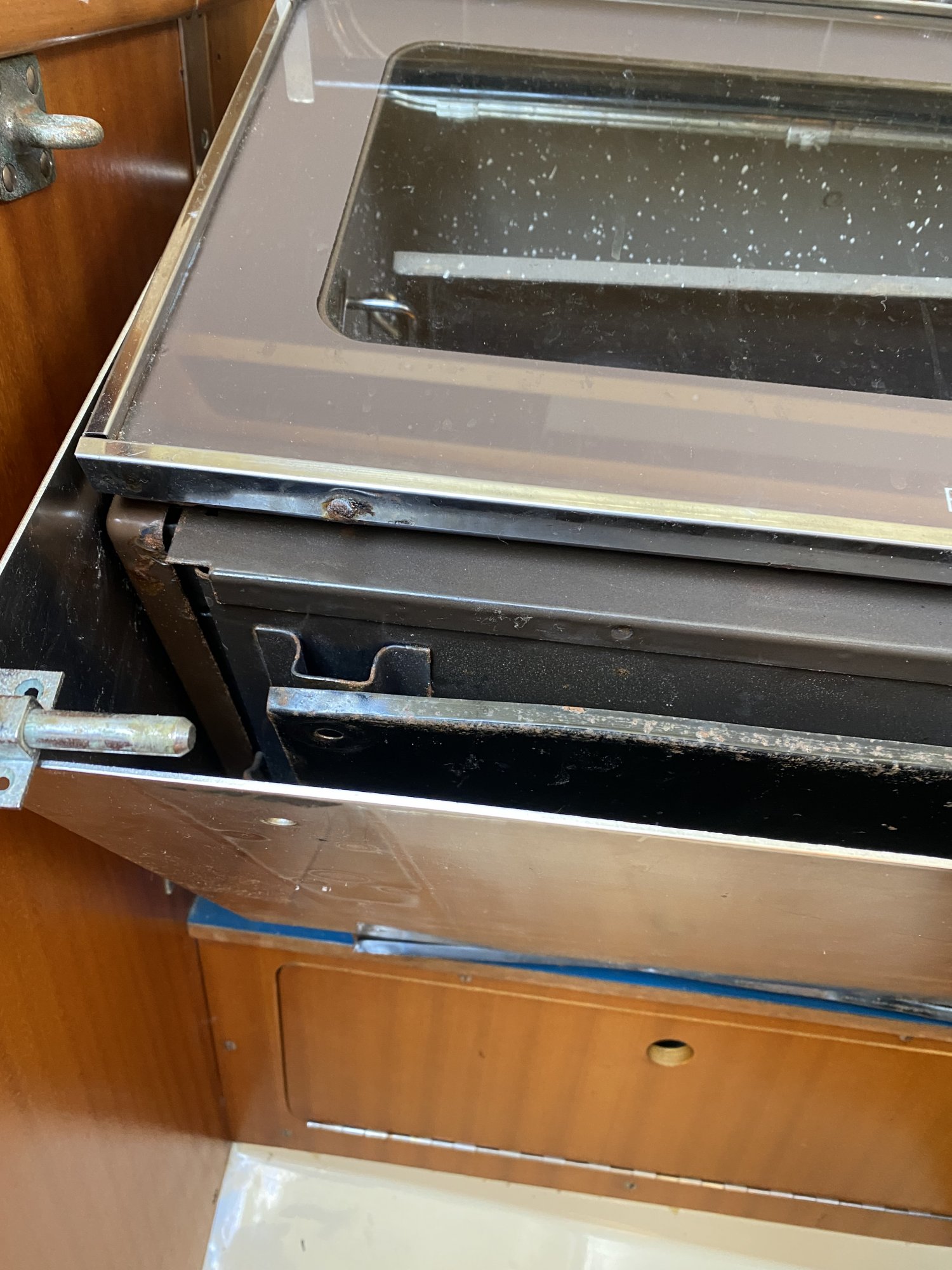

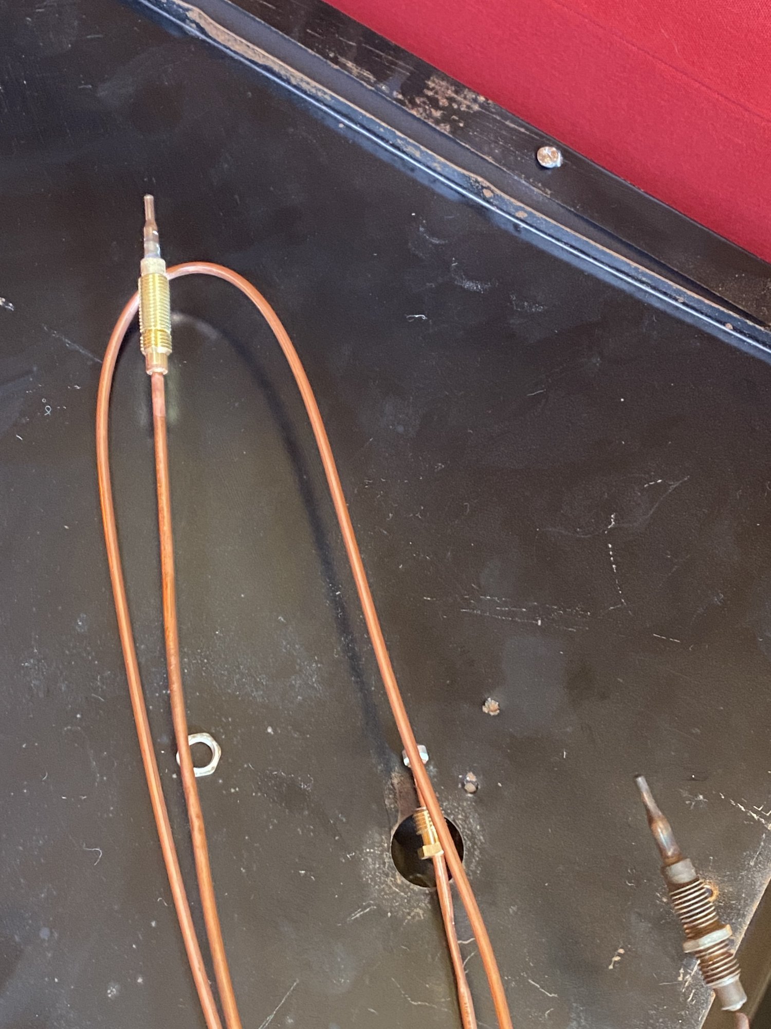

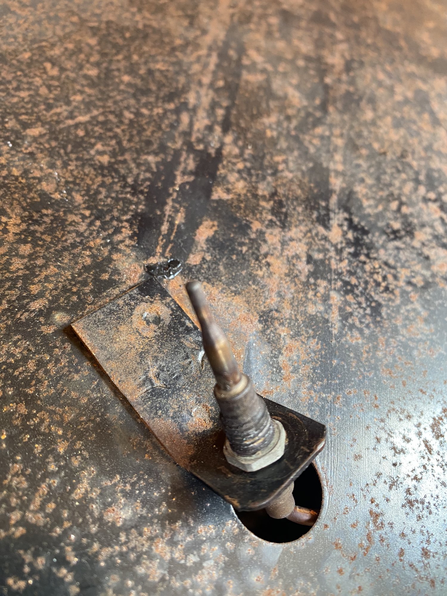

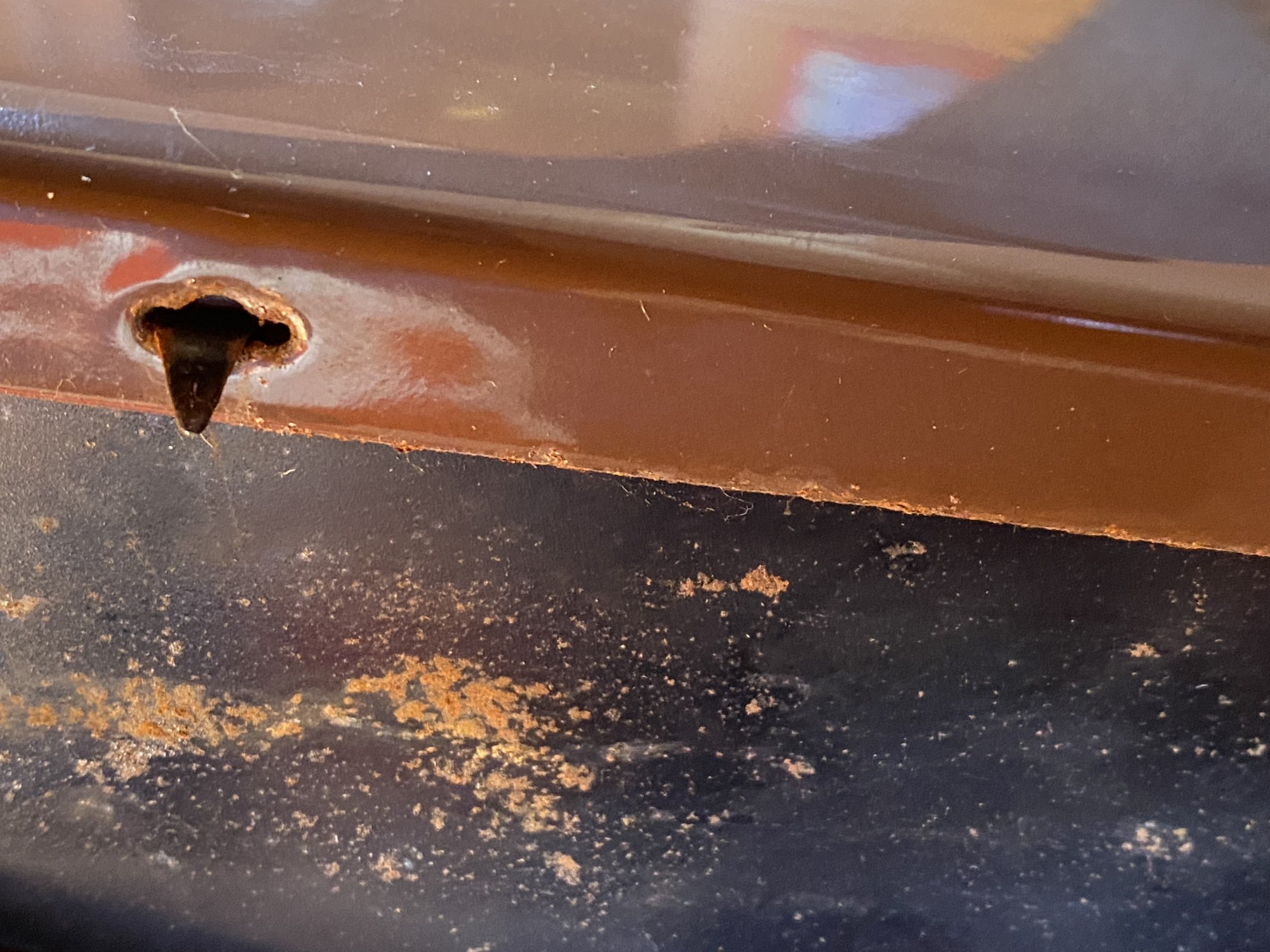

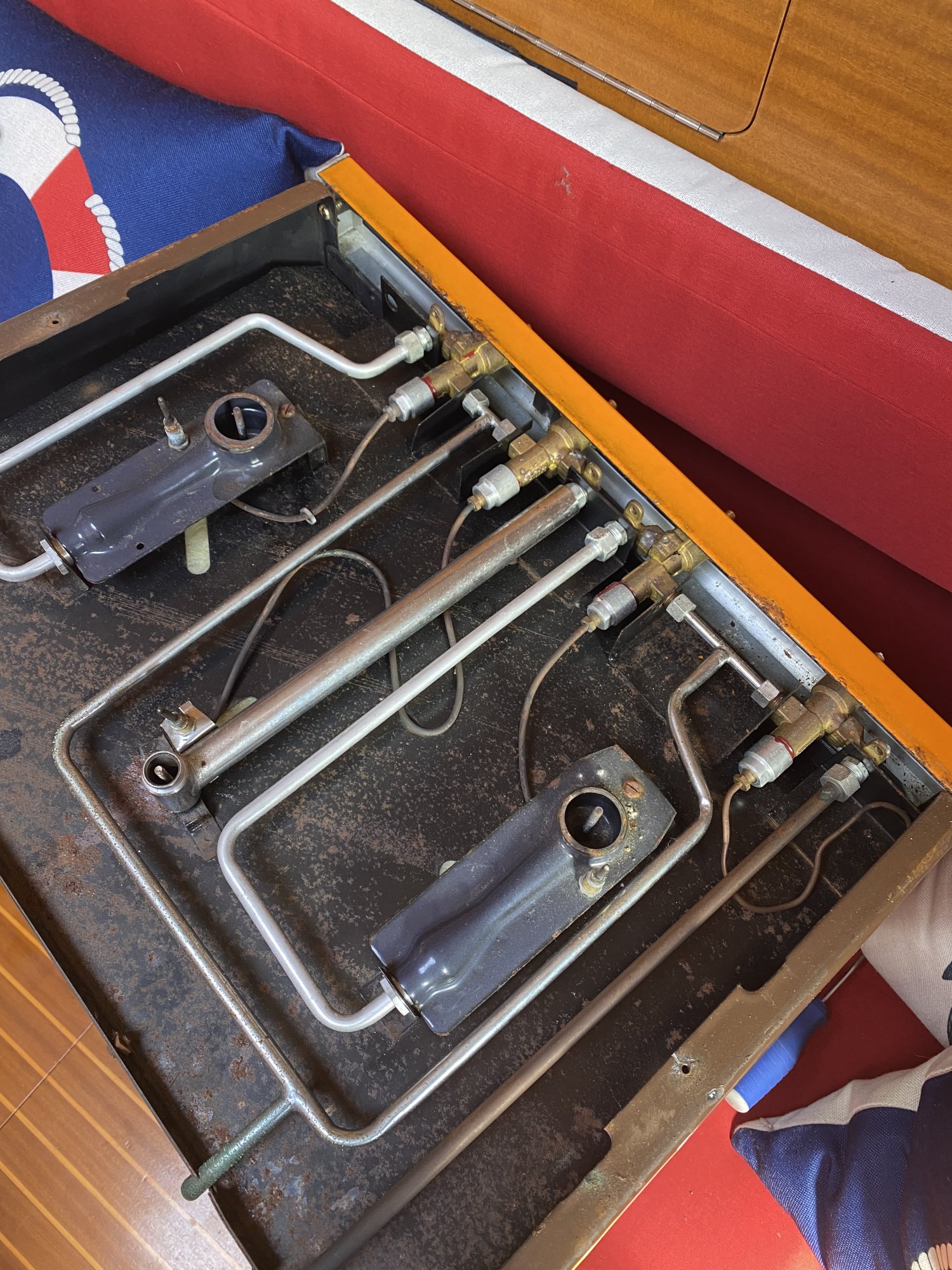

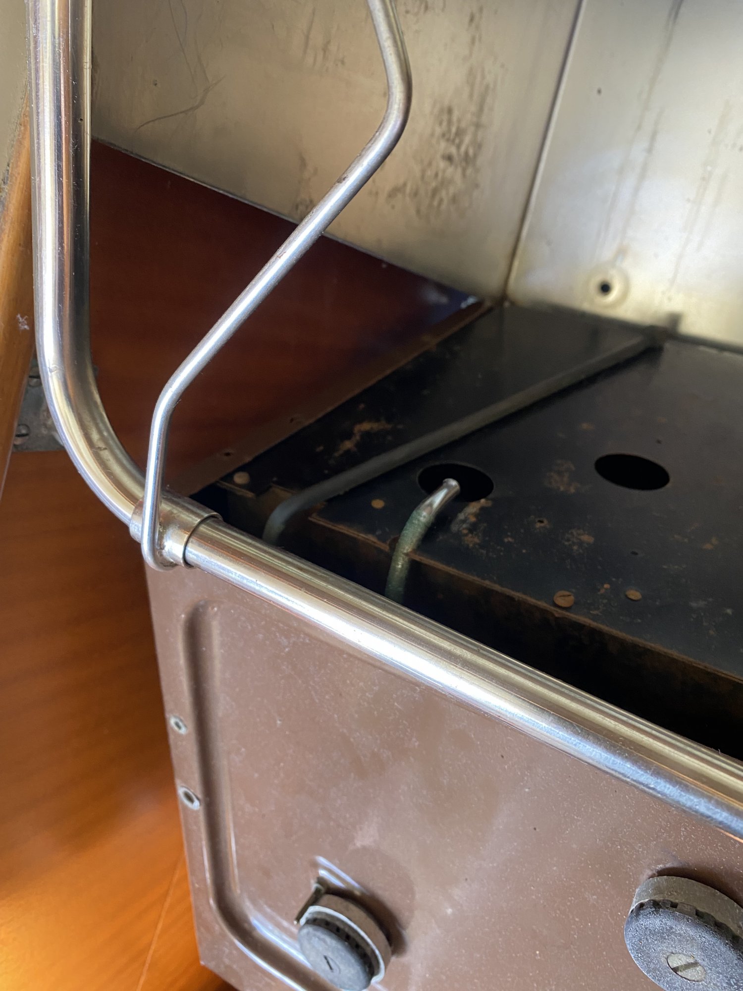

Hi All,
To sum up the post.
ENO 1975 ovens were bought by Force 10.
You can use the site SVB marine to buy Force 10 parts.
They also have a blowup which is super useful for getting an idea of how to take it apart.
The shipping is expensive but worth it.
I've attached the photos in case someone needs them to do the same.
I've tested it and you need to fidget with the height of the thermocouple.
I also needed to take out the sides to trace the metal as it goes from bottom to side to top.
I also took out the top to insert it into the front knob.
No battery, this is an old oven but it looks the color scheme of the boat
and now works like new.
Thanks a ton guys!
