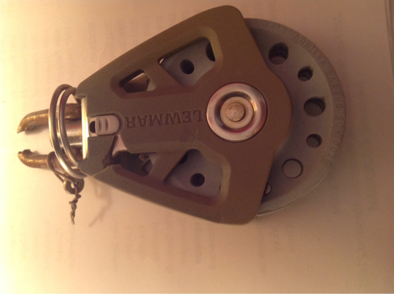

Okay, what is the "proper" amount of tension to put on my outhaul? I've always assumed that the foot of the sail has to remain reasonably parallel to the boom when I'm sailing in moderate winds. But this week I had the block at the mast foot explode its shackle. I tension with an electric winch. P.s. Lewmar was kind enough to send me a new block.
