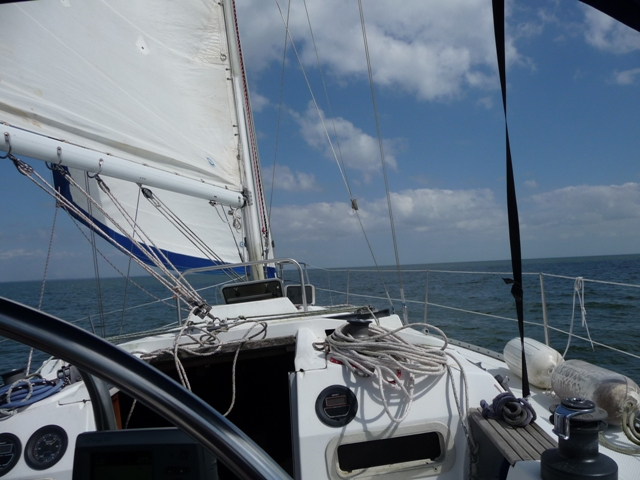

If you want to experience real sailing, head out by yourself across a major body of water, single handing, and don't take to task those who do, and don't give a rats a%^ about exact and proper sail trim.
I touched the outhaul exactly zero times on this trip:
http://www.rogerlongboats.com/2009August.htm
I do try to adjust it at least once a season when I put the sail on.
Proper sail shape certainly does make a difference in speed in racing and the psychological effect of knowing you are at maximum efficiency can contribute to the enjoyment of cruising. I'm in the camp though that doesn't think getting there a minute or two sooner is worth getting up to fiddle.
