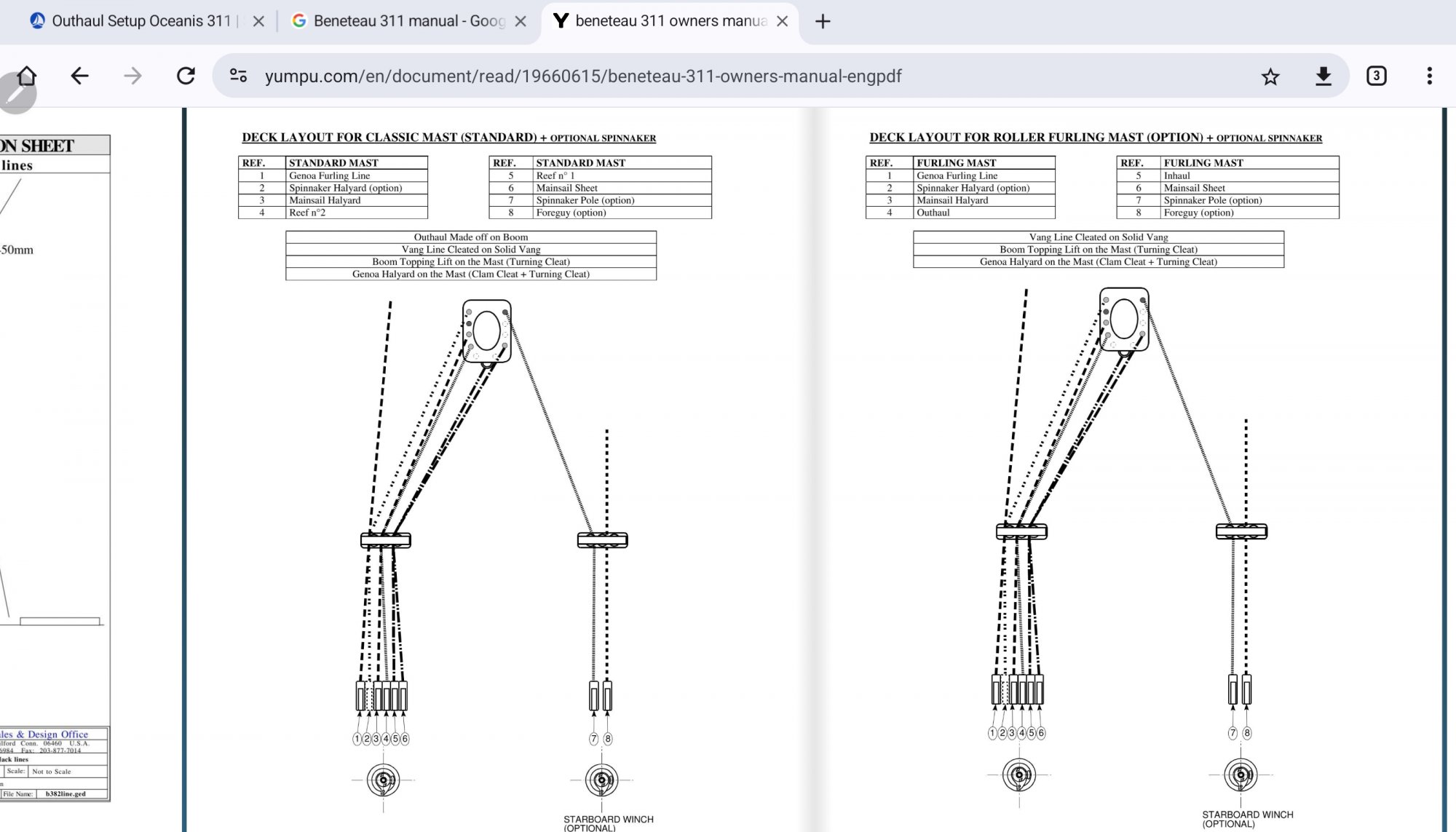

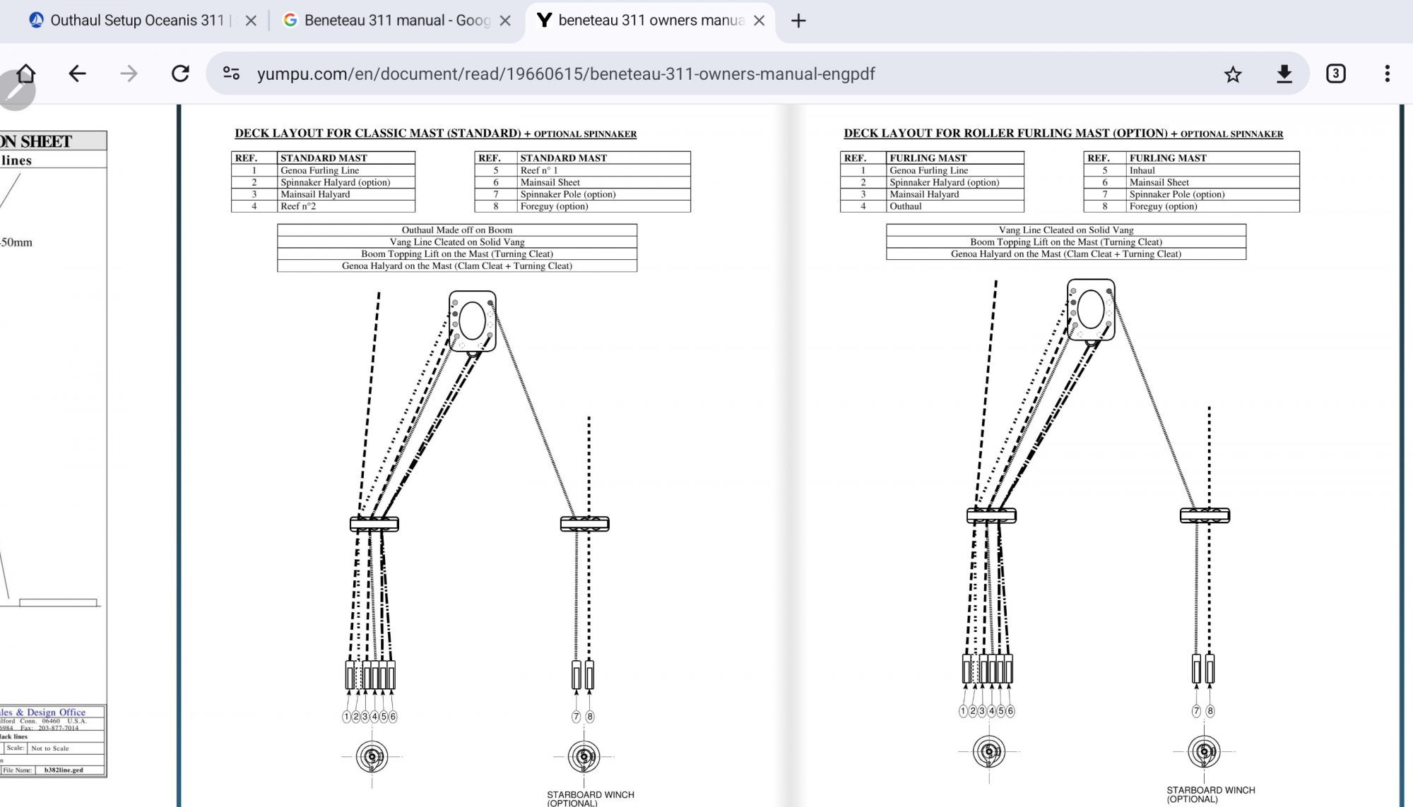

The owners manual shows the outhaul attached to the boom...
First of all, thank you very much for taking the time to try to help me with this and sharing the diagrams in the user manual. Checking the manual was the first thing I did to see if I could find the solution to my question. Unfortunately I can't see a solution to my question.
You say that the manual indicates that the outhaul is attached to the boom, but I can't see that? I simply see that in the configuration with only 5 stoppers (i.e. without any of the options) there is no reference to how to attach the outhaul.
Assuming it is attached to the boom, where is it supposed to be attached? Or how?
Best regards!
Jun 17, 2022
551
Hunter 380 Comox BC
It says "outhaul made off on boom", meaning cleated in the boom. Only your reef 1 and 2 would be routed to the deck organizer. Can you provide any photos of your boom?

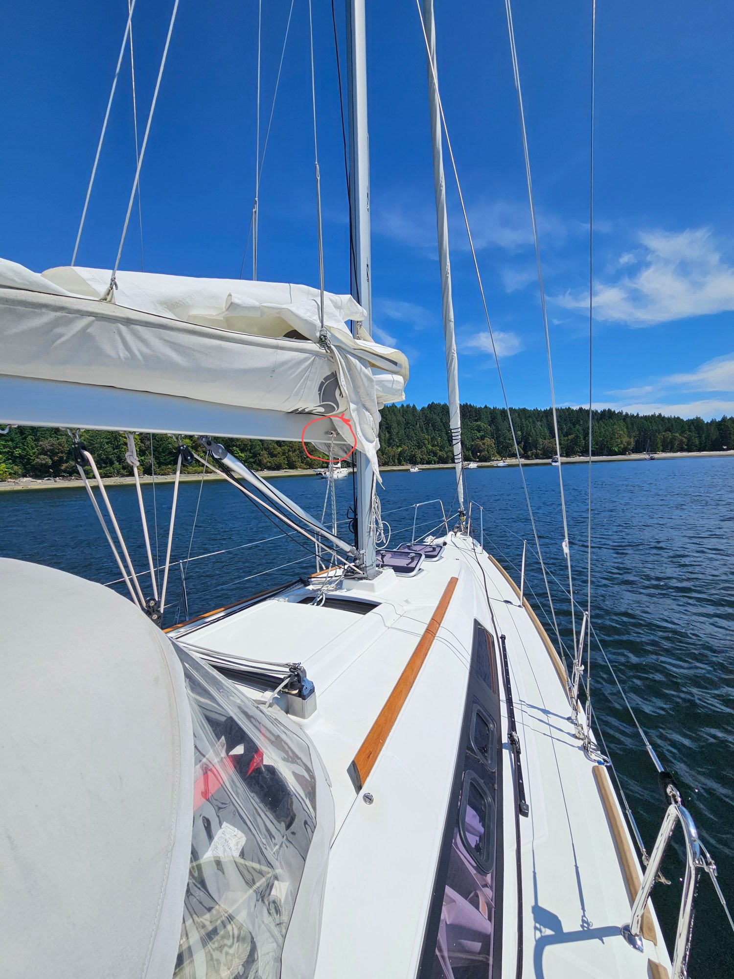

Here's our old oceanis 31, there was a cleat on the starboard side of the boom for the outhaul.

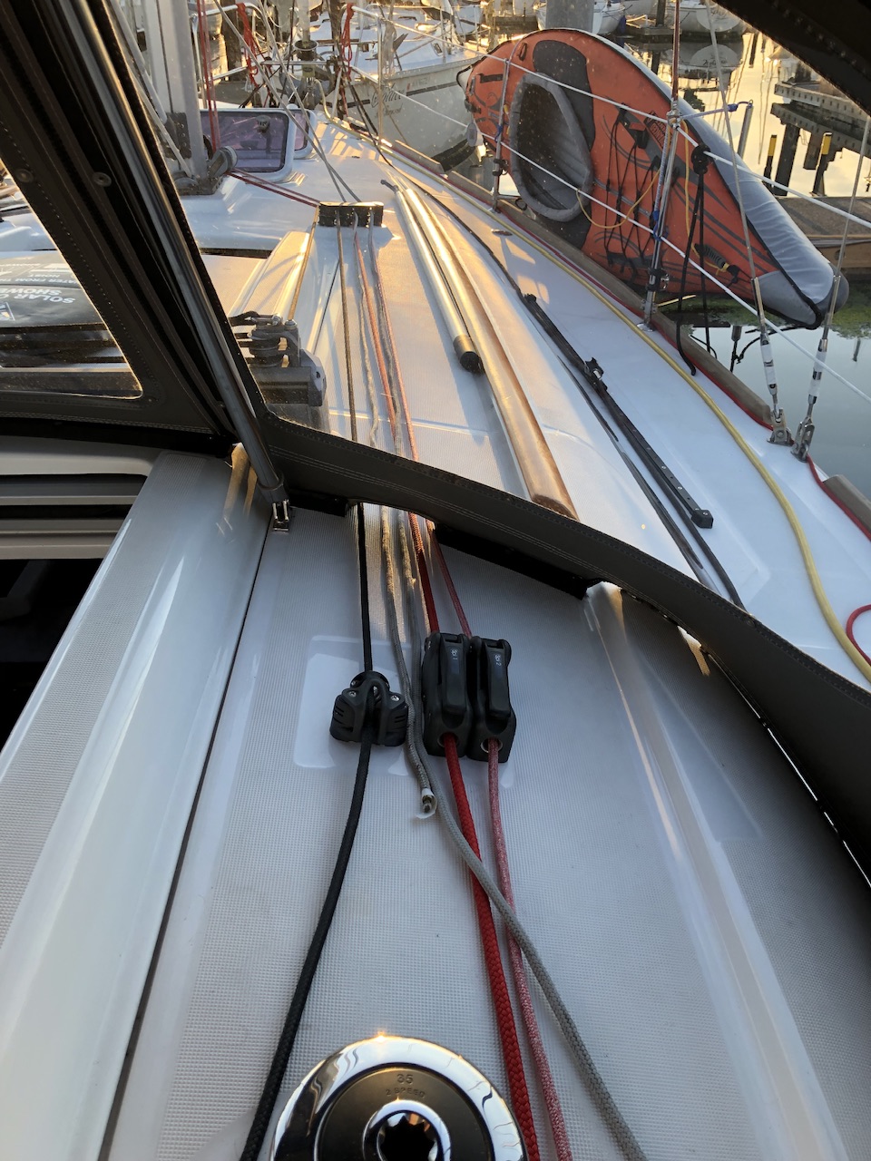

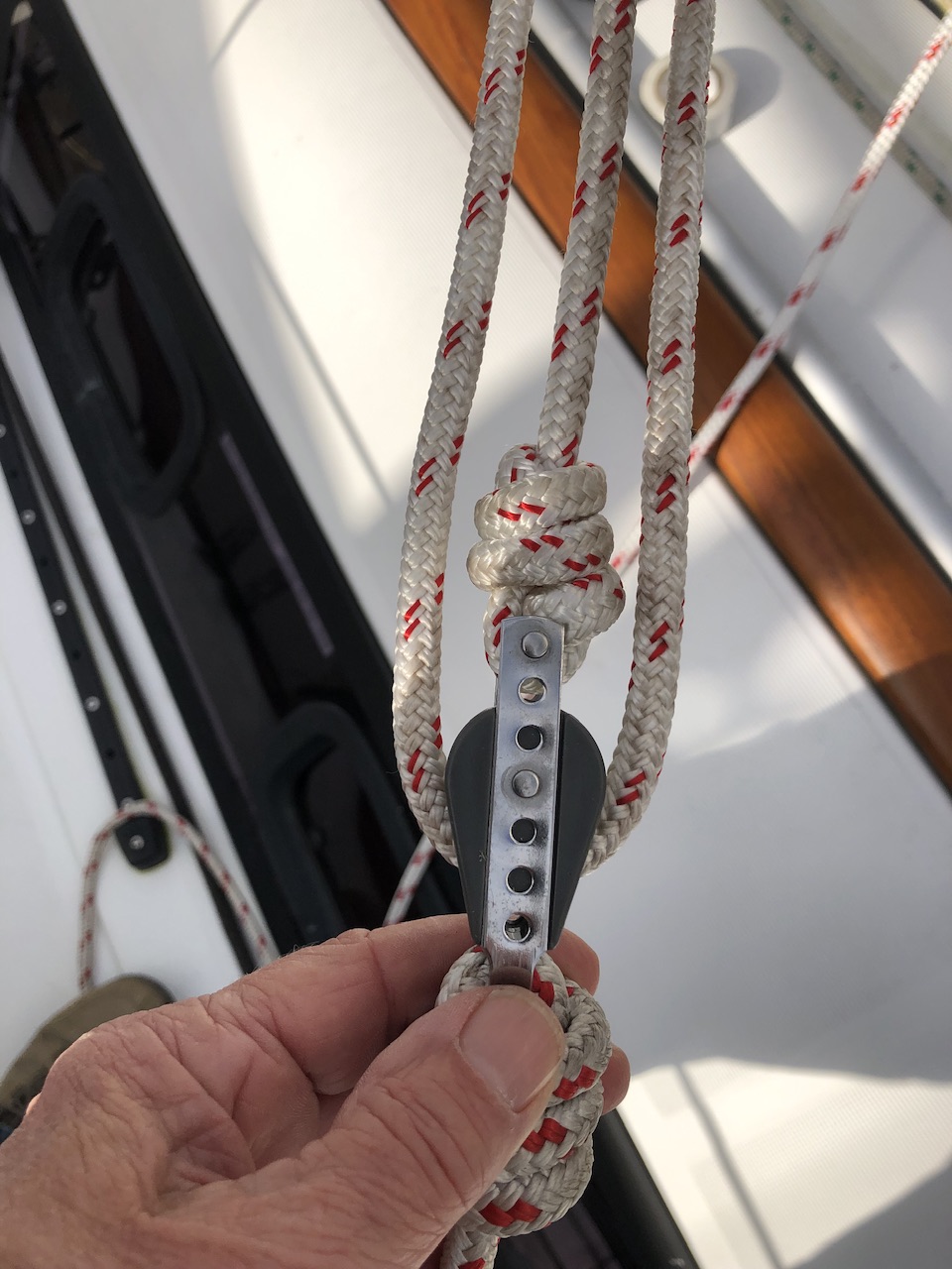

On my conventional rig, the there is a large aluminum cam at the forward end of the boom to grip the outhaul. The outhaul as originally installed had only enough length to make adjustments at the mast, then either secure the line on a cleat at the mast or tuck it into the sail bag. The aft end was secured with a bowline as @Davidasailor26 mentions.
One of my projects was to lengthen the outhaul, and to bring both the outhaul and the topping lift back to the cockpit. During that project, I found that the outhaul actually looped around sheave and a small block inside the boom and returned to the mast (I still worry about whether my knot will hold).
