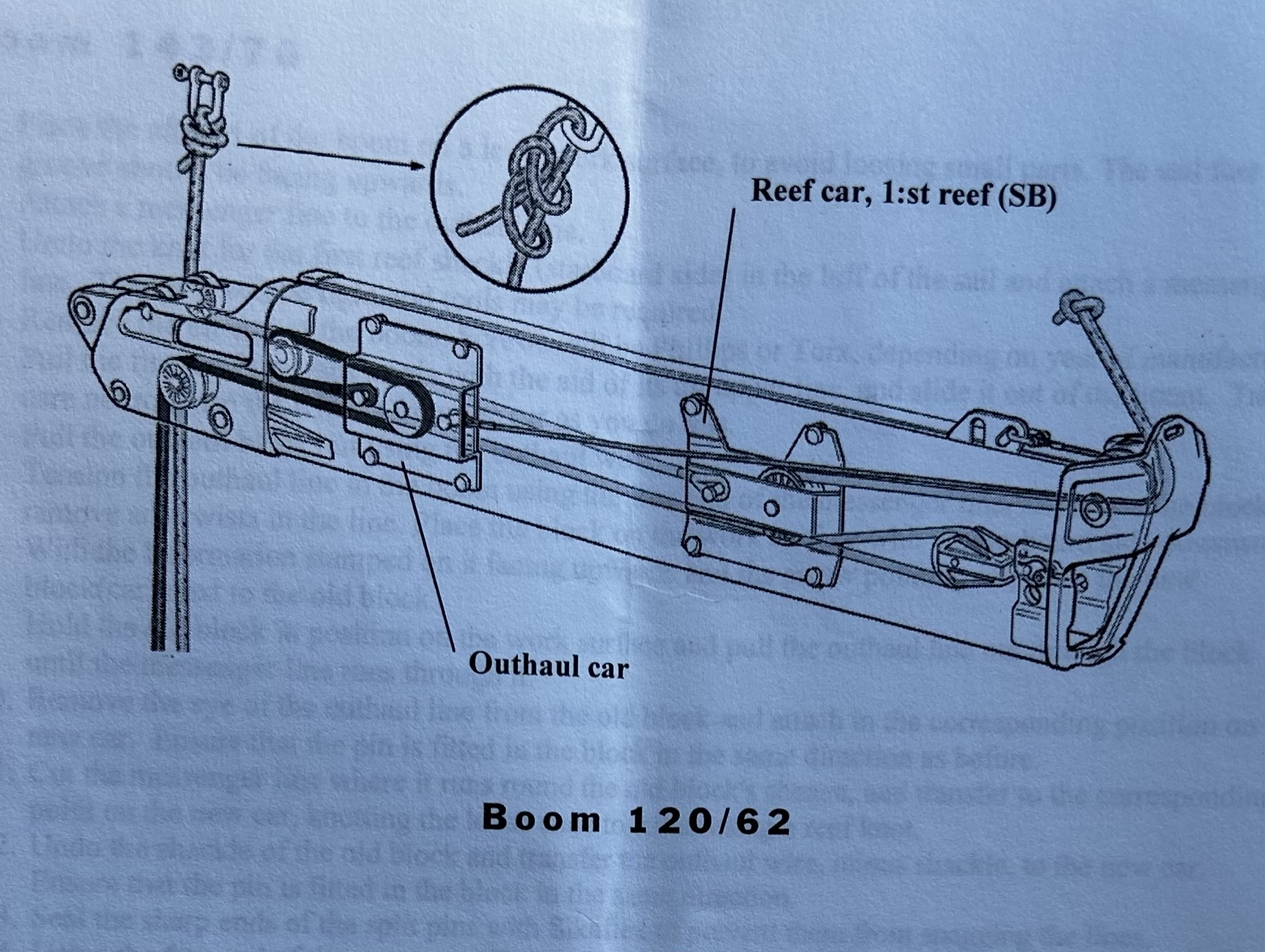

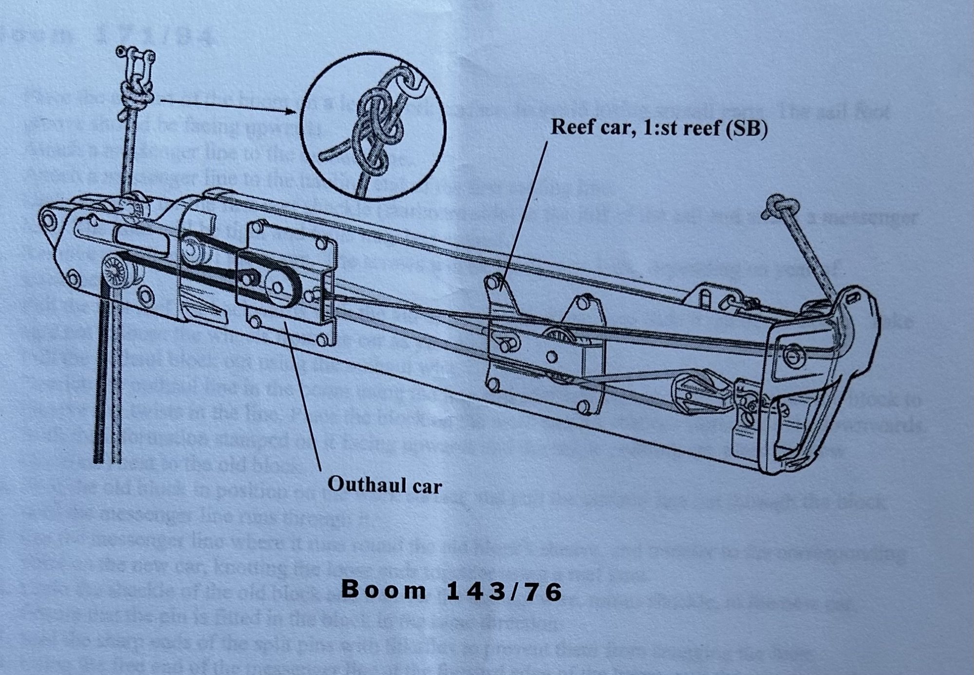

I was cleaning out my boat this morning of all the accumulation of books/information I have received. It piles ups in the oddest of areas.
I came across this booklet that came with my 2000 340 when I purchased it new in 2000.
I know this subject recently was posted and has been asked before and rather than trying to find those posts I thought I would put this out there for anyone who would like to have it as well.
It gives you a detailed look inside the boom and the workings.
