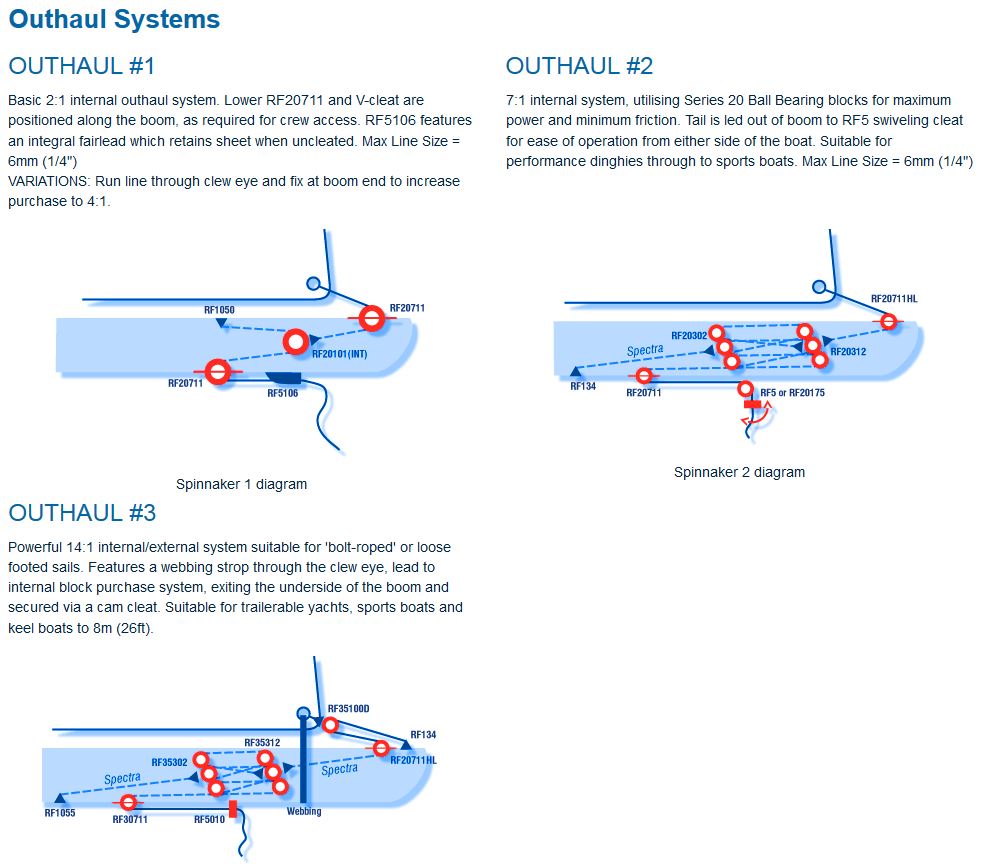

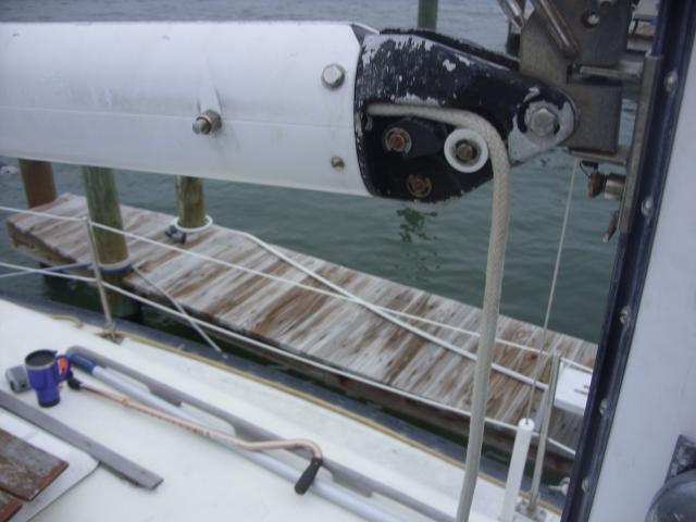

OK Jon, I'm brain dead today. You are exactly right. The wire coming out of the boom end does connect to the line running through the sheaves. And it looks like the pic. Can't seem to find a bigger version of it. Hope you can enlarge. The bolt on the left goes through the boom. The wire to the right goes to the sail. The line (rope) to the left is your adjustment line that exits at the front end of the boom. So, you will have to remove the boom and remove at least one end and the bolt to re-rig the assembly.

Yes! That’s it! Thank you, thank you. I was scratching my head on how to access it. I had the end cap off but couldn’t see an attachment point for the line so it must be at the mast end. Perfect!

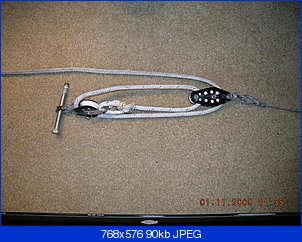

Keep reading. I added more pics. Oh, and for continuity, turn the assembly pic on the left to reverse image. That will match the goose neck pic.

Yep! Exactly what mine looks like. I almost had the boom off at the mast end last week but second guessed myself and thought I should ask someone with experience first. This has been really helpful and affirming of how I thought it could work. Thank you again, mystery solved!
