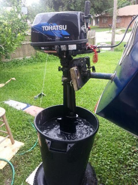

First trip with the Nissan 6hp 25" shaft on the oday 22 at WOT I got good speed (6.2 knots) but the bow was higher than I thought it should be. We had 2 adults in the back and the motor was trimmed to 90* (based on how it looked while trailered). My motor mount cants back, maybe 12*-15* or so. To get the motor to 90* I had to go up 5 or 6 notches, which seemed like a lot.
With the bow raised it appeared I needed to lower the trim a bit, so I went down one notch with no noticeable difference. Circumstances prevented me from trying other settings.
It occurred to me that with the 25" shaft the prop is about 5" below the bottom of the hull and this may be causing the lifted bow due to the leverage achieved by this distance. I imagine a 10' shaft then pushing on the prop, the bow will raise pretty much regardless of the trim angle. If I trim all the way down the thrust will be pushing down quite a bit which seems wasteful. I could raise the motor 5" which would put the center of the prop right at the bottom of the hull.
