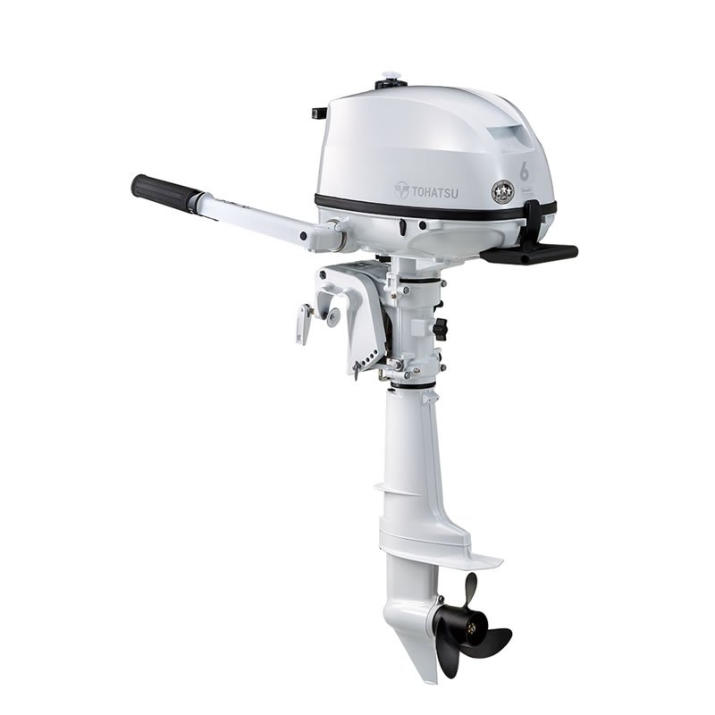

As I understand it, the Lehr's are basically Tohatsu motors modified to run off propane. Parts for a 5 hp 4 stroke Tohatsu may fit, except for the carbonation system. Ask your mechanic to cross reference or do some more research on your own.
A 6 to 8 hp 4 stroke will be perfect for your boat. My old Tanzer 22 had a 6 hp 2 stroke and I was never at a want for power.
