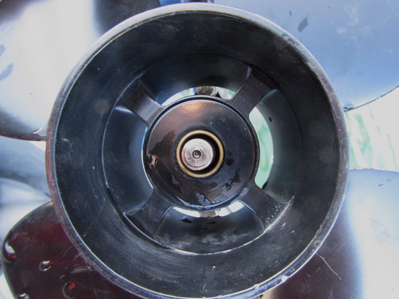

FYI, my outboard has through the hub exhaust so I see bubble at almost all speeds - its the exhaust.
I swapped the props back to what I originally had (3 blade 8 pitch) today. Before I took that high thrust prop off, I took this picture and you can see light coming in from the back side. This allows the exhaust to exit out the back end in reverse.

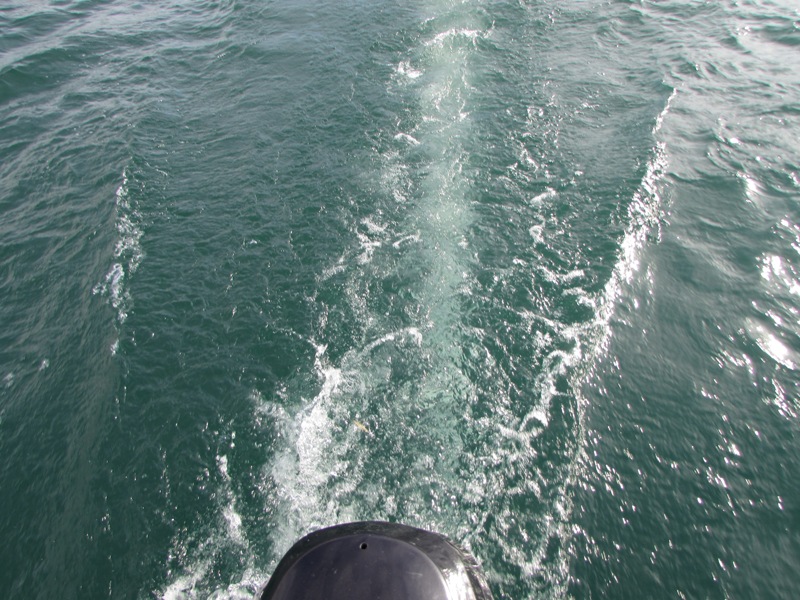

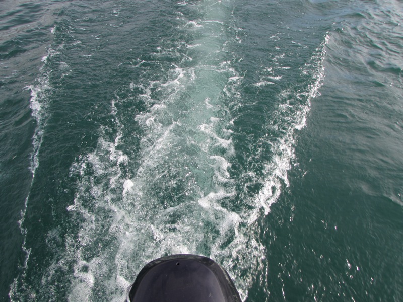

Yesterday I took some pictures of the prop wash (and thanks again for making it so nice to post pictures here!!) These pictures are for the three blade 8 pitch prop but the four blade 5 pitch prop looked and felt similar (just with a lot more noise and vibration on the boat for the same speed).
The picture below is the prop wash at about 3.5 mph (3 knots). You can see the thrust exiting the back of the prop but you can also see a bubble stream from the through the hub exhaust.
The picture below is at wide open throttle doing mid 7's mph range and up againts the hull speed limit curve. You can see more output - since its higher rpm/ thrust and also see the bubbles - which once again I think are just the through the hub exhaust.
