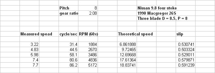

This boat has a water line of 23.5 feet. The equation for theoretical hull speed (knots = 1.34*(LWL)**.5 says this boat has a theoretical hull speed of 6.495 knots.

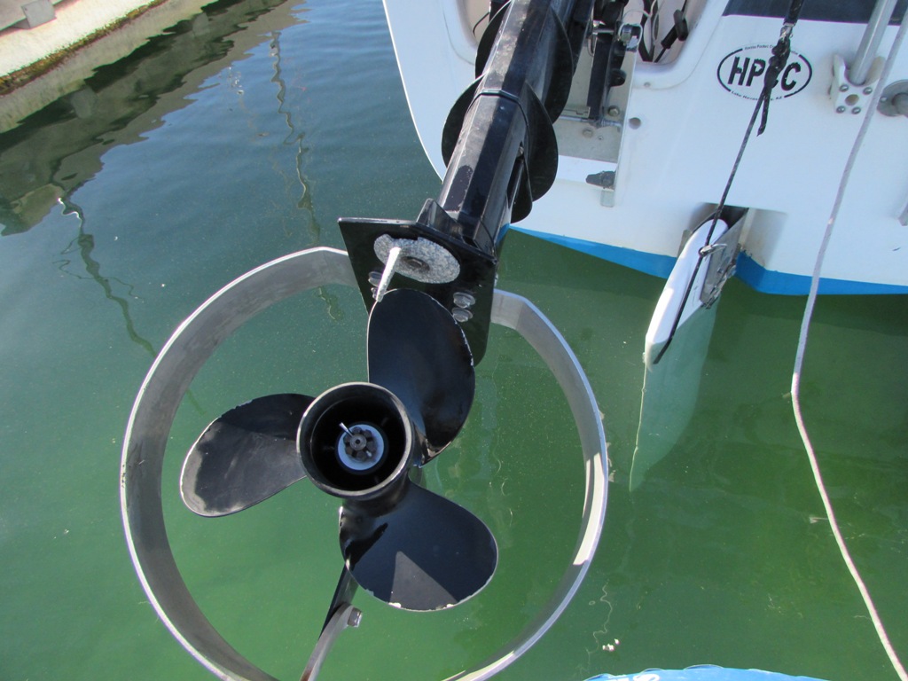

FYI, my outboard has through the hub exhaust so I see bubble at almost all speeds - its the exhaust.

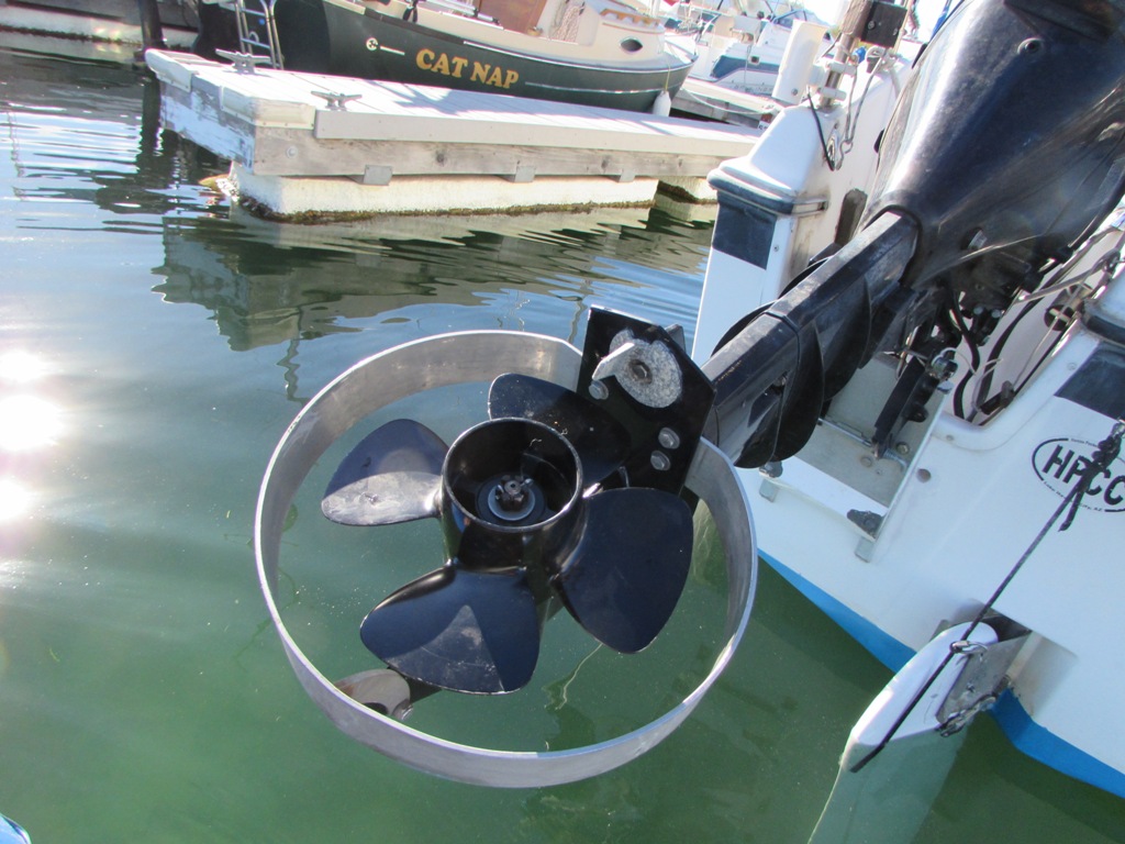

I swapped the props back to what I originally had (3 blade 8 pitch) today. Before I took that high thrust prop off, I took this picture and you can see light coming in from the back side. This allows the exhaust to exit out the back end in reverse.

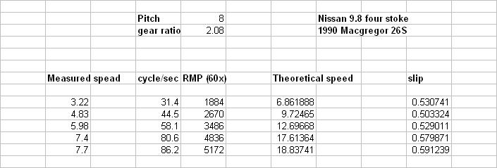

Regarding the use of the term "displacement hull" for the 1990 Macgregor 26S (this is the old style Mac - before the power sailboats), I didnt look up the exact definition of displacement hull but I put a close to 10 hp outboard at 450 ft elevation wide open throttle and achieved a speed 3% higher than the theoretical hull speed number from the equation. I believe that puts it right in the ballpark of operating where the wave making causes a the curve of speed vs drag to get steep. I thought that would be called operating in displacement mode.. could be wrong. Noted that all this data is specifically for a 1990 Mac 26S and not necessarily for any displacement hull
Another point was brought up that Ive heard elsewhere on the internet. With a prop, you can have a condition of ventilation or cavitation that will limit the thrust. Ventilation is air getting sucked down from the surface and I can get this to occur by doing a very sharp turn in choppy conditions with the outboard on the high side of the boat during the turn - prop gets near the water surface. When the prop ventilates, there is a very ABRUPT loss of thrust and with the loss of thrust comes an increase in RPM - since the torque on the prop just dropped way off. Ventilation was absolutely not occurring for the data I took. You can also see this in the data, there are no abrupt changes in rpm for any data points.
So another question is "do these under 10 hp outboard props cavitate". I have convinced myself that neither of the two props I tested in this thread have any issue at all with cavitation. Cavitation occurs where you are really stressing pressure boundaries and it seems to me that for our small under 10 hp outboards, we are just not operating with enough HP for this to occur..
Also, it seems to me that the onset of cavitation would result in a loss of blade lift and a resulting loss of torque to the motor. So at the onset of cavitation, you would feel a loss of speed (or no more speed) and also a "non linear" change (increase) in prop rpm.
I took the Mac 26S out yesterday and ran the outboard a bunch (also sailed a bunch) trying to note any indication of something resembling cavitation. This is with the three blade 8 pitch prop and I just don't think there is any cavitation going on that I can either see or feel. Also please take a look at the data and curves early in this thread. The speed vs rpm curves are smooth. I think cavitatation would have caused an obvious discontinuity in the curves - but there isn't any.

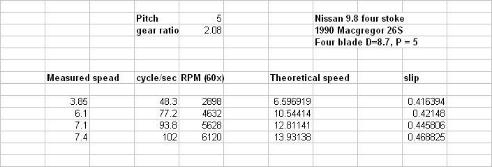

For my case, the three blade 8 pitch and the four blade 5 pitch both take about 9 or 10 seconds to take the Mac 26S from 0 to 6 knots. If you want to call this "hole shot", I could not tell much difference. I started to do #4 (reverse test) but that four blade prop is so much better in reverse that it started to damage my outboard reverse hold down mechanism so I stopped that test. No doubt at all that the four blade prop with the symmetrical blades and large hub is WAY better in reverse. The three blade 8 pitch prop had a higher peak speed which probably doesn't matter unless you did a real bad job of timing tides and get stuck in some bad current and even then the very small percent different in peak speed probably isn't significant. My perceived problem is to keep noise and vibration down and the three blade 8 pitch prop is way better for this - so that is what went back on the boat.
I didnt measure and compare fuel consumption with either prop but I would guess that the three blade 8 pitch is slightly better and the only reason I have is that it just looks like its more efficient in forward - plus operates at about 1K lower RPM.
