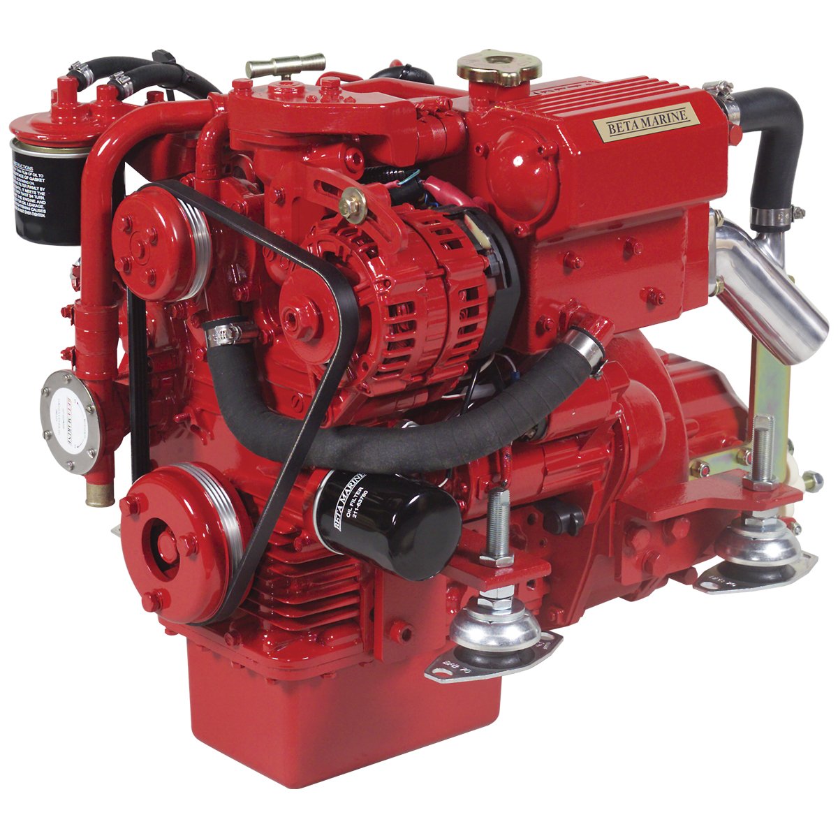

A far better option would be to spend the money to install a 20 hp Beta Diesel.

My brother just put a brand new beta in his boat. It was a bigger motor as he has a bigger boat so your cost would be less. He had it professionally installed as he is not a DIYer. Total cost was just under $18k. That did not include a prop as his was fine and sized well for the new engine. Lucky him. That did include rebuilding the engine bed and some other goodies. Don’t recall all the details. I will say having it done professionally is a good way to go unless you have experience doing this. There were some tricky alignment issues that came up that the installer totally had under control.

If the old engine is an Atomic 4 and it can't not be economically repaired, the Beta 16 drop in replacement is the motor you'll want.
Give Beta a call and talk to them. The total cost will be somewhere around $10K depending on options and how much work you do yourself.

I’d say @dlochner is just about spot on. Given what my brother had done, the almost double engine size from the 16, $10k is a good ball park number. I’ll add in that beta is really nice! The way beta has everything set up for access to filters and everything you need to maintain that engine later is really well thought out. Plus they are darned quiet, smooth and powerful!

We replaced an OEM Universal 23 hp diesel in 2018. With some outside (expert) labor from a ship wright the total bill was about 15K for an optioned-out Beta25. Wonderful and quiet engine with ample power. I did all of the clean up of the engine bay and installed new ancillary parts like the fuel system.
A Betamarine twin or their 20 hp would be plenty for that boat.
