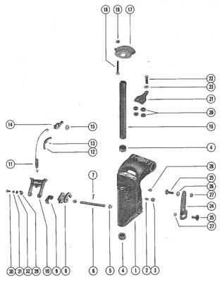

Sounds like your swivel pressure plate has become corroded or is otherwise sticking.. See the attached picture. I believe #22 is the adjusting bolt. You should be able to loosen it up and get the engine to turn. Then just give it a good cleaning and lube.
Cheers,
Brad
