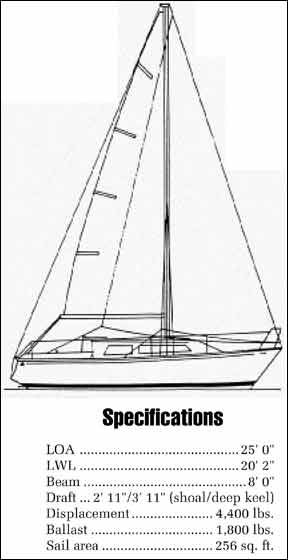

Hi,
I have a Hunter 25, currently having a 9.8 Tohatshu, 20ft shaft.
Want to get a new Mercury or Tohatshu, and looking at 9.9, 15, and 20HP.
The new models have fuel injection, vs carburetor.
Wondering if it is necessary to go to 20HP.
Planning on taking the boat to the gulfstream

On a sailboat, more power is not necessarily a good thing. Sailboats are displacement hulls and have a hull speed, a speed that can not be exceeded. A second factor to consider is weight, especially in older outboard sailboats. When these boats were designed and built most outboards were 2 stroke and much lighter. The transoms and motor mounts are not designed to handle heavy motors. The weight of the motor will also affect the boat's trim.
Anything over 9.9 hp is a waste of money and may be damaging to your boat due to weight and torque. No matter how much power you put to the boat it will not exceed about 6 knots in flat water.
Save your money, go with the motor you have.
BTW, I suspect you have a 20 inch shaft, not a 20 foot shaft. ;)

"hull speed" is a term that is real and good to understand. it has nothing to do with 'max speed' of a vessel. some people get confused that hull speed implies max speed, it does not. hull speed applies to all vessels both old and new. to say it is mysterious is wrong. to say it does not apply is incorrect. to say it is the 'max' speed of a vessel is incorrect.
a skilled captain should fully understand hull speed. the captain can apply this knowledge to sailing the vessel.
it's just science and the facts are still the same and apply to our vessels.
that said, putting a larger HP outboard on an 40, something, year old hunter 25 is a poor choice for many reasons! now that's an opinion. and it's free.
7,270
Since the naval architects of yore tried to figure out how fast a big fat merchant ship or a warship could sail and developed a formula for the theoretical hull speed of a vessel, much knowledge has been gained and insight into the factors that limit the speed of displacement hulls. And, make no mistake about it, most of our boats are displacement hulls although under certain conditions they can surf down waves, they do not plane in the same way a sport boat or a speedboat plane.
The age old formula of 1.34 times the square root of the waterline length is for the most part a reasonably accurate estimate. If the formula yields a hull speed of 6 knots, the boat in question might indeed exceed 6 knots for a variety of reasons, chief among them is wave making resistance. However, it will only exceed the theoretical hull speed by a relatively small amount, at best a knot or so.
To dismiss the notion of hull speed and adovacate for excessively large, powerful, and heavy motors does no one a service. A 20 hp motor will not power a boat significantly above that theoretical hull speed (however you calculate it) than a 6 or 8 HP motor. My last boat, a 30 ft 8,000lb boat had a 13 horse motor and did just fine pushing the boat pushing it to 6.5 knots. My current boat a 36 ft 15,000 lb boat does just fine with a 33 hp motor.
The idea that more horsepower is needed to counter an adverse current is simply erroneous. Speed through water is all the boat knows and it doesn't matter which way the current is moving. If the current is 3 knots and adverse and the boat can only make 6 knots through the water, then speed over ground will be 3 knots regardless of how much horsepower the boat has.
As sea states get larger, horsepower becomes somewhat less important. Once the seas are greater than about 2 feet, driving into them is sort of like driving into a brick wall, by the time they are 4 or 5 feet hitting them head on with lots of power will result in a bone jarring experience. That's why we slow down and quarter waves. If the waves are big and there is breeze, it will be much faster, safer, and more comfortable to sail.
So, @mohi700 save some money, get a 8 hp long shaft outboard. Put the rest of the money in your rigging and sails to make sure they are up to the task of sailing in or crossing the Gulf Stream.

Thanks for all your feedback. Very informative. Most sailors here are of the opinion that HP not not of a factor for a sailboat. Even the owners manual states to limit to under 10HP.
I am not sure if I trust the hull speed formula. I have my 25 ft boat and have done 8.5 knots, which is way above the hull speed. This was with only motor power and jib sail ( without mainsail).
However, my main reason to upgrade is not so much for speed, but power to counter adverse conditions such as combo of wind and current. Especially, under circumstances, when extra sailing is not desired.
These days the 2021 model 20 HP weighs almost the same as the older 9.8 HP. So weigh is not much of an issue.

The Mac 26 was designed specifically to have a 50 HP outboard and to be able to function as powerboat as well as a sailboat. Making comparisons between your boat and the Mac 26 is not appropriate. The hull forms are significantly different.
While I don't doubt that your knot meter read 8.5, I'm not certain that 1) it was properly calibrated, 2) that if calibrated it was calibrated to nautical miles per hour or statue miles per hour, and 3) depending on the location of the knot meter impeller there can be significant differences in readings even though the boat is moving through the water at the same speed.
There is a rather substantial difference between the two as a Nautical Mile is 6080 feet and a Statue (land) Mile is 5280 feet. Do the math, 6.5 knots plus 15% yields ~7.5 mph.
The speed of the water flow over different parts of the hull varies based on the shape of the hull and point of sail. Faster moving water helps to create lift which helps to sail faster to windward. It is quite typical for knot meters to read higher on one tack than the other.
Increasing power will not help you combat current. Your boat has a maximum speed through the water. Let's assume your max speed is 5 knots, if there is a 6 knot current flowing directly against you, the boat will move through the water at 5 knots but will move backwards relative to the bottom or land at 1 knot.
Windage can be a bit of an issue, however, in most cases where wind is an issue, say above 20 knots, there will be correspondingly high waves and chop. It is counter productive and damaging to the boat to pound through a significant chop with too much power.
There is lots to learn here.
