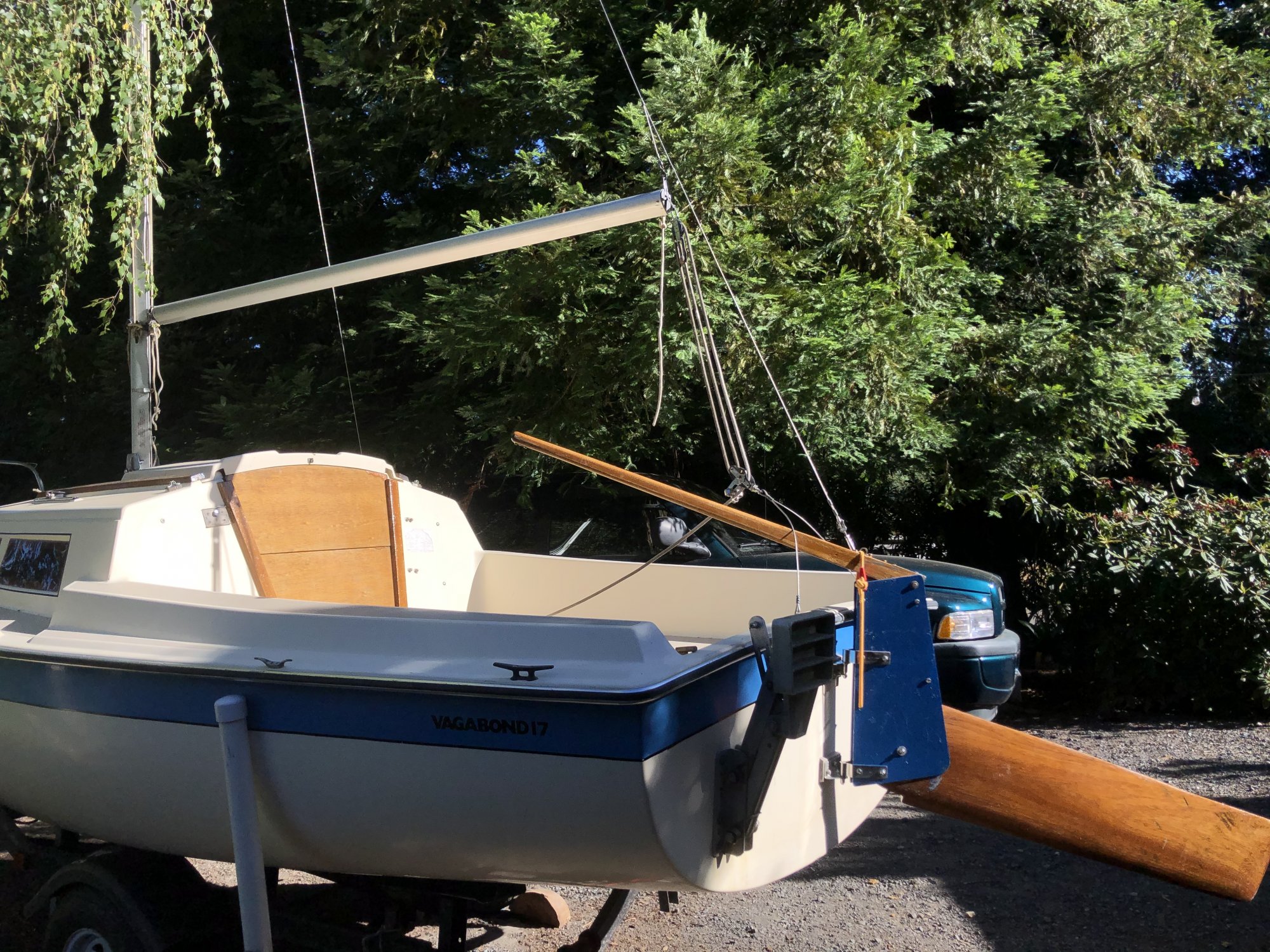

What is the displacement weight of boat and where sailed? Photo of transom would help but concur from the standpoint as a former dealer a 20 inch shaft which we can verify with a transom photo

I attached a photo of the transom. When attached to the motor mount and the motor lowered into the water would a 15 inch shaft work or would the motor and steering be compromised because it is to far down once once in the water. I’m thinking a 4 horse motor. Mostly sailing on lakes and reservoirs. Occasionally Tomales Bay (salt water) in Sonoma County, Ca.

With the type of motor mount you have (one that lowers ) you might get by with a 15" . The outboard wont affect your rudder unless your prop . Often you need to turn both your outboard and rudder .
