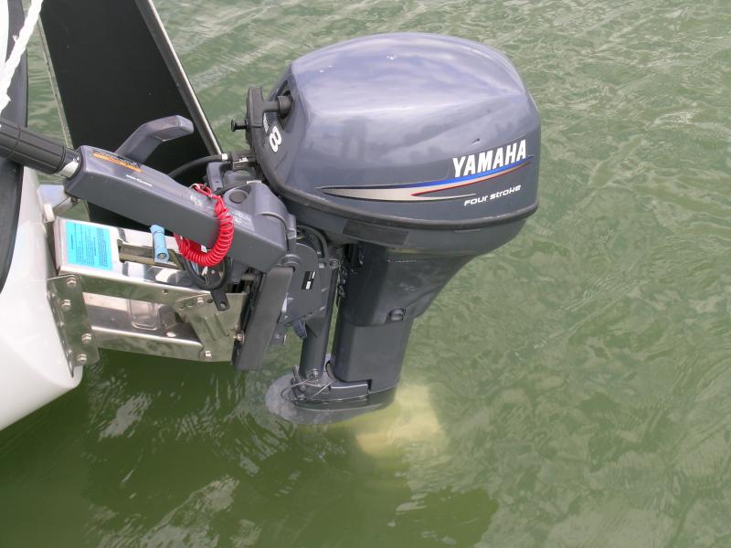

Here's a picture of mine, but I'm not sure who makes it. It works great though.
JerryA
I think that is the Panther one, Stainless & good for 4 stroke motors. I just ordered this one, as the Garelick had issues with mounting...
