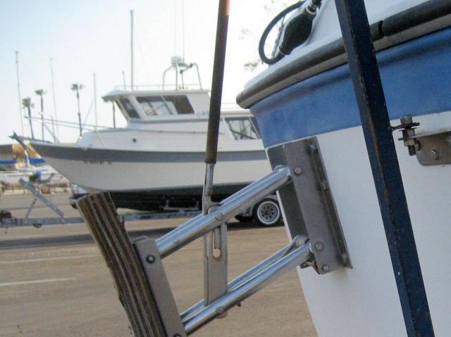

Here is a mod that the PO made to the mount. The rod is connected to the release lever and extends up about 2'. It is covered with a soft rubber hose for gripping. To raise the motor I only had to pull forward and lift. It worked pretty well for getting it most of the way up without having to bend over. As the motor approached the top I would grab the motor handle and finish the lift.
I have a feeling that something could also be done with the right gas shocks.
